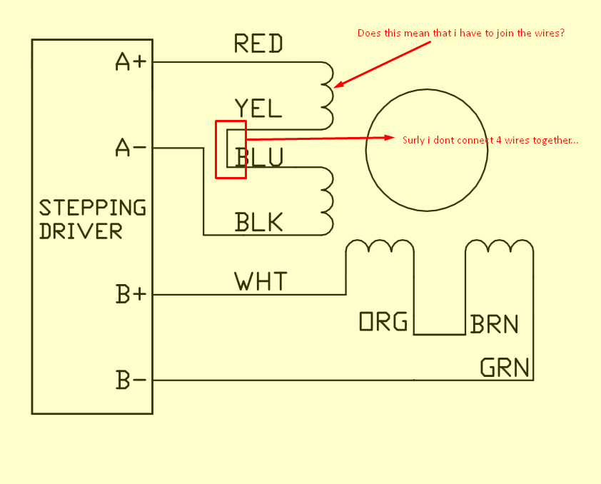

    I normally have a good friend of mine building my control boxes so ive never had the chance to see how its done. my question is to you good guys how the hell do i wire these things up, or more importantly can you explain the diagram for me?
    Could someone please explain the attached image please so i can try crack this once and for all ..
    Driver : PM452
    Motor : Plantry gearbox with CNC4you - 60BYGH301B
    Please guys before you sit back in your chair and snigger about my question please consider we were all here at one point - maybe some of us more clued up than others

    Hey d-man, those curly bits are the windings of the stepper motor. So from your pic you would join the YEL and BLU together and the ORG and BRN. Then run the remaining 4 to your stepper driver.
    I'm sure someone who has a clue what they are talking about will be along shortly with better info so best you wait for them!
    Jim

    however my current setup runs 4 pins and this one will work out as 6, or are you saying that the joined wires dont go to anything which would result in 4 pins :)
    Are you sure you want to use that way to connect the motor ? that's a series connection, most would recommend the parallel connection.
    A+ Red
    A- Black
    B+ White
    B- Green
    Yellow & Blue, connected together but going nowhere, just insulate once joined.
    Orange & Brown, connected together but going nowhere, just insulate once joined.
    Well it was just to try get my head around it Eddie, then i looked at the parallel connection and started to smell smoke (From my brain!) Parallel connection here http://prntscr.com/4wyek3
    Cheers for that Eddie appreciate it

    Parallel connections
    A+ Red & Blue joined together
    A- Yellow & Black joined together
    B+ White & Brown joined together
    B- Orange & Green joined together
    Edit: Ha ha you just beat me to it but you got B- wrong (typing too fast likely)

    Ok so, going for the parallel connection am i right in saying...
    A+ - Red/Blue
    A- - Yellow/Black
    B+ - White/Brown
    B- - Orange/Brown
