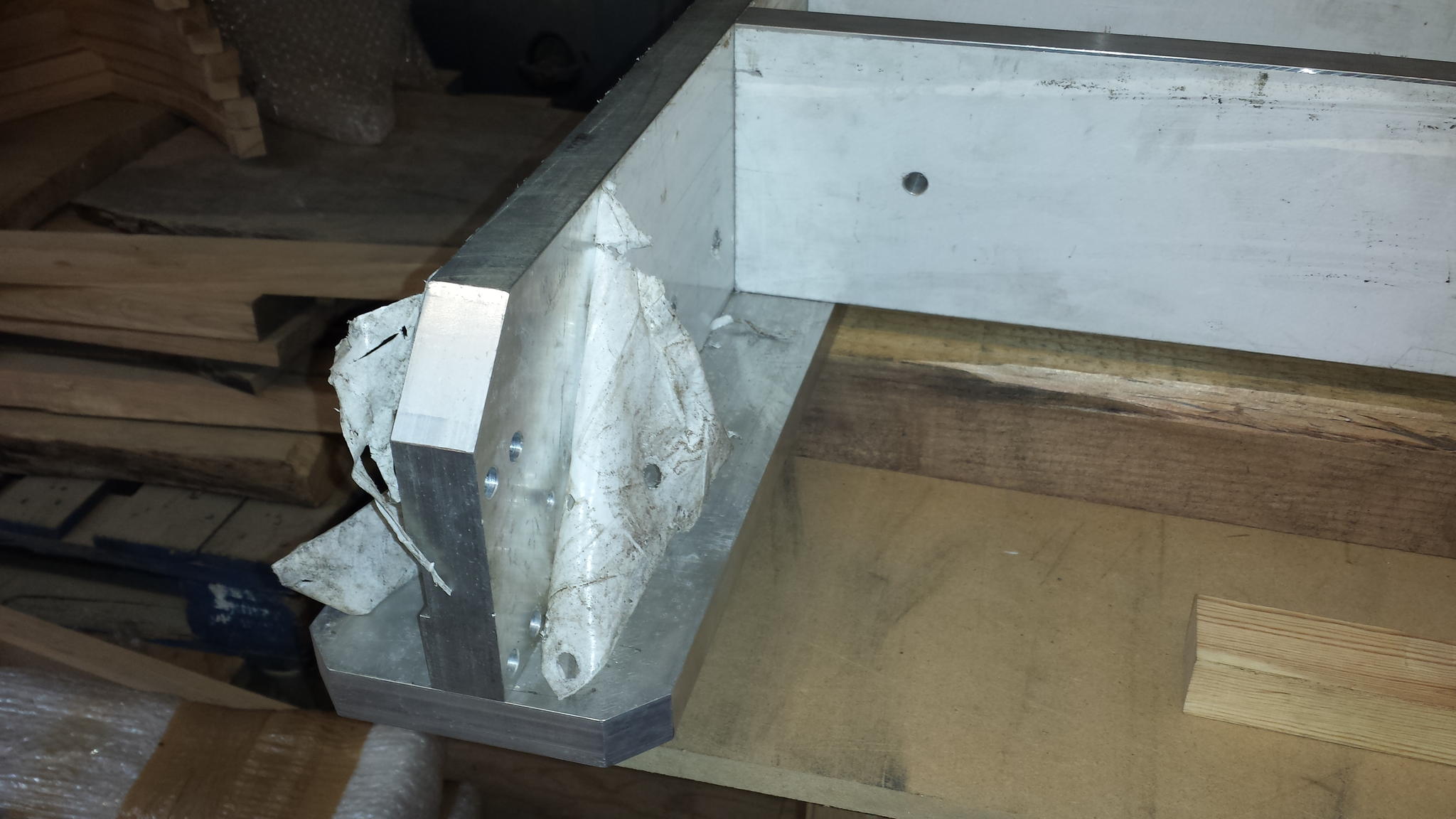

    Not much detail yet, I am still waiting for the original drawings so I know what the partially finished parts are for and what machining is still needed...but collected a few bits last week.... probably 350kg of them...
    A pallet full of parts, some machined, some partially machined and some waterjetted.... the visible ballscrews are x axis and 32mm!!!

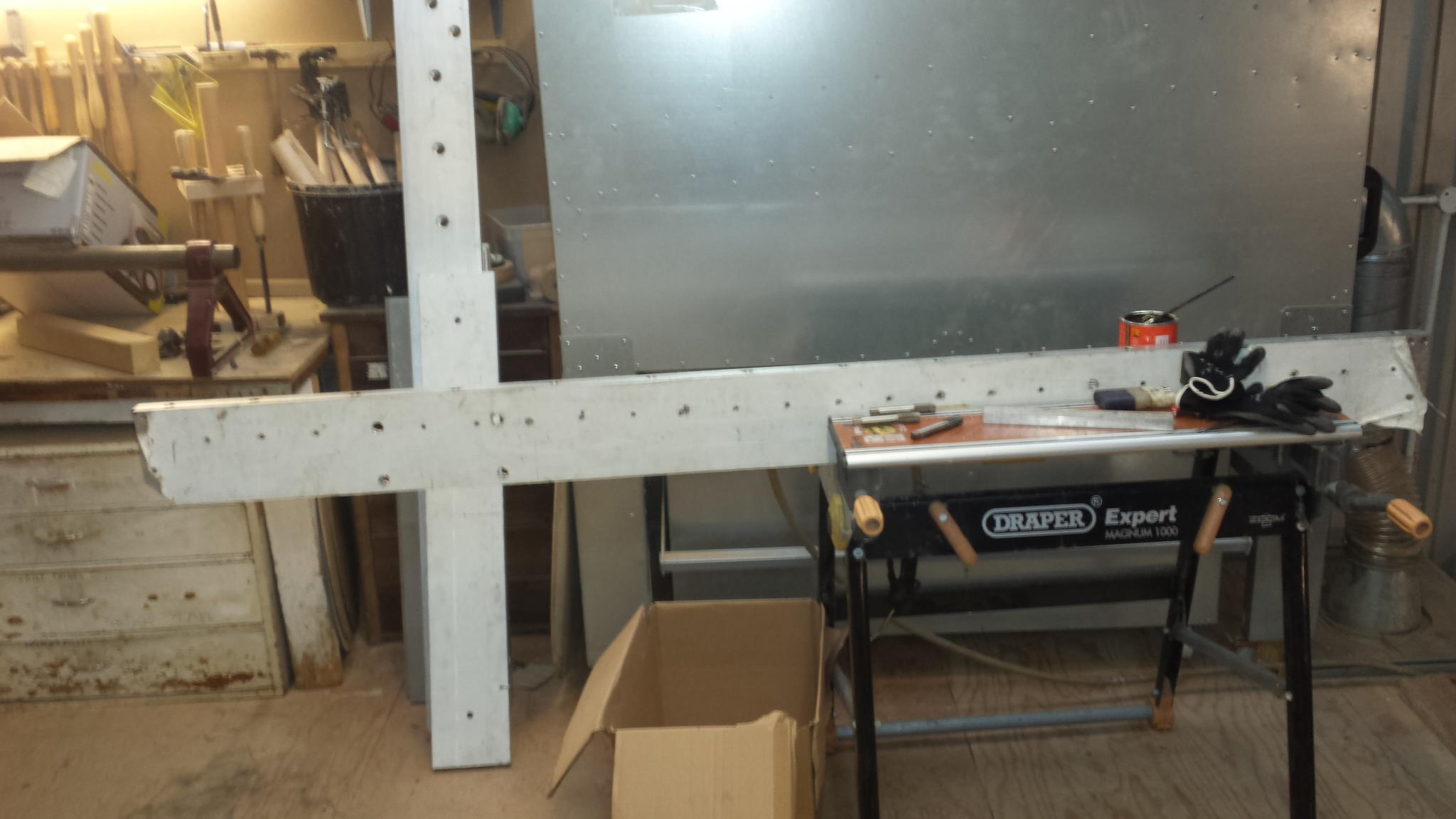

    30mm hiwin x rails, 20mm for y &Z
    most of the frame is 30mm aluminium... gantry is extrusion, sixes to follow

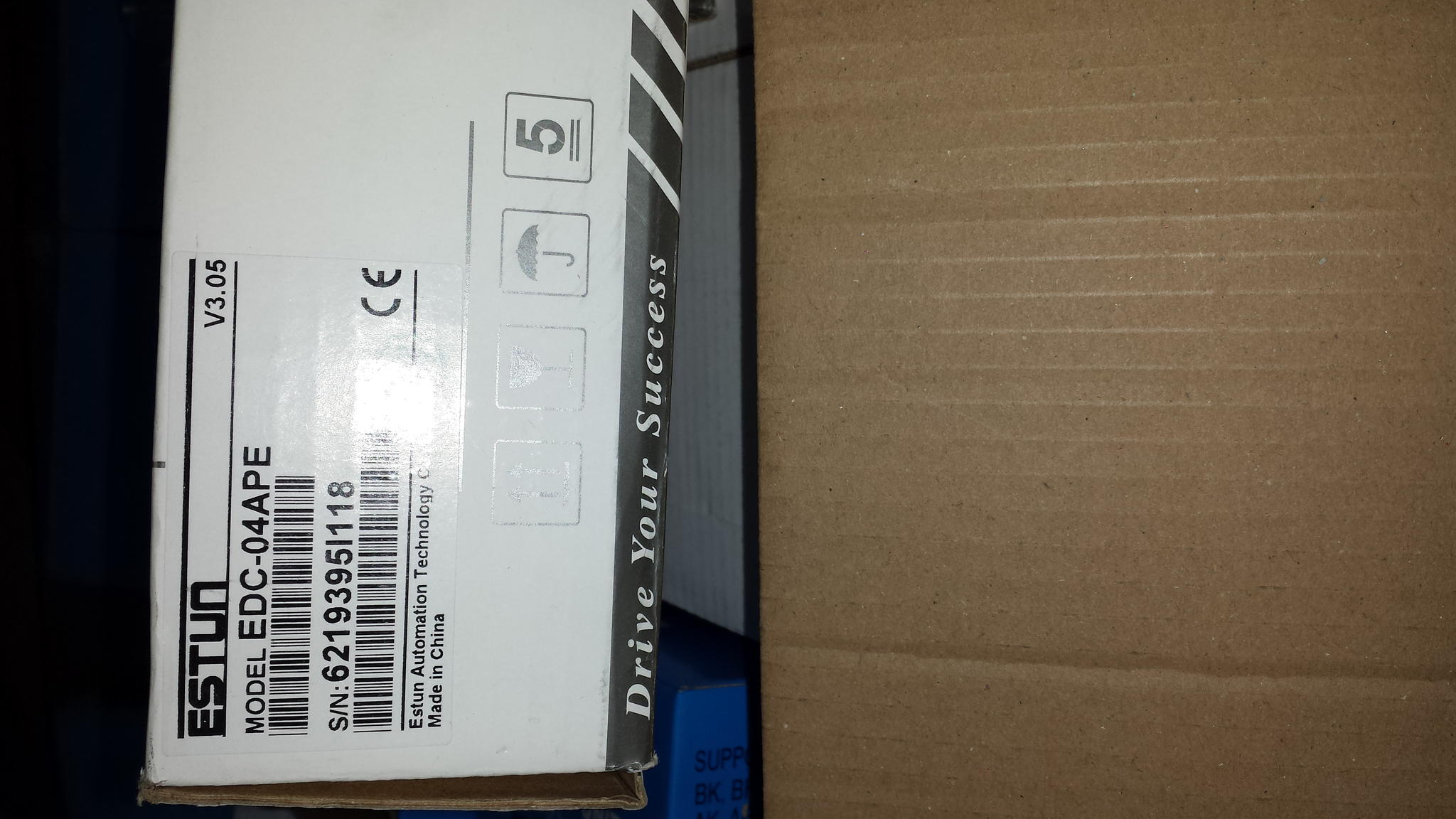

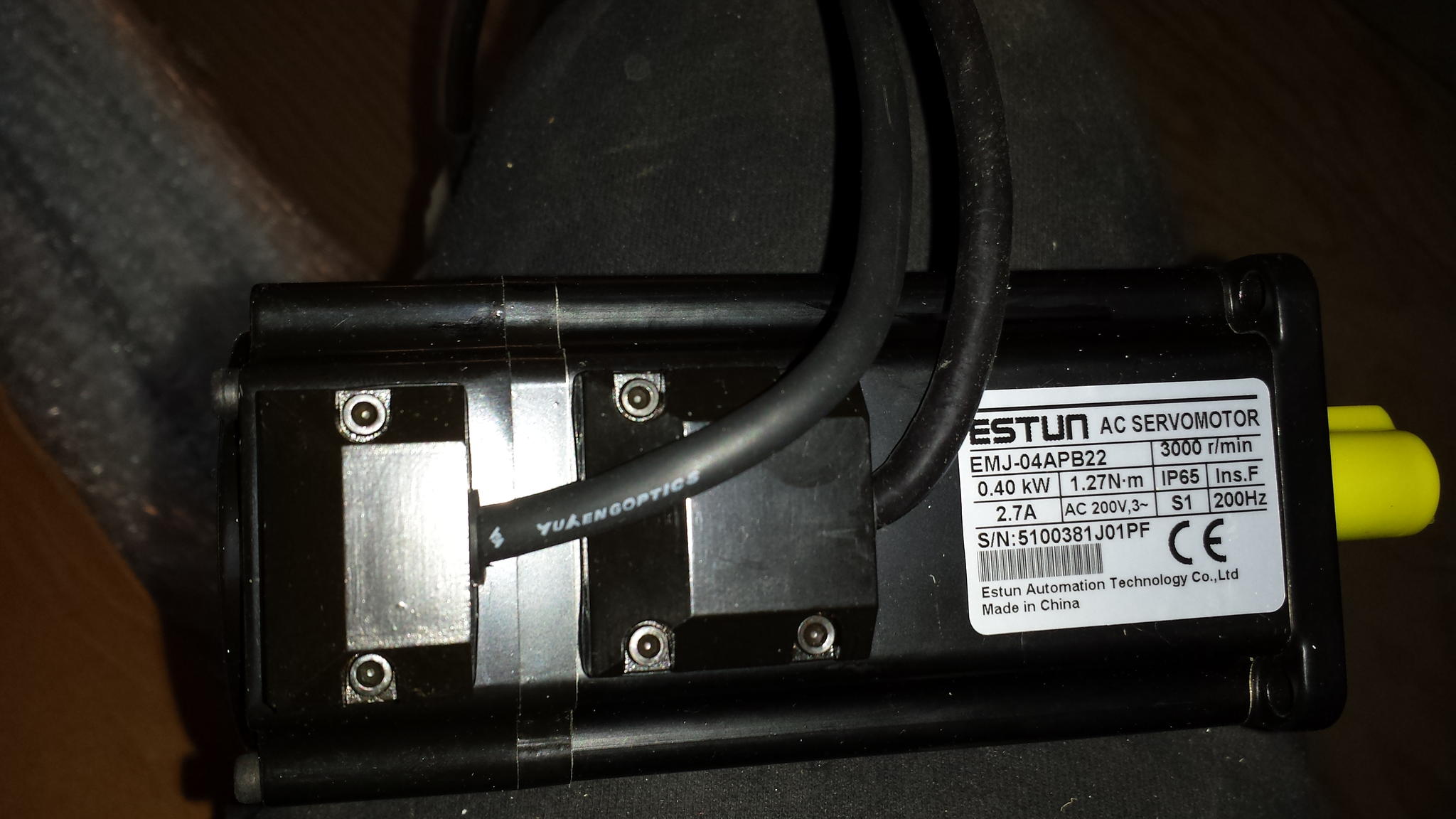

    everything except the BOB in the electrics... servos and controlers etc...

    I think it is about 2 by 1.5m "externally "

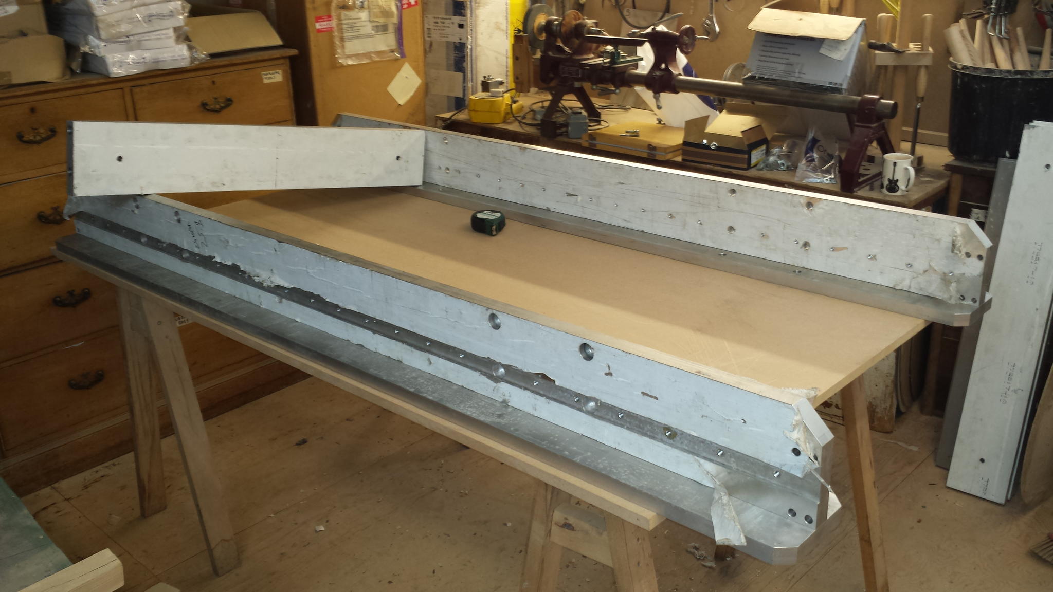

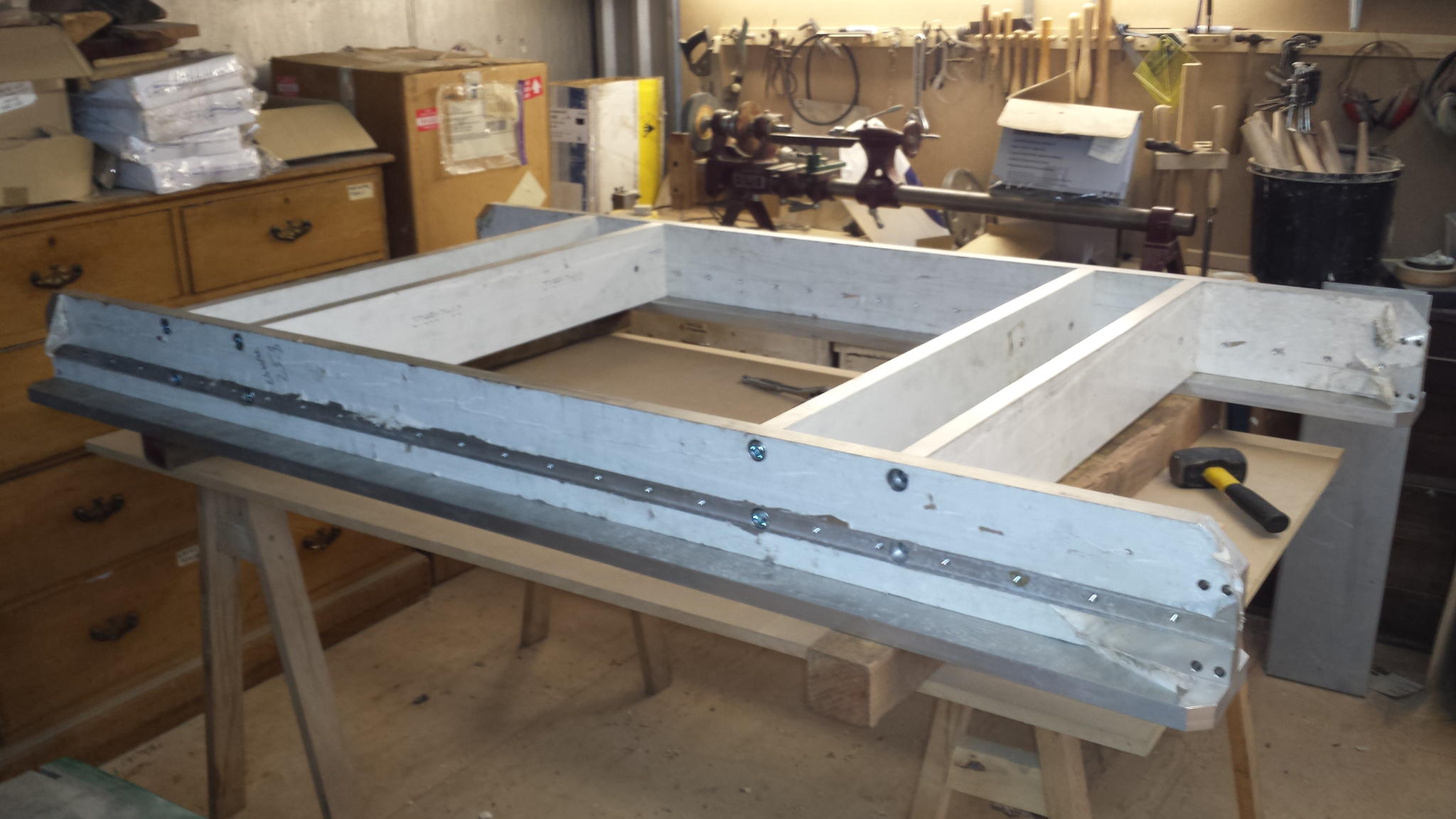

    Got a little bit done this week, finding it helping with my rehabilitation as I need to use both hands for most of it
    28 m16x50 holes tapped, 48 m8 tapped holes for the rails, all by hand as the company that did the original machining "forgot"... thanks for that
    test assembly... I now know the approximate size is 2m x 1.1m between rails, and first problem... one of the cross rails is drilled about 2mm out, still thinking on how to best fix that, any suggestions gratefully recieved
    nice chunky assembly, 160x30mm plate
