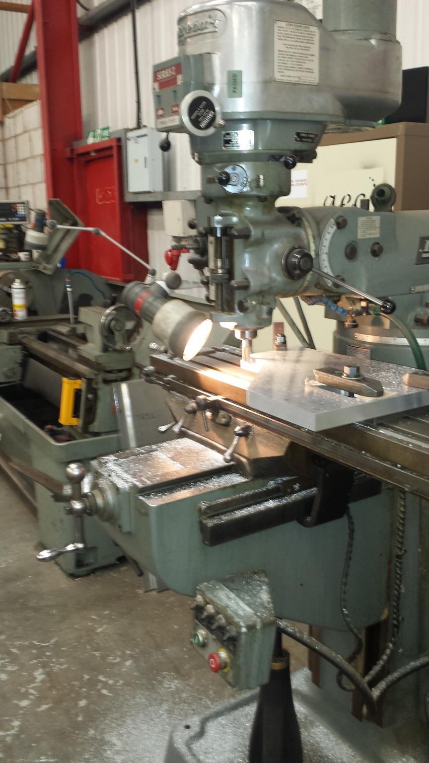

    got some machining done this week, been a while since I ran a milling machine, but thanks to a friendly engineer, a bit of a refresher and use of a rather nice Bridgeport (no wear or backlash, probably the nicest BP I have ever used), Cant believe they let me loose on it really
    just got to blend the curves and finish a few of the non machined surfaces then drill, counterbore and tap about a hundred holes.... so only a day or so marking out
