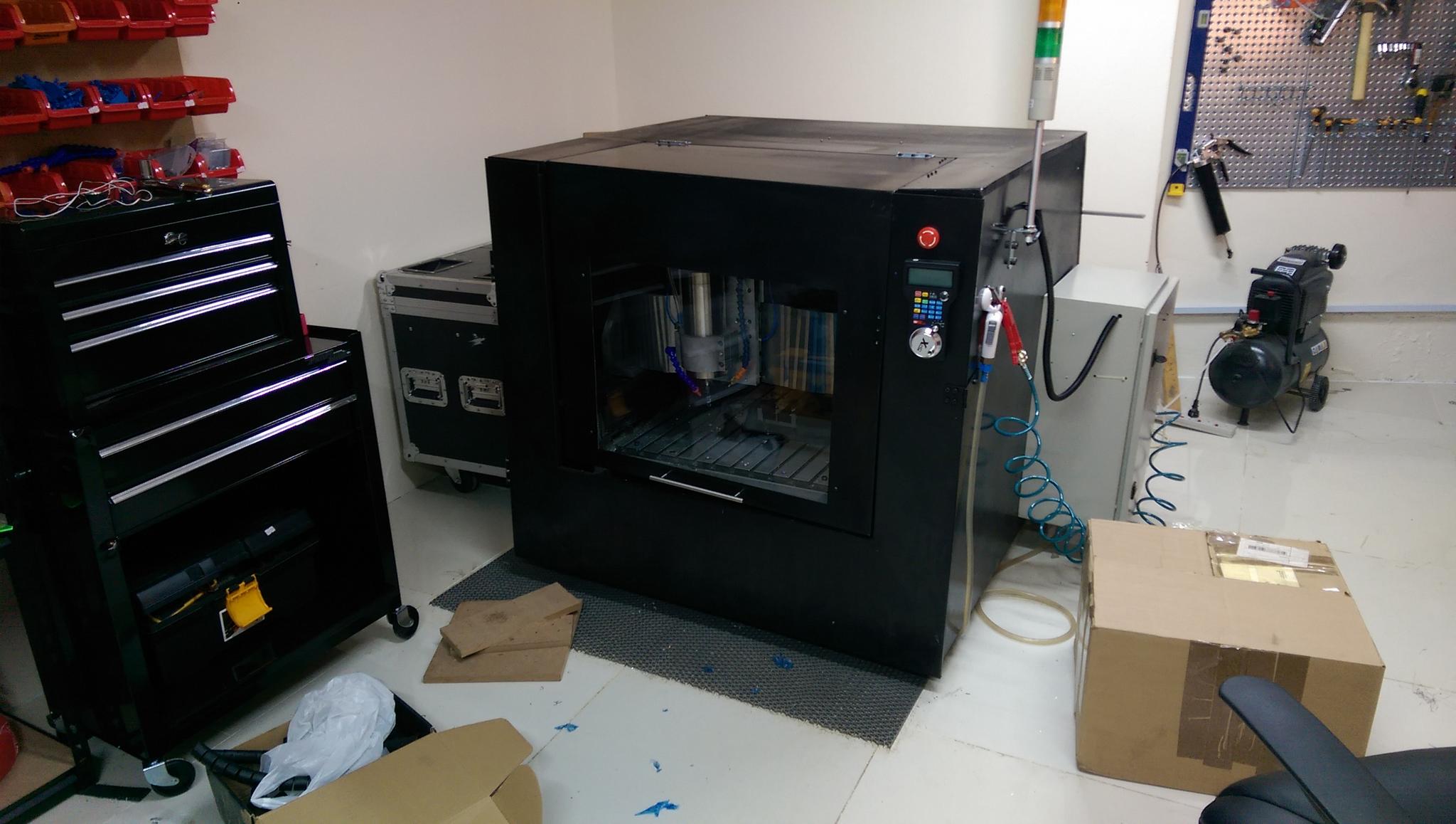

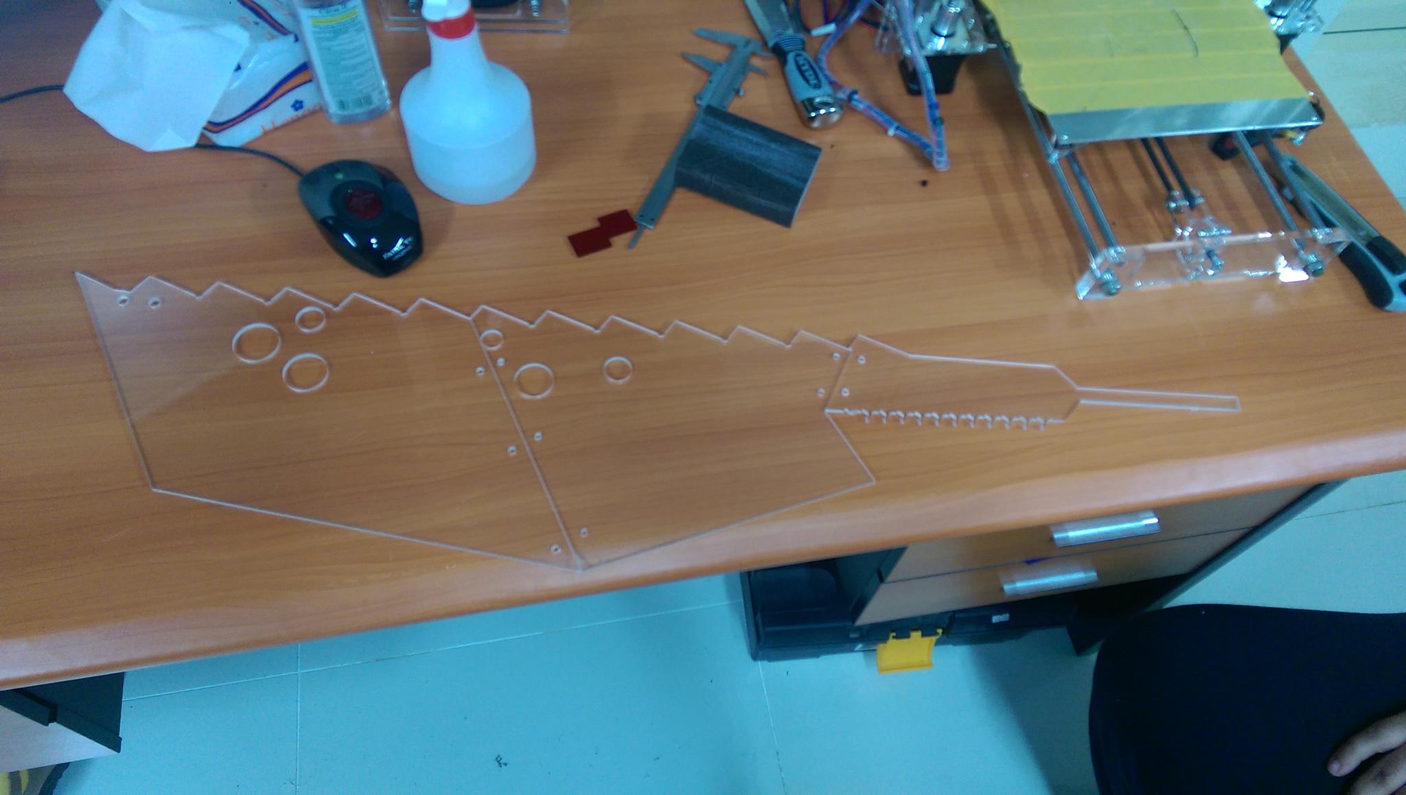

    Hi all, some updates, most of my free time these past months I spent on cosmetics, reassembling, cable management etc and putting the enclosure since I moved to a new room which is dedicated for this machine.
    here is a photo of the machine and some acrylic cuts which were the first actual project which I made for a friend of mine.

    All in all I'm satisfied and feel fortunate to have learned what I needed to accomplish this, but I wish if I could go back in time and design a better machine with automatic tool changing. wish I had formal education in mechanical engineering and machining so I could achieve better accuracy in the design,machining parts and assembly. but alas I guess that could be a future project.

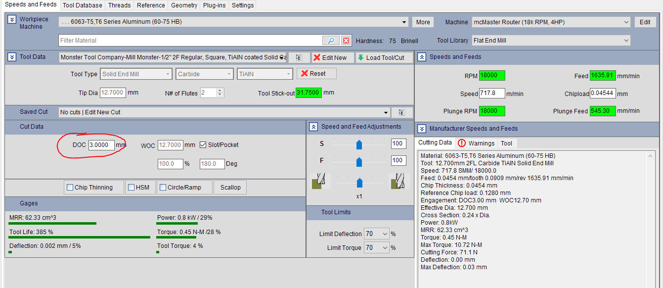

    What about that. Or second, if you don't feel like digging 9mm into aluminum but just 3mm

    PS. With a strong cooling i mean

    wow that looks aggresive, never imagined I would attempt it at this high RPM! thanks I will give it a shot with the flood coolant

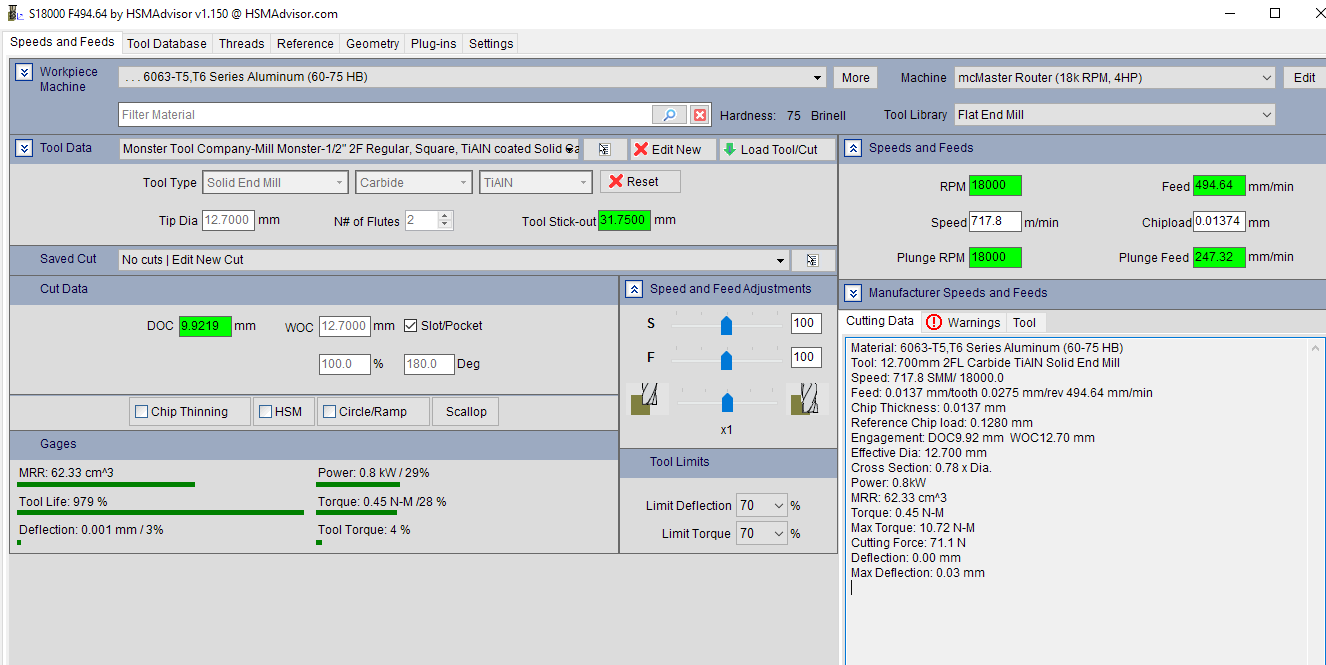

    last year I bought this indexable cutter http://www.rdgtools.co.uk/cgi-bin/ss...2309&NOLOGIN=1
    and just tried it and its giving a much better finish, downloaded HSMAdvisor trial and for this cutter its giving me low RPM for HSS and very high for Carbide, any idea how to identify if the triangle insert is Carbide or not, all it says its Tin coated, not sure what the other abbreviations are

    Those are carbide inserts. Replaceable inserts like those come in different grades of carbide and with different geometry (tip radius, for example) but they are all carbide. Never seen an HSS insert, although someone somewhere probably makes them.

    They are carbide inserts right, but i think they should not be treated like a normal carbide cutter. Instead an indexable mill tool should be found in the database and edited correctly.
