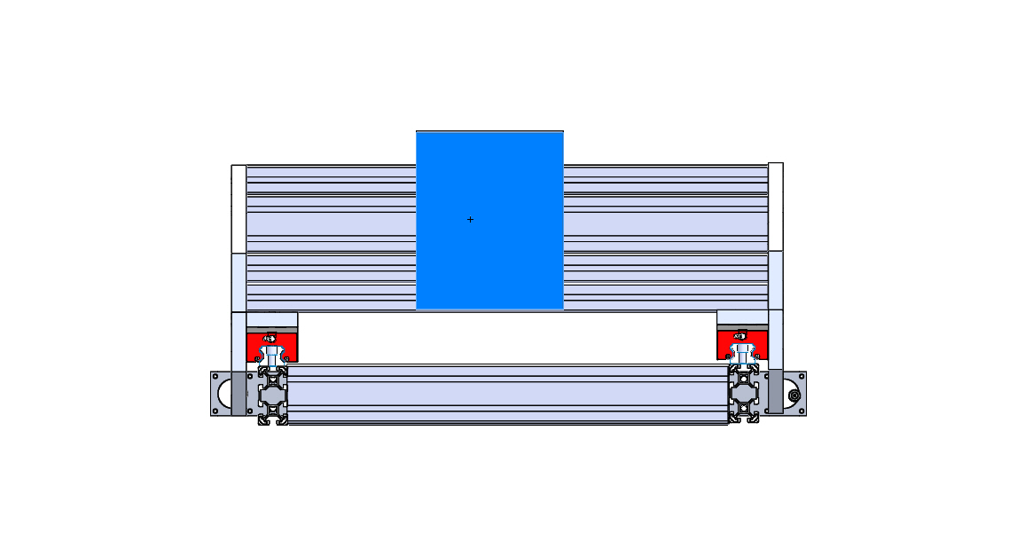

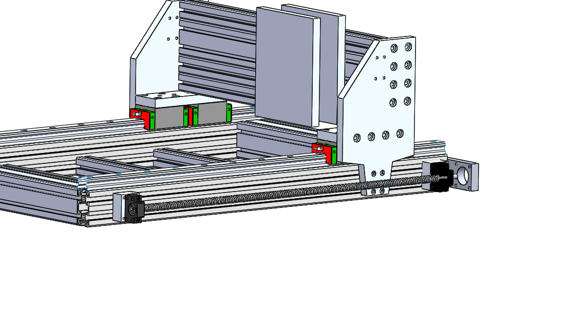

    I bought a straight edge and set one rail straight. Then put the carriage block on the beatings and set it square with a dti mounted on the straight rail. Then set the carriage plate square on the other rails carriages. Then put my gantry bottom plate on setting it square with both carriage plates by putting the end plates on as they fastened to both the carriage plate and gantry bottom plate ends, checked with engineers squares. Then drilled and loosely fastened the other rail at one end and sliding the gantry down the rail I marked, drilled and tapped as I went down so using the gantry to align the rails....

    Another question gentlmen, when I mount my motors, how do I determine the best tension on the belts? both my gantry and Z will be belt driven and I have already used a calculator site to determine the belt length ( and bought it ) based on the distance between the points. but then what actual distance would I screw the motor at?
    thanks!
    Update:
    had issue with my Z motor turned out the cable had some issue so I just cut one side and directly connected it to the driver instead of the 4-pin plugs setup, works fine now.
    assembled everything and tested and so far satisfied, still I got a long way to get it right:
    things need to be done:
    -Spindle speed control via mach3 : had issue before of speed being off, probably needed adjustment of the voltage or something.
    -limit switches : using software limit only at the moment
    -checking alignment/parallel via DTI : to be honest I have no training on using this properly and feel like my machine doesn't have room to adjust correctly, however I can live with a little bit of error for now, as long as the thing works!
    -making triangular support legs with leveling: something I missed was to make the frame have adjustable height on each corner, now am thinking of just mounting extra 4 pieces on each corner of the frame and have those lift the whole thing up and balance accordingly
    -Drag chain attached to frame : again my stupid and impulsive attitude prevented me from designing a side where drag chain can sit so I have to think about manually drilling and just attaching a flat panel so it can sit on it, no big deal I guess for now.
    -Double check tension of belts : again no formal training so no idea how to do it properly but by feel I think I got it decent tension
    -Connect water cooling to spindle
    -Cable management of Z axis
    -Actually cut something : will probably try wood(MDF) first, then maybe try my luck with other material and ultimately aluminium, anyone wanna recommend speeds and feeds for me?
    -and many more I'm sure, hope I get some positive feedback from you guys in order to make it better!
    A quick photo of the machine:
    Video of axis movement , before mounting spindle( at time of this post it is still uploading but give me 20mins or so plz hehe)
    am sure u guys might have some comments, particularly on sound of long axis movement, had lots of issues with it being flexing/bending if I tighten the gantry too much or so, the ballscrew ends might need shimming but not sure how to approach it yet.
