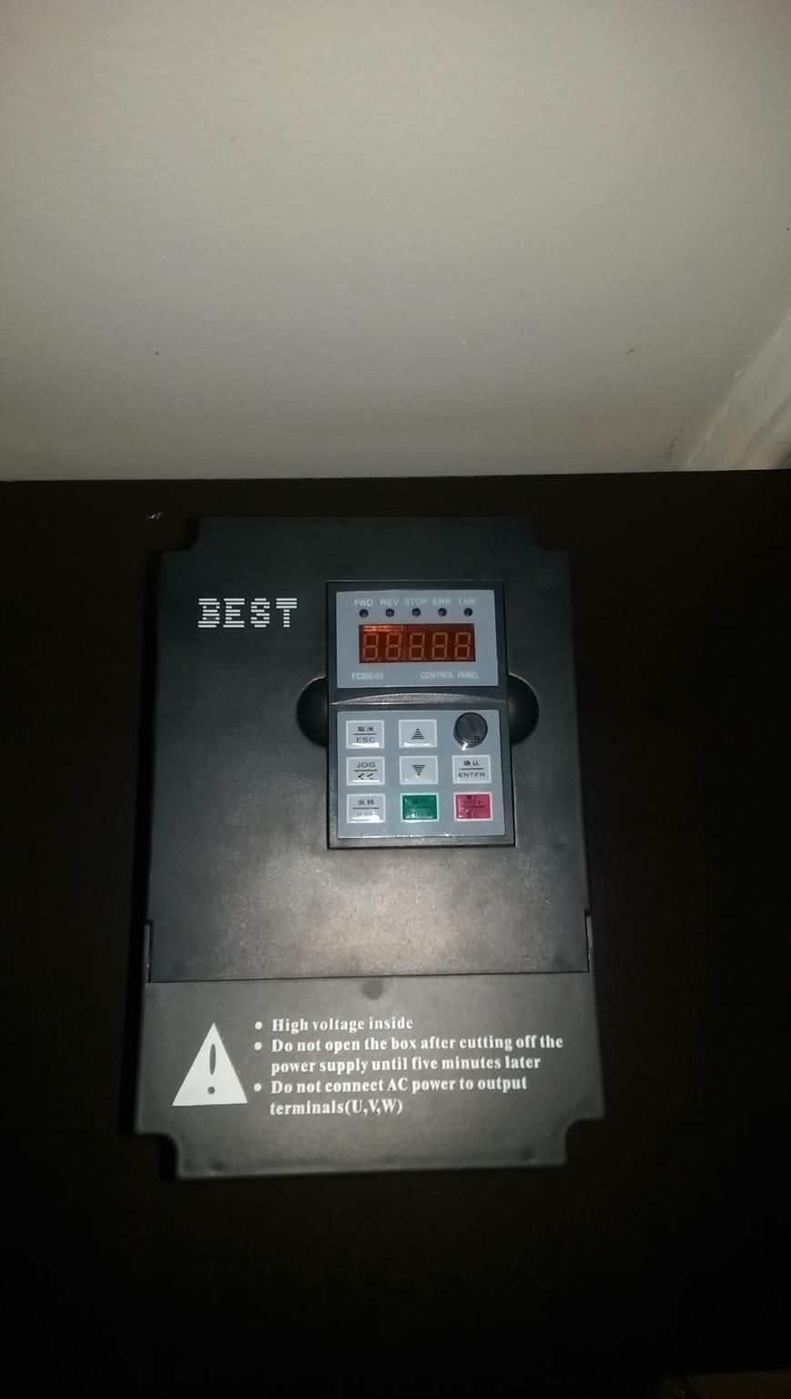

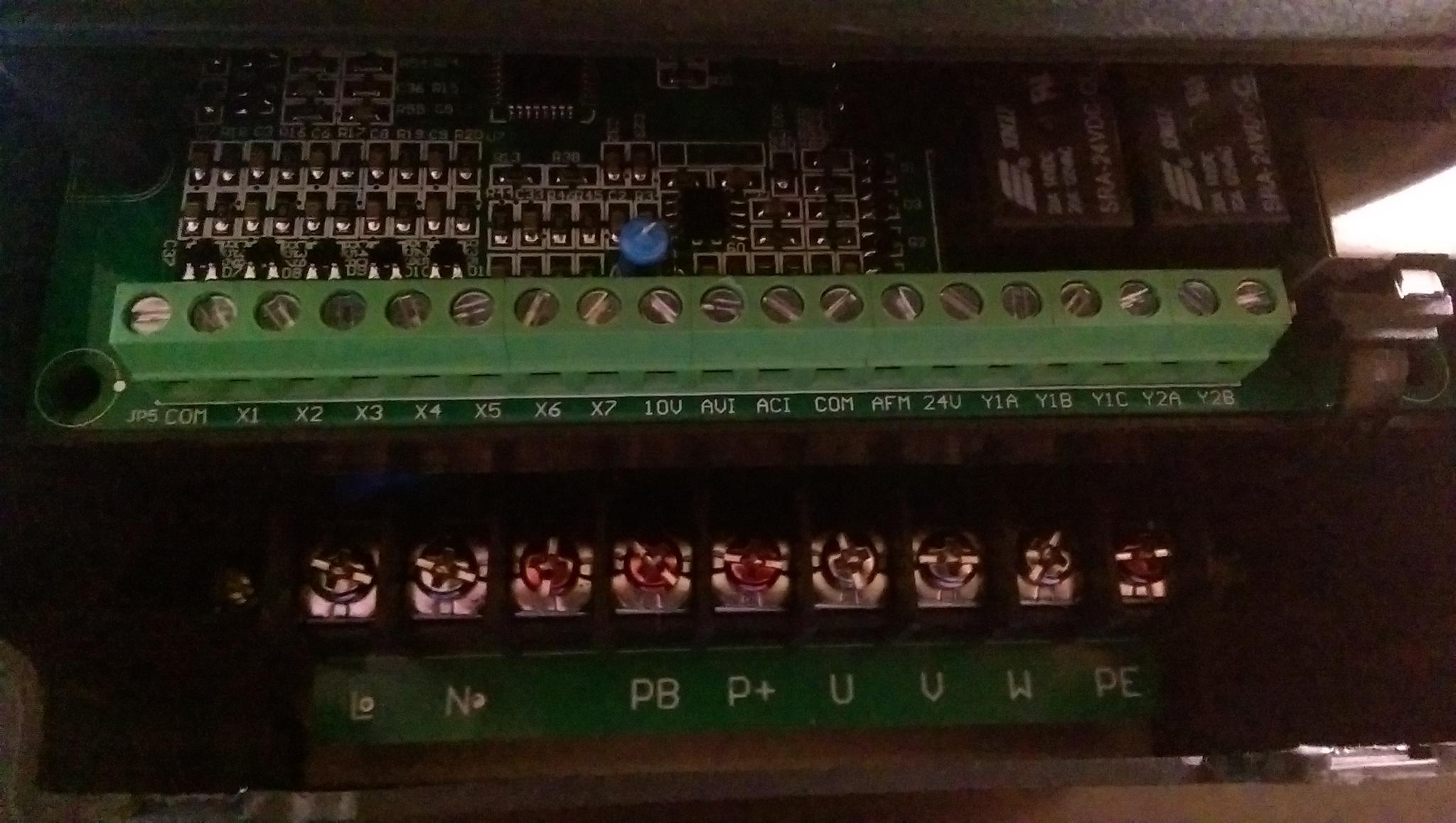

    on a different topic I got my VFD (spindle still in the way) and would appreciate if you could confirm wiring:
    this is a FC300-2.2KW
    So L and N are input obviously, PE is ground, PB P+ are braking resistor connection.
    first do I connect PE to both spindle and input ground or just input ground? I'm assuming spindle comes with 4 inputs so 3 of them would be the U V W and last one is earth, is that correct?
    second, I have this board called C6 http://www.cnc4pc.com/Store/osc/prod...products_id=58 which is supposed to control the speed and on and off/dir from the software(mach3) once I connect it to my BOB.
    would you be kind to confirm the connections between the board and the VFD? the only one I figured is analog output to AVI.
    the board has separate ground for the analog and digital, should they be both connected to the COM inputs in the VFD? and there are two COMs which is confusing me further.

    Quote Originally Posted by Noplace View Post
    I'll be using the C6 with C35 from same site, I checked with their support and they confirmed that they work together so I assume it would work and mach3 could output the required frequency(step) signal, did I miss something? please enlighten me :D
    Yes they will work fine. The difference is that with a Step based spindle control you use or lose an Axis output. With PWM then you don't.
    Read the manuals how to connect them:
    http://cnc4pc.com/Tech_Docs/C6R6%20and%20Huanyang.pdf
    This NOT a Huanyang Vfd.!! The setup is similar but the connection terminals are different names and it's not wise to presume just because they are similair labeled they actual do the same as Huanyang or any other Vfd.
    Also looking at the table for VFD you provided the Analog and Digital input Logic (which is 24V not 5v) share the Same ground so maybe can't use this board.? Check with a meter to be sure but normally Analog as it's own isolated common.!
    Edit: Also the Spindle 99.9% probably won't have a Ground wire. It may have 4 connections but one won't be used. Again use meter to find one that isn't which is often pin4 (look close they will have numbers)
    Regards using the PE: Then take the cable shielding at the VFd end back to PE connection. Leave spindle end shield unconnected.
    Some people use the 4th connection in spindle to Ground the spindle but I find it's not required if machine frame is grounded.

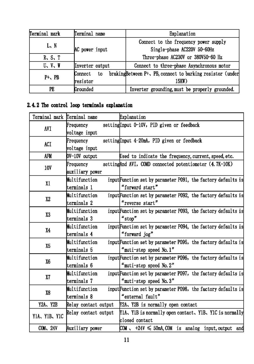

    Here is the full manual for the VFD:
    https://drive.google.com/open?id=0B8...UlV&authuser=0
    if anyone has time I would appreciate you checking it.
    from what I understand:
    there are function pins (X1-X8) that can be programmed for multiple functions but default is shown in the diagram showing:
    X1 - forwrad start
    X2 - reverse start
    X3 - stop
    so if I can get the right way to hook into these I think it will work.
    but also in the manual it states we have to change some default settings to allow controlling start/stop and frequency from outside.
    but what I don't understand in general is the need for relays, maybe someone with electronics experience can explain it, isn't it possible to just hook the pins coming from BOB to the inverter input ? unless the relays give a higher voltage?
    I understand how relays work (a bit lol) but was wondering how they are functioning in the C6 ( are they outputting 12v being controlled by 5v) ?
    anyways thanks for reading and hope someone is bored enough to open the manual and read through! haha

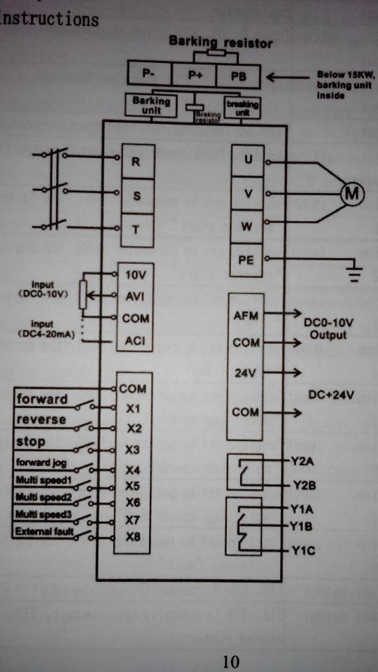

  9. #68
    Ok well the need for a relay is to act as the switch.
    The vfd will provide 24V source which you take to which ever input you want to use. The relay acts as a switch and keeps the digital input using the same potential as the source.
    If you use an external voltage it won't be at the same potential.!!!!! . . . . Hey what the hell is the Potential he's asking him self.?
    Basicly it's ground and all it means is the digital input needs to use the same ground as the source voltage. (Or often other way around and Digital input provides 24V which returns to Com ground)
    Either way there must be a path back to ground for the cicuit to be made.
    Relays: Well from your statement then I don't think you do fully understand how a relay works.? A relay is just a electro mechanical switch and doesn't output any voltage.
    The coils of the relay are controlled by voltage you or the device controling the relay apply. The Contacts of the relay are the switches which open or close depending on type. NC or NO.
    In the case of the C6 board the Coils are controlled thru the BOB using "M" commands in g-code. The contacts you just use to make or break a circuit.
    IE: M3 would turn on the relay coils closing the NO contact which you run the wire from 24V source on VFD thru one side of contact and back out the other to Digital input on VFD.

  11. #70
    Vendor sent me this to assist also, seems the frequency control is DC so not sure if I can use my board :(
