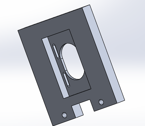

    The best and stiffest way to achieve height is to have the L shaped gantry sitting on the carriages and raise the frame up on legs. If you have an adjustable bed then you can cut deep items but for 90% of cutting have the bed as near the cutter as possible to keep cutter flex to a minimum. What will you be mostly cutting?
    Neil...
    Build log...here

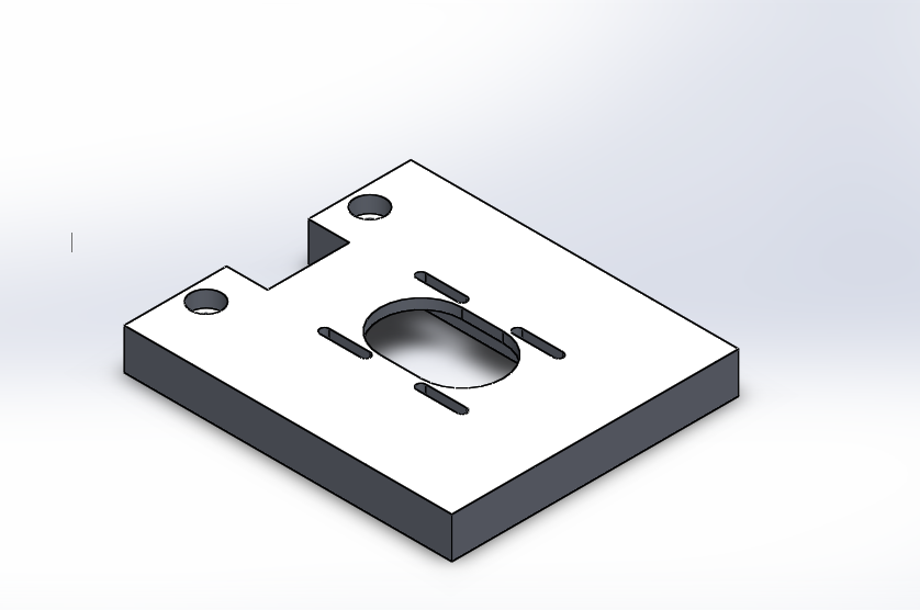

    hey guys I could use your help on designing the Z axis to complete the machine, I have made it 200x240mm but I don't know if that is the best size given my machine overall design.
    and am thinking of mounting the hiwin blocks on the stationary part and the rails on the second plate which will move up and down, should the second plate and the rails be also 240mm ?
    last thing i need help with (for now lol) is what HIWIN rail and block size should I use for my x axis ( gantry left and right ) and z axis? HGR the heavy duty ones or will EGR be good enough?
    thanks !
