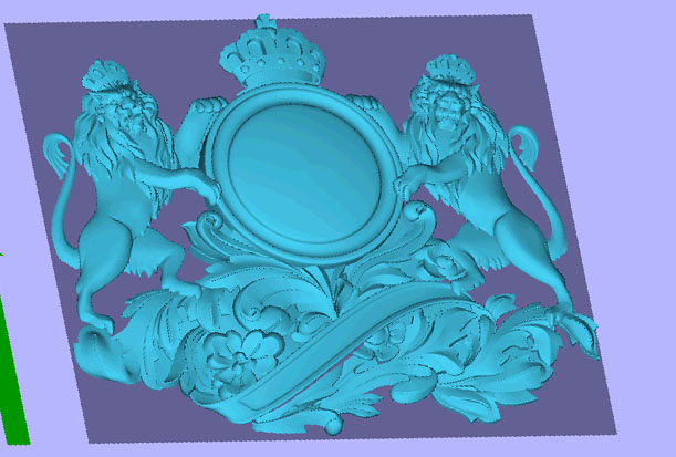

    I would like to start making my own bas relief also how would I go about adding text to the banner on this relief??
    It's not a trivial task, have a search about for 'height maps' as well.
    This member is a master at it; http://www.mycncuk.com/threads/5972-...hlight=chekhov
    Some info here; http://www.cambam.info/doc/plus/tuto...Heightmaps.htm
    good free software: http://www.scorchworks.com/Dmap2gcode/dmap2gcode.html
    I think I'm going to buy Artcam express But it has some downsides.
    I watch a video tutorial and noted that text/font can't be cut on a z-axis without having a flat base. I'm hoping I can buy a add on/bolt on to accommodate this function.
    Rhino is to expensive for me I only have £100.00 to spend on my required program

    This any use ? it's free; http://www.scorchworks.com/Gcoderipper/gcoderipper.html
    Thank you eddy
    I will give it a go.
    I found rhino 5 for students £188.00 and as my son is at school I will save up a bit more and buy rhino 5
