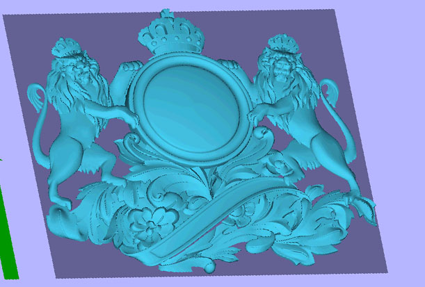

    I have bought a stl file to cut on my home made cnc spindle cutter with cut3d now

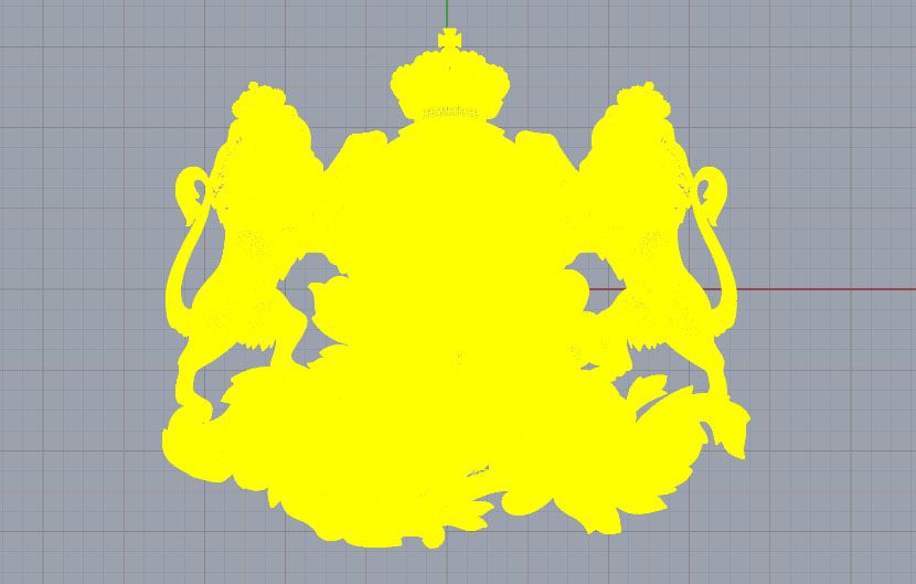

    when I import the stl file into Rhino I can only see the out line with no detail that is visible in my cam program (cut3d).

    here is the screen shots of what I can see in my cam program
    This is what I can see in Rhino 5

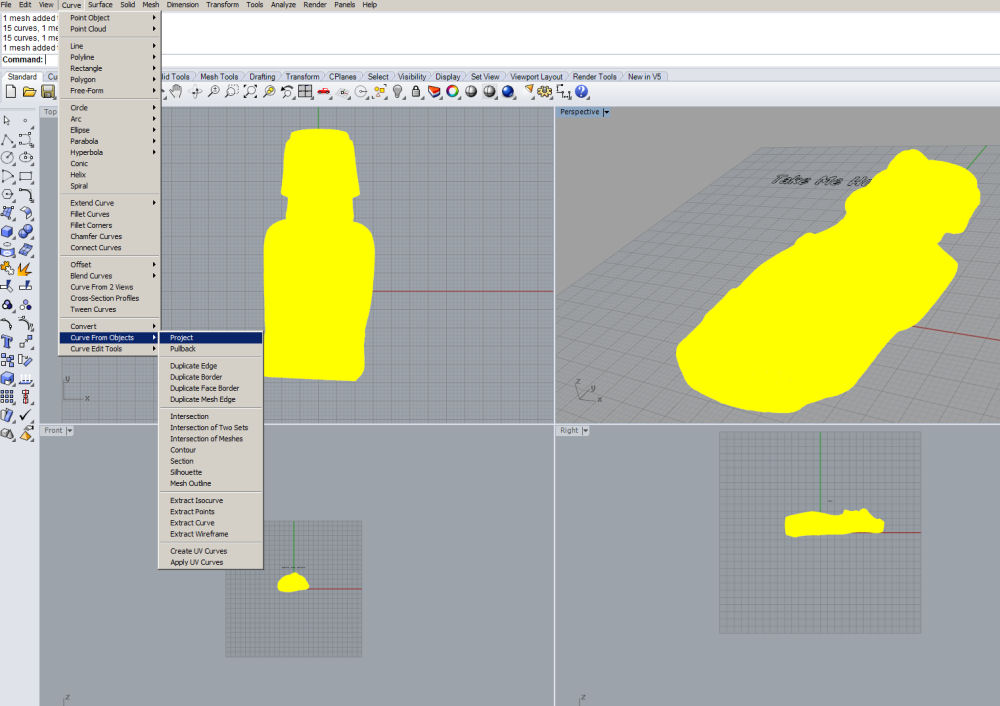

    First of all are you sure the Vectric software you have cannot do this ?
    When you get it loaded into Rhino it will look like the yellow object you show above.
    Click on empty space in the top right window (perspective) then click on the dropdown arrow beside the word Perspective and click on 'Rendered'
    It should now look like it does in Vectric.

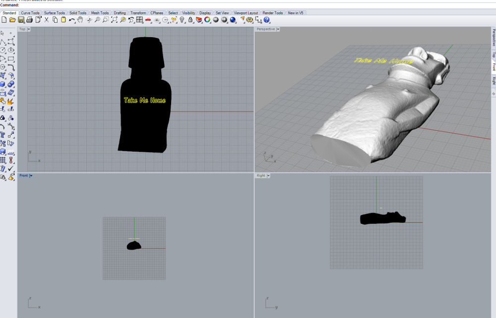

    Using the text tool write some text and posion it so it's above the stl object, make sure it will fit, don't let it overlap into space.
    Now select the stl object so it turns yellow and select 'Project' from the menu;

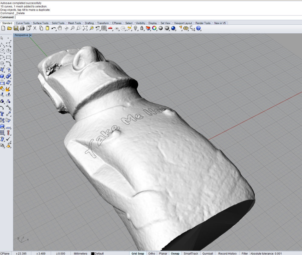

    Now select the text you want to project and press Enter, you should end up like this;
    If not then look on YouTube or the web for instruction on Curve Project
