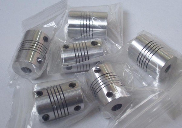

    If you can swap connections around, try changing with another axis to see if the problem is transferred. If it is , it's electrical. If not it is mechanical.
    If Mach is showing it as moving but it's not is the Z axis coupling slipping?

    I will try swapping the connections around and see what happens
    also will look to see if the z axis coupling slipping (not sure where to look for this tho?)

    Quote Originally Posted by Janste View Post
    It connects the Z axis stepper motor to the Z axis ballscrew/leadscrew....looks a bit like this probably...Click image for larger version.

    thanks
    will I find allen type head bolt in the holes that may need tightening
