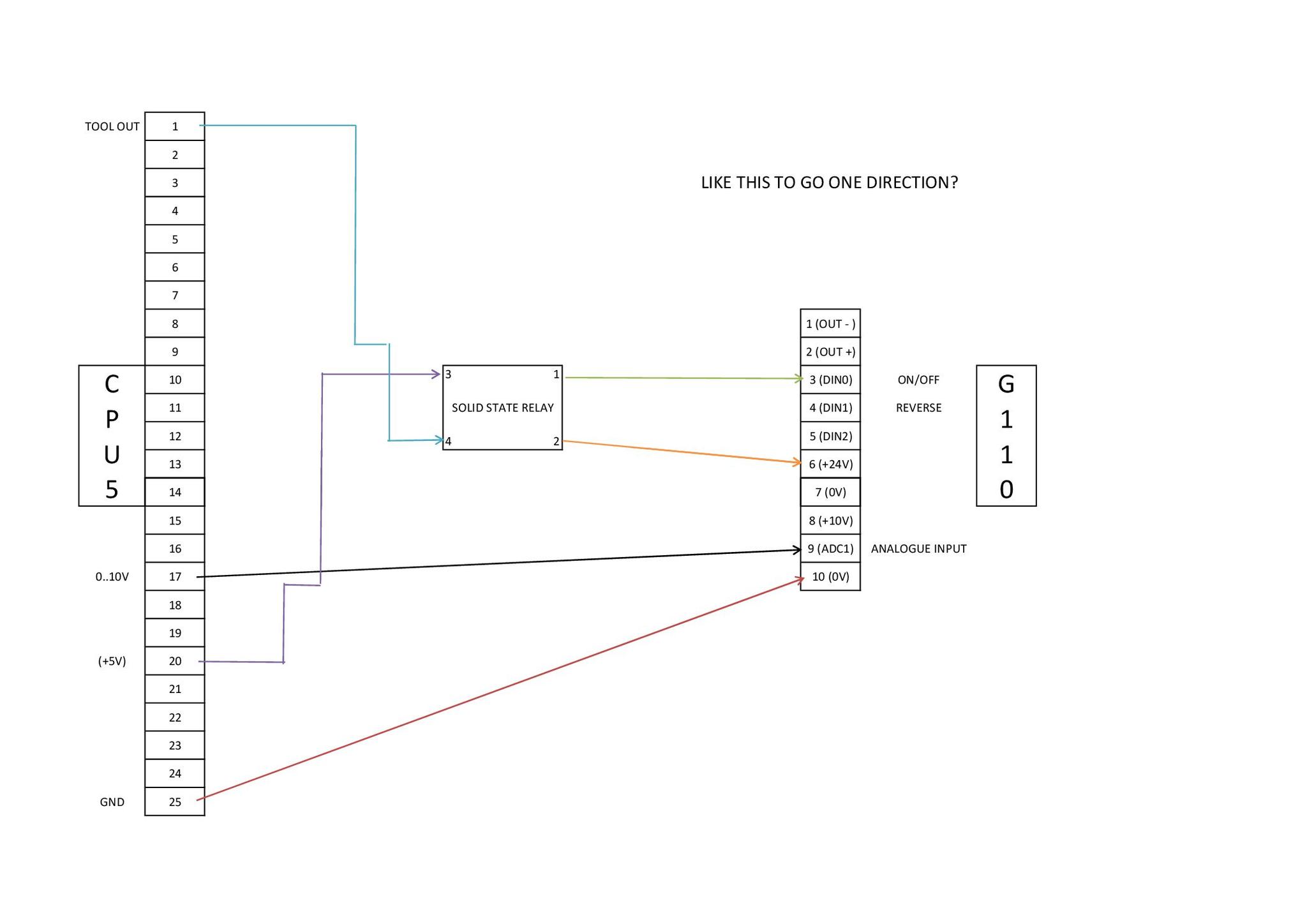

    I think I connect pin 17 on the CPU5A4E to ADC1 on the G110
    Pin 25 on the CPU5A4E to connection 10 (0v) on the G110
    Pin 20-21 (+5v) and Pin 1 on the CPU5A4E to connection 3 (Din0) and 6 (+24v) on the G110
    I was going to use a solid state relay just in case I mess up and send 24volts to the cpu (not good).
    Anyone know if what I am proposing is correct?

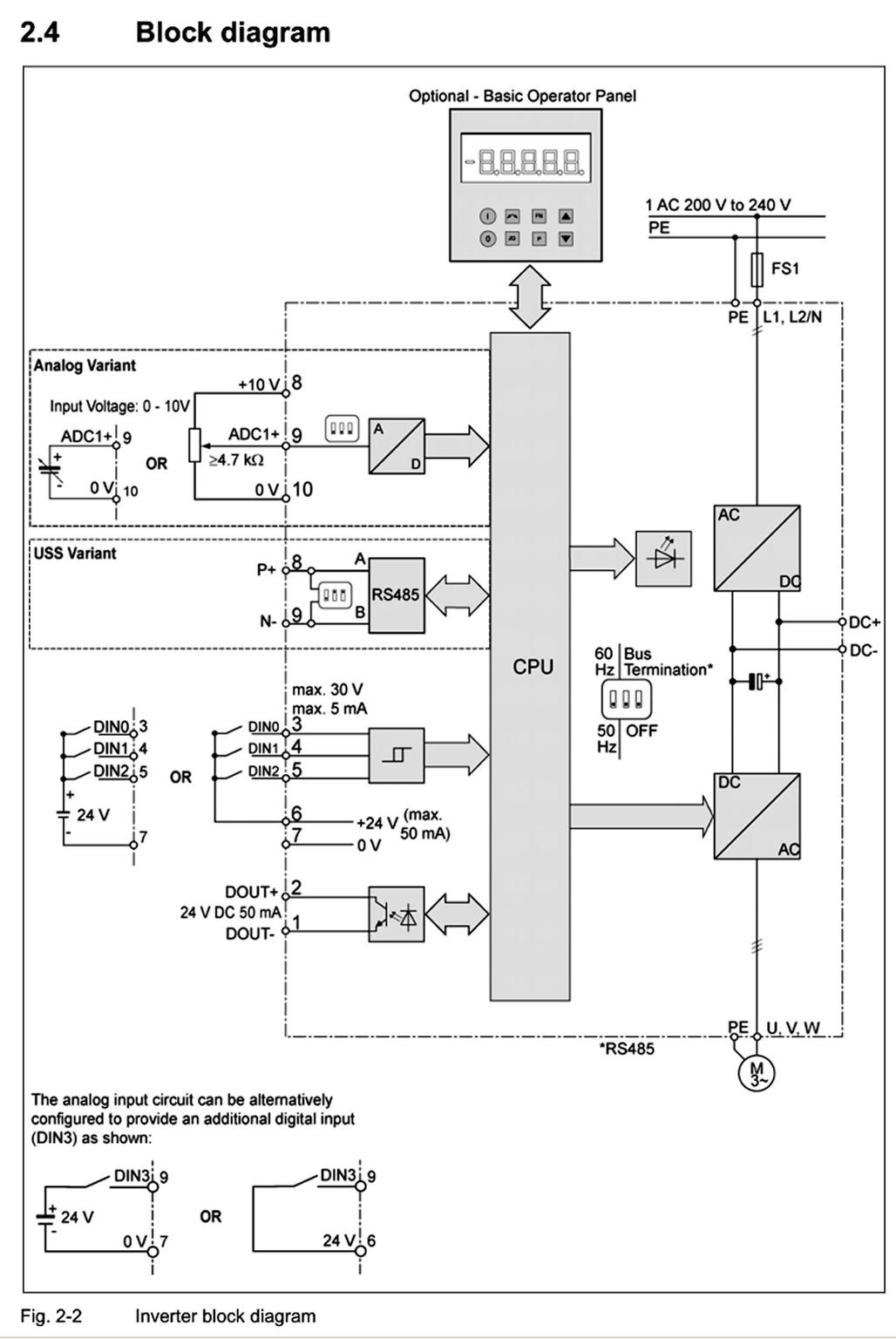

    If you selected pin17 on the CPU to be 0-10v using the jumper, then as you say connect that to vfd pin 9 (ADC1+)
    Connect CPU pin 25 to vfd pin 10 (0V). The only thing to watch here is, have you used the correct GND terminal on the CPU. Sometimes a particular 0V is associated with the 0-10v, output so just check that.
    This is the tricky part now. Normally the inputs to vfd terminals 3,4,5 are supplied by external relays, but I can't see another terminal associated with OUT TOOL terminal 1 of the CPU to act as a pair of relay contacts.
    Without further info about the CPU5A4E I can't advise anything more.
    Here's a picture of the vfd connections.

    You can connect the cpu directly to the vfd. If you go onto Berts Eding cnc website and look at the cpu5a flyer, the link is at the bottom of the page, it shows the possible connections.
    If you are really stuck then email Bert and he will help you out.
    Now I see why you mentioned the solid state relay. Personally I would not be connecting the TOOL output directly to the vfd, I would attach a relay between TOOL and GND on the CPU (looks like you would need an external 24V supply), then I would connect the Normally Open contacts of that relay between vfd terminals 6 and 3 (then the vfd would have to be configured by it's firmware so that the input meant RUN FORWARD.
    The main reason for using a relay, and it's the same with PLC outputs, is that it's easier and cheaper to change a knackered relay than it is to replace a knackered controller or PLC, etc. Volt Free contacts as they are called is the way to go for me. For similar reasons I would not be using the 24V supply from the vfd to drive a relay, it only supplies 50mA max.

    Hi all,
    Sorry for the late reply, been working.
    I have attached the layout that I think I may go with.
    The external 24v supply seems like a good idea.
    I have already added a 5v supply for the cpu5 board.
    Thanks for the help.
