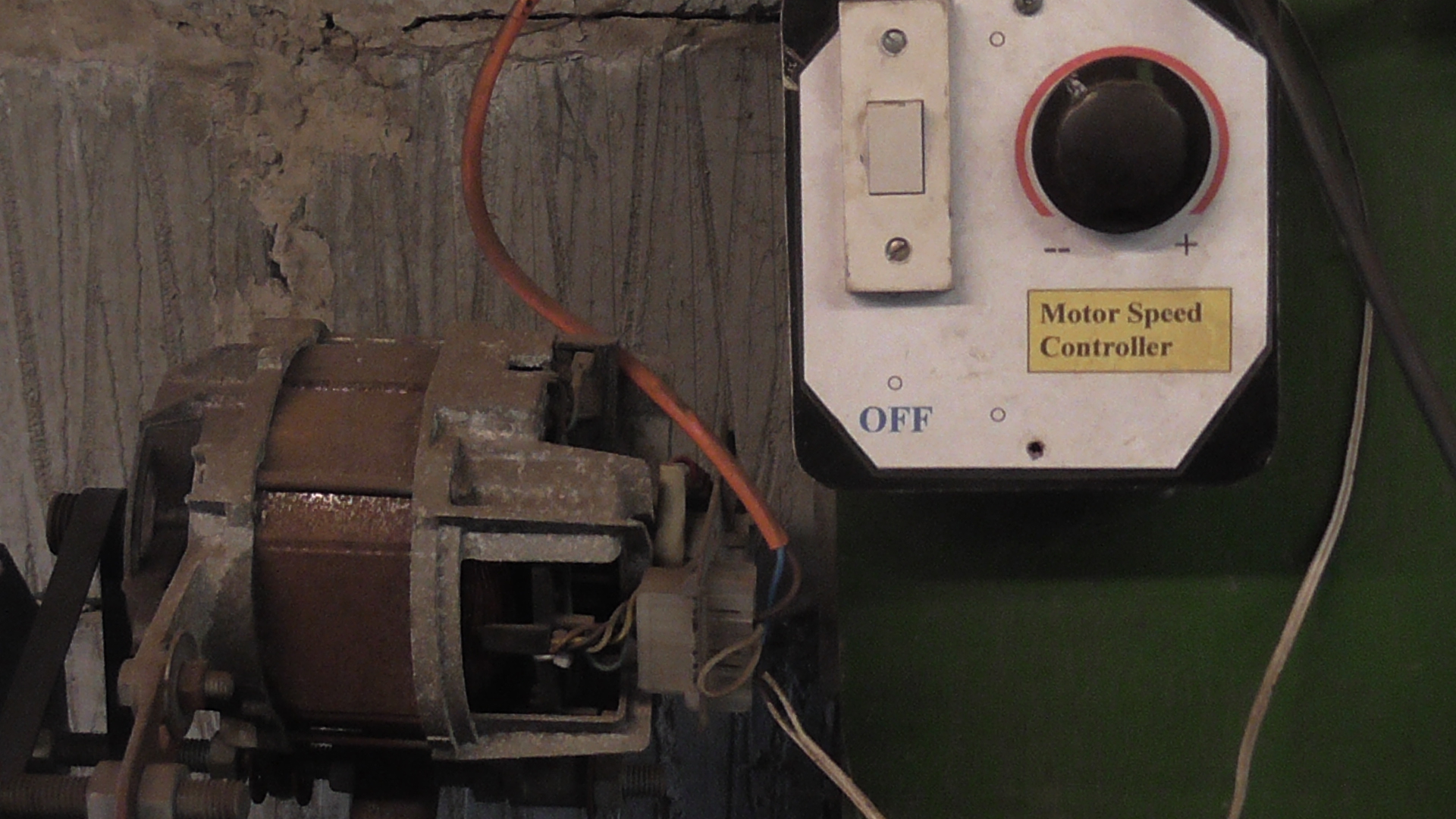

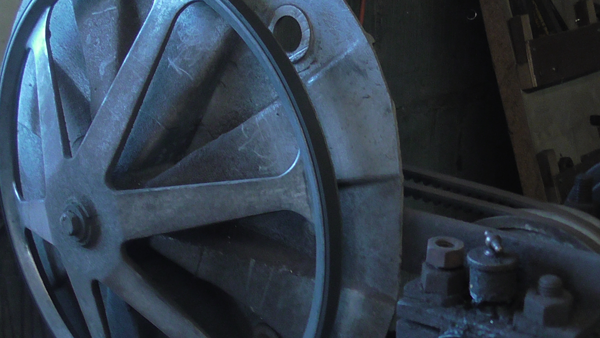

  8. Hi Ross
    i use ex washing machine motors on both my machines. 6 inch chuck lathe and Gingery clone horizontal mill. They have well enough torque and are variable speed. I make the controllers at calenterprises.
    Best Regards KeithClick image for larger version.

    Quote Originally Posted by keith77777 View Post
    Any chance of digital or analogue speed control?
  10. Hi magicniiner
    Yes I have make a model which can use PWM to control the speed. I test it with Zeus but Mach 3/4 is supposed to give out similar pulses. You have to modify the tacho generator on the WM motor because the desgn is made for some of the older motors. I have that instruction in my on line leaflet. On a lathe its best to use the WM pulley for reduction. I had a chap use it on a pillar drill he complained the controller was getting hot but then it transpired he was trying it without reduction gear so the whole thing was under stress. I am an engineer electronics mechanical anything which is needed..
    Cheers Keith
