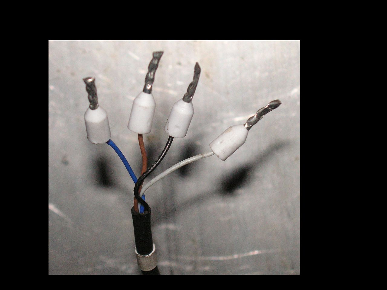

    When you fit them, don't twist the wire first, just strip the right amount and push into the ferrule, it needs to be a good snug fit. If it's slack you've got the wrong size but sometimes you can double the wire over to make it twice the size if you run short.
    With very fine gauge wire, such as is fitted to Proxies and PE devices, I strip and fan out the wires then fold them back over the insulation before inserting into the ferrule and crimping.
    A bit fiddly but does give a good grip of the insulation and uses a ferrule of a more suitable size for screw terminals. I have found that this also works very well with spring terminals.
