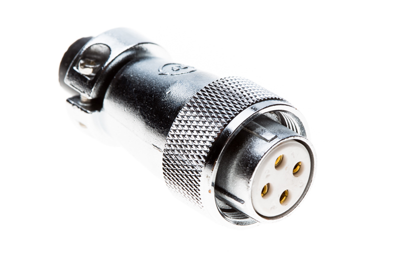

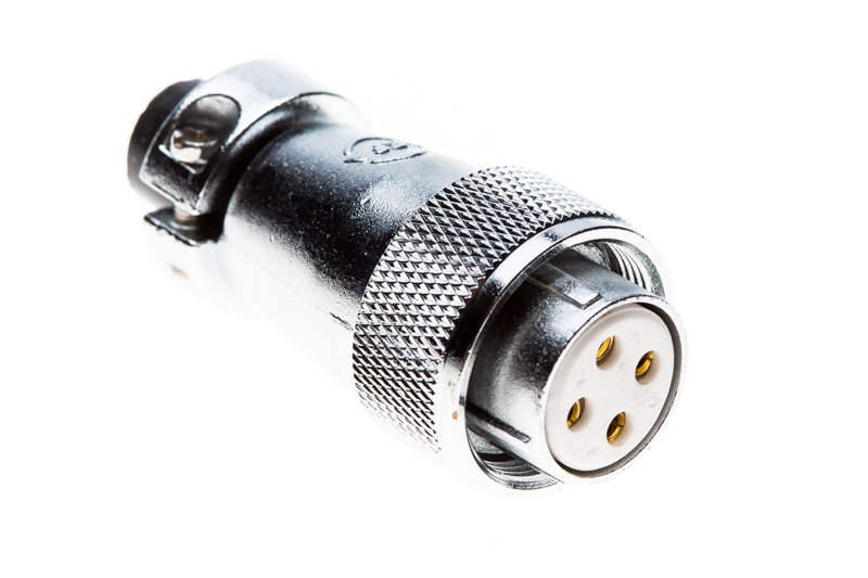

    hi
    has any one got any of these connectors, both male and female ends, or part numbers

    http://www.aliexpress.com/item/Free-...235681730.html
    is this what you are looking for ?

    The one cropwell pointed to looks that part allright, I don't know if this one is the right size; http://www.rocketradio.co.uk/4-pin-m...lug-1138-p.asp
    yes thats the one Cropwell, Thanks
    been looking for weeks.
    the rocket radio one is the part people keep sending me saying its right

    The 4 pin locking socket will fit on a spindle, but the keyways will not engage, so you could put it on the spindle any way you like (that gives you 3 wrong ways) I have a 2.2kw spindle which I tried it on. Anyway the locking ring wouldn't screw on. I would be wary about using the Rocket offering, which are basically audio connectors and only rated up to 60 volts. They seem to be popular for stepper motor connectors though.
