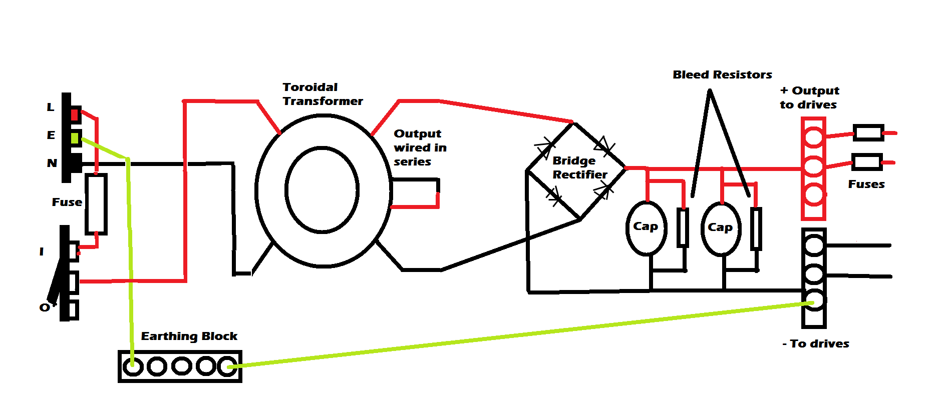

    Thanks Eddy.

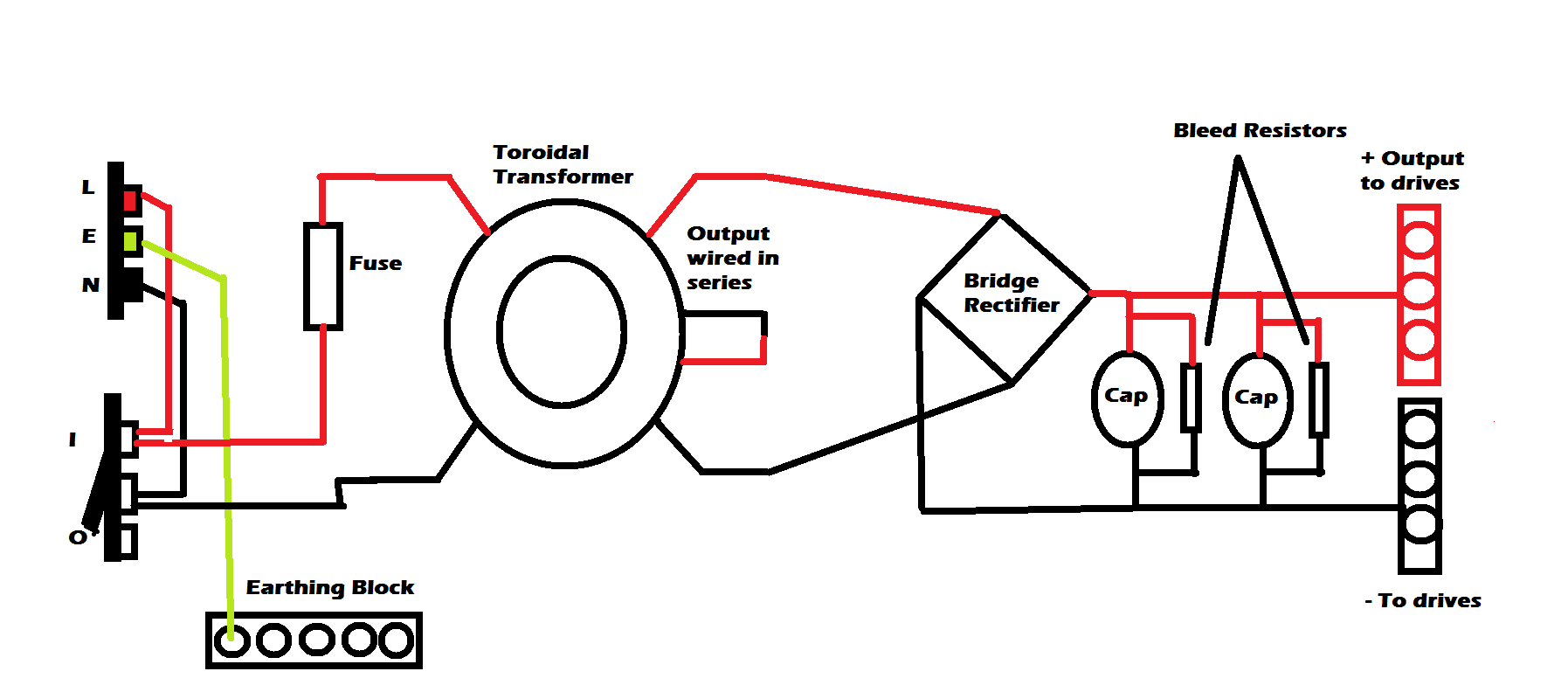

    Hopefully i've added the earthing point in the correct place now?
    I'm going to put a 230v regulator before the transformer, either an AIO or just the chip on a circuit board with some caps, resistors and a heat sink. The reason I am doing this is because my mains electricity fluctuates. I've took 3 readings at different times and got 235V, 241v, and 248v, so much for the 230v switchover!
    With this voltage regulation will I need the drive fuses?
    Without you and this forum I would still be trying to work out maximum step motor voltages.
    Mark

    Quote Originally Posted by smeg up View Post
    Thanks Eddy.
    Like I said you didn't have to put the neutral to earth, some people do it others don't. In some cases where other equipment is connected you might have to put it to earth to get a common reference but in the case of just using stepper drivers it's not vital.
    You probably won't need the regulator.
    Yes, the fuses are to protect the circuit from overload.
    Cheers, Mark
    You are correct, I needed the forum myself when building my machine.
