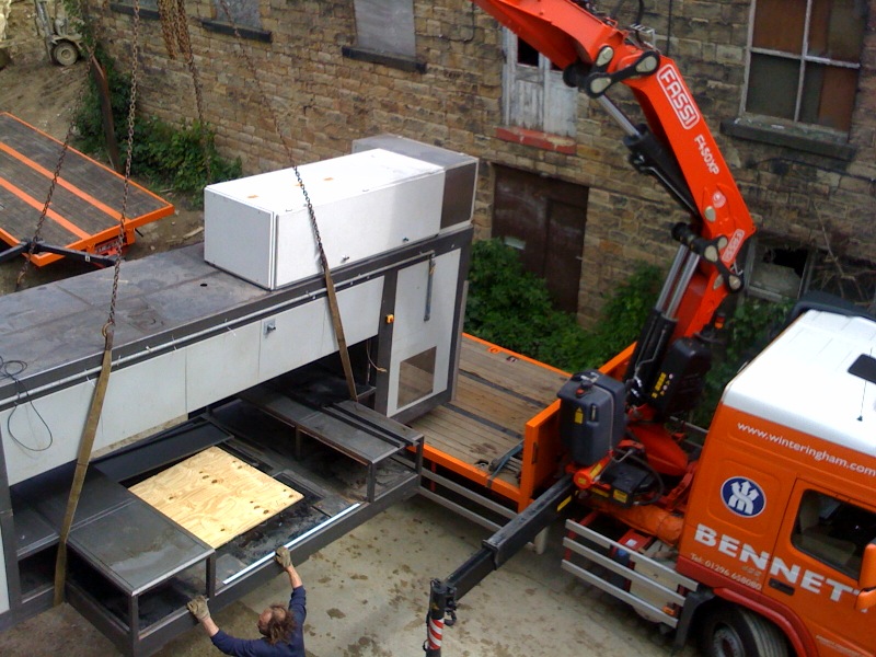

    Got this off Ebay last week, it didnt sell so the owner (Keron) lowered his asking price to £0.00 -Just needed to get it out of the way.
    Very big, fills the loading bay completely so I will have to remove some of the floor to get it in.
    Heidenhain controller, 500 watt ferranti laser, 3m x 2m cutting. Should be good for 20mm plastic and 3mm mild steel, which is nice as our small machines and control panels are 2 and 3mm thick steel.
    Also bought a 25hp Ingersoll Rand waterjet intensifier 56,000 psi at 1.9 litres/min £1,025. Going to build a tank and stick our motion on it, low cost waterjet cutting facility.
    Amazing, to buy both these machines new would be £200k +, so thats a saving of about £195,000.
    Difficult trading conditions out there at the moment so its a good plan to try and reduce your manufacturing costs, its also good fun buying toys, wonder what I could make out of laser cut plastic, apart from signs and stuff?

    We have removed the floor to fit the laser (this is the 'royal we' as I've done nowt due to a brief holiday). The laser is very big and heavy, uses a heidenhain cnc and a moving table, ballscrew and spinning nut, looks to weigh about three tonnes, which might be a struggle for our 2 tonne crane.

    Mike,
    It may pay you to remove the laser off the top whilst installing the machine.
    If that takes a knock it's virtually impossible to get back aligned again.
    Those Ferranti's can be pigs to tune.
    Early ones were filed with Fluorocarbon, later ones deionised water, whatever happens make sure the ballast resistor box in the bottom is bled before starting, one air bubble and it frieds the ballast resistors, - don't ask.
    John S -
    Thanks for the advice John, laser removed to a place of safety, in fact almost every thing removed, too bloody heavy to lift with our crane. Now in position ready for a rebuild, might have a bit of a hunt round for a higher power laser. I'm told there is a chap in Wakefield deals in them. Water jet machine going togerther shortly and looking out for a 3 metre pressbrake.
