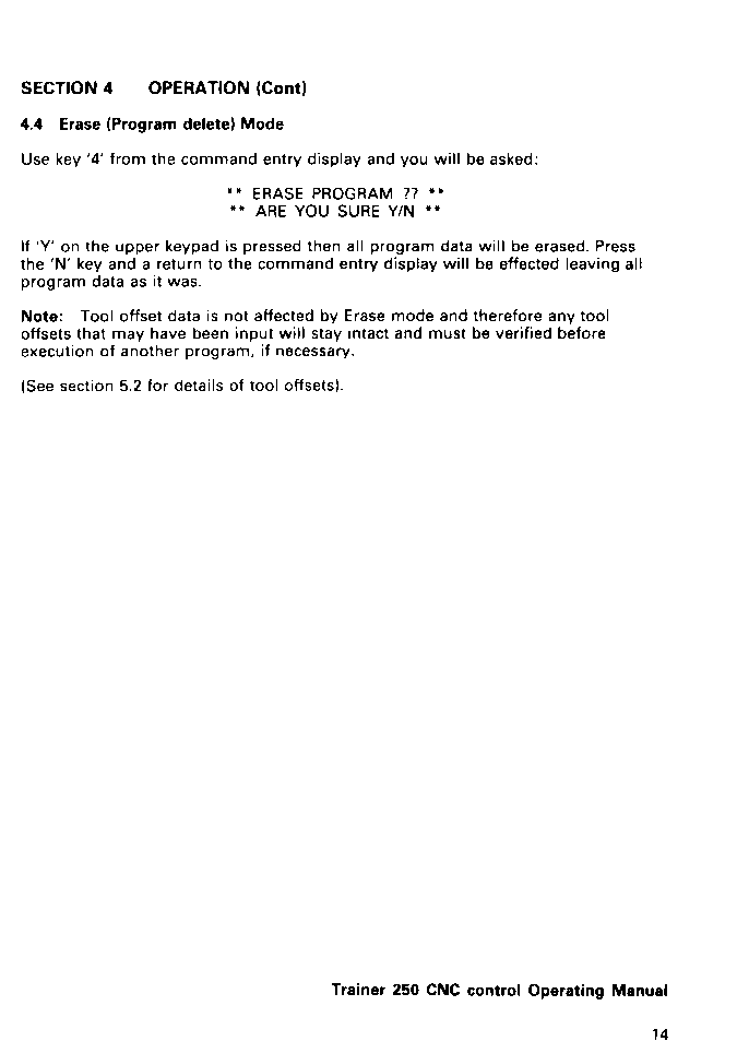

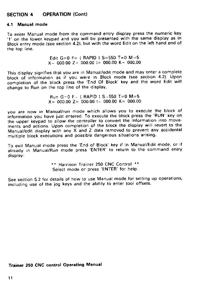

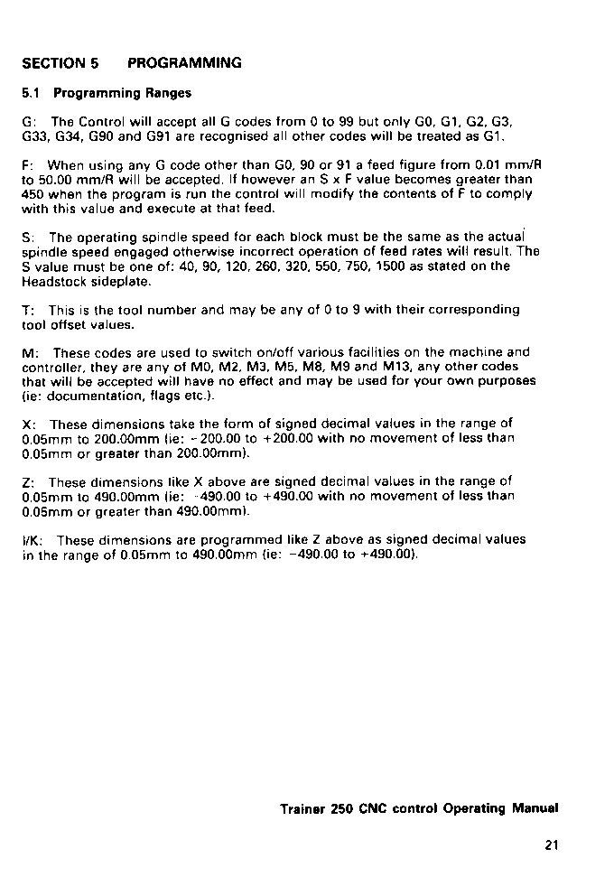

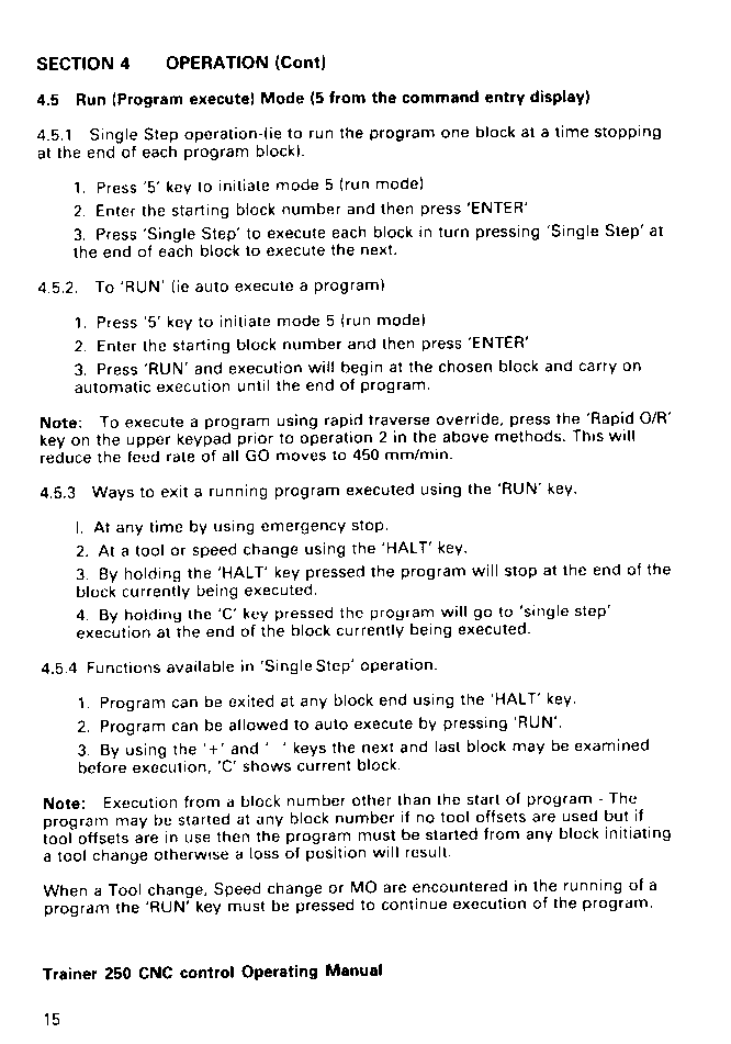

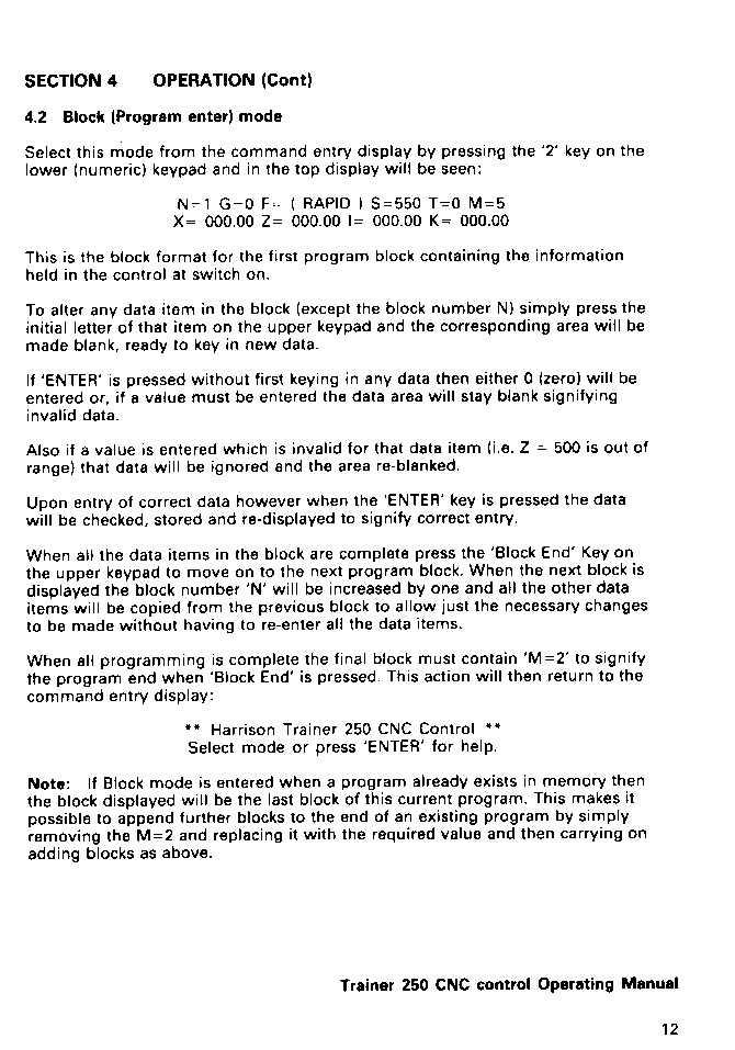

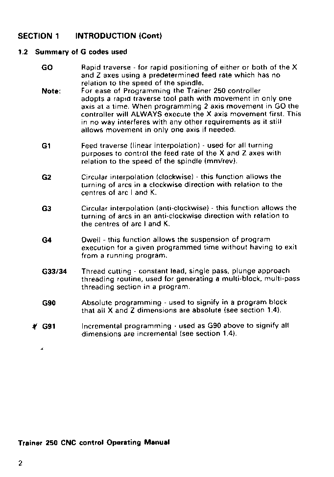

    Right then, scans done as 96dpi bitmaps and saved as tiffs - size around 100kb, not good for printing but should be OK for viewing on screen. I hope they don't take too long to download.
    I have scanned a few pages which I think might be relevant plus the contents page to show what is in the manual.
    The uploads just failed - 'invalid files' - perhaps tiffs are not acceptable?
  4. #14
    Quote Originally Posted by Arthur Kingdon View Post
    Just tried again after saving files as bitmaps (Windows format) and it seems to have worked. Not sure if mac users will be able to view.
