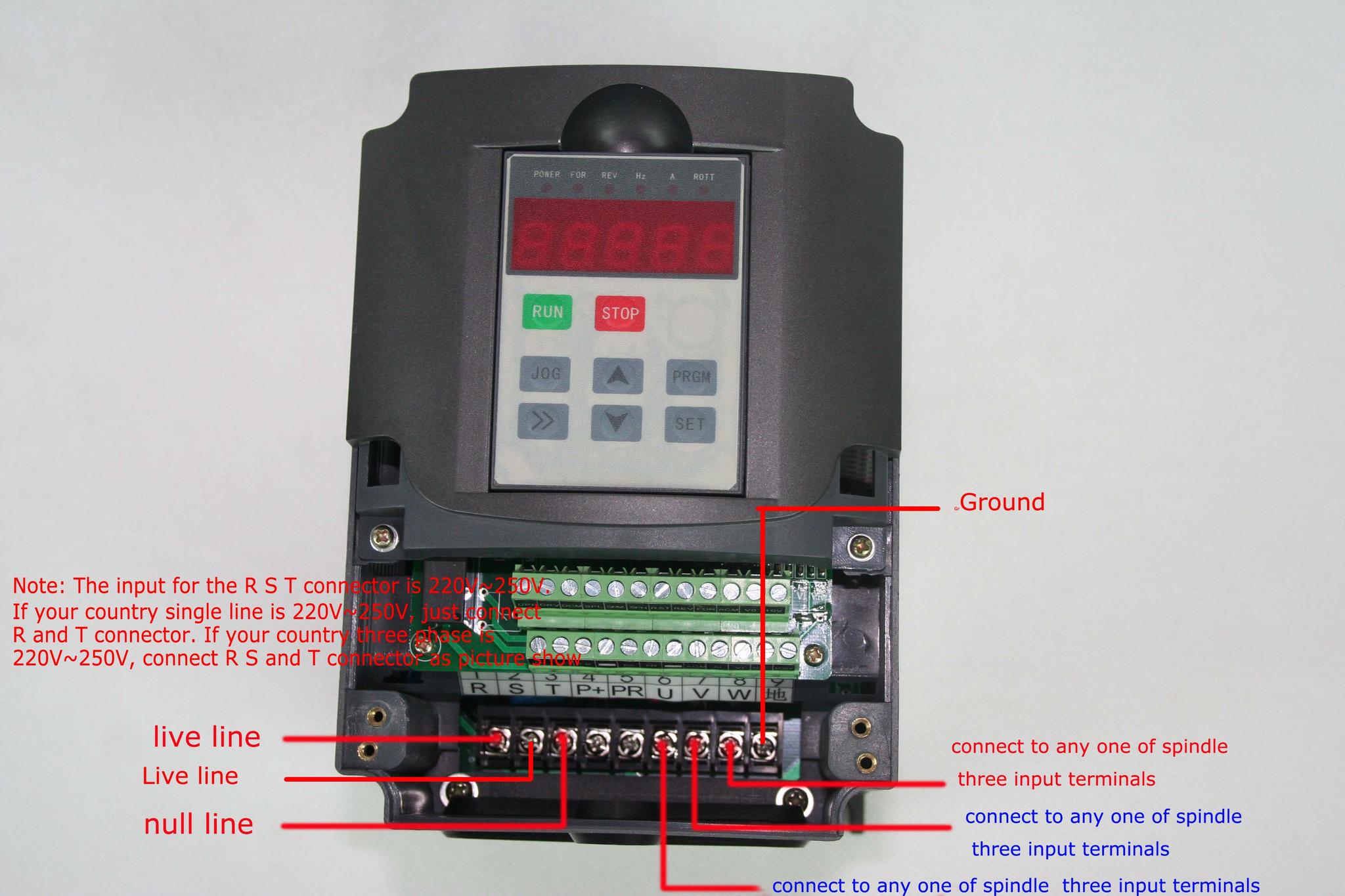

    So looking under the front panel I'm faced with this:
    Motor wires are self explanatory so no need to go over those. Where I'm a bit confused is R S T ...... does it matter which one the live and neutral go to? Obviously the earth goes to "9"
    I'm using a KK01 breakout board which has a relay output ..... am I correct in thinking this can be used to start and stop the spindle. If so which would be the correct blocks to wire it into from the basic mention in the manual DCM looks like it might be the one but rather than mess things up I'd appreciate any input for people who have run or are running a similar setup.

    Mains input is easy - just use two out of RST, and it doesn't matter which one is live and which is neutral.
    Can't help off-hand with the spindle switching as I don't use it at the moment. One day I'll get round to proper spindle speed and on/off control, but I'm not there yet! For the time being, I just use the front panel controls.
    Here's what came with mine, should be of some help...
