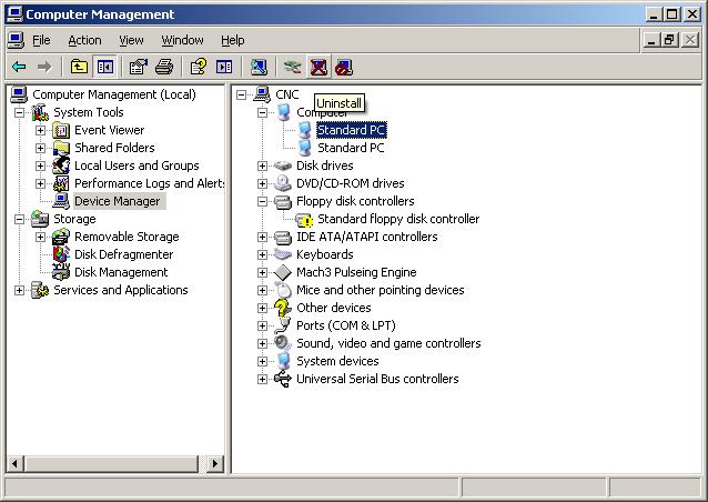

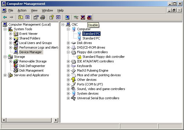

    Hello,
    Problem not resolved :(
    What I did ....
    1. Reinstalled XP PRO ...
    2. Applied all steps from XP optimization.txt ....
    3. Installed Mach3 + licence file
    Started, but the same problem ... on every 200 - 300 mm movement motor 'knock' for a less than a second ... maybe 0.1 s ... :( I can feel the 'knocking' by my hand .....
    Attached Win XP device manager screens - why I have 2 standard PC in my device manager .... is it normal ???
    Any ideas .. ? Please help
    Emil

    What voltage do you have coimng out of the PP.? This problem sounds very much like PP is low power probably 3V type. This will cause the problem you are having because there isn't enough voltage difference between HIGH/LOW.
