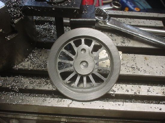

    This is a stainless steel loco wheel 85mm diameter, 10mm thick cut with a 4mm carbide cutter.

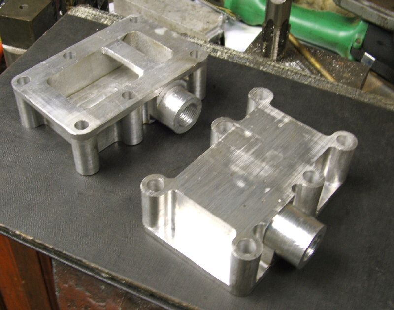

    Two housings in aluminium approx 5" x 3" for a vintage Alvis car, all CNC machined including the thread milling but not the welded bridge which was done after.

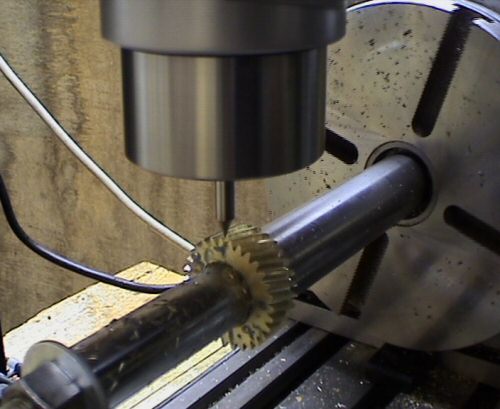

    Helical gear done on the 4th axis with simple form tool.

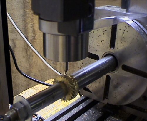

    Herringbone gear done in one pass as one piece on the 4th axis.
