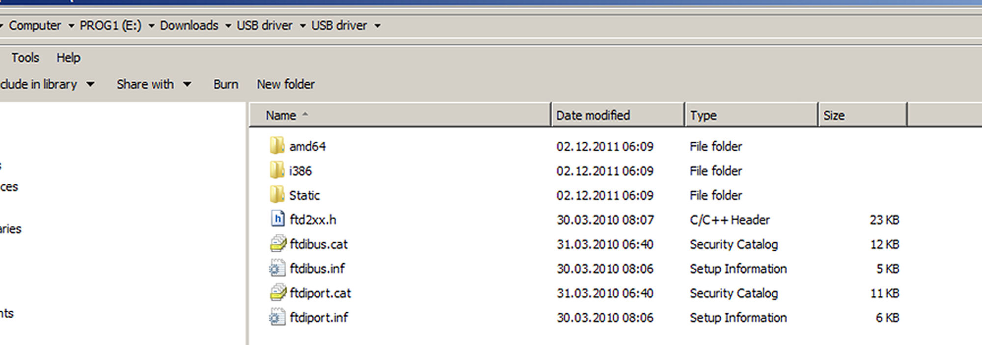

Looks as tho you still have the wrong drivers
24-02-2015 #2
Yup. Lol, no idea where to get the buggers. I've exhausted everything online. Let's hope redsail get back to me. Bloody thing is still under warranty but I don't have sales reciepts

Hi
I'd 1st try a different PC with XP on it. Beg/borrow etc !
Until you can get the driver properly loaded on something, you can't tel if the controller works or not.

Tried on 3 different Xp and 2 win 8.1 (we have a few laptops in the house lol). Works on none :(
01-03-2015 #5
I had a problem with drivers for a device and from the system screen in control panel I found the hardware_id associated with the device. I copied the value into my browser bar and did a search and it came up with a site for the drivers. I can't remember the exact details of where to find the hardware_id, but it was probably under driver details in the property tab for the yellow "?"-d device. The boards these machine use are often designed with a standard comms protocol.
