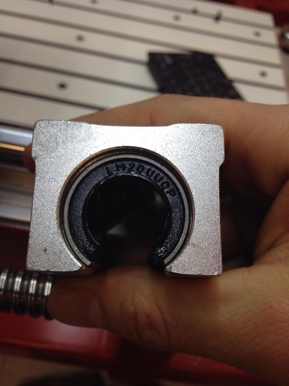

    I was wondering if anyone had any experience with upgrading chinease linear bearings?
    On current machine I have 20mm supported rails and the LM20UUOP type bearings, they perform well but there is quite a lot of variance between them, as in some feel smooth and others are gritty and notchy. I have tried various settings of "preload" by tightening the grub screws on the housings but for the bad bearings this just makes them worse.

    They can feel like that if the number of balls is too low or too high. You might want to count how many balls per circuit are in each bearing for comparison.
    An easy way is to look at the gap left when you bunch them together using a toothpick or similar.

    I will have a look tomorrow, if there is to many or not enough balls surely it's not going to be practical to put another one in? Or is this possible ?

    I counted the balls and there was one missing on one of the races but that was the smooth one!! Who would have thought that!

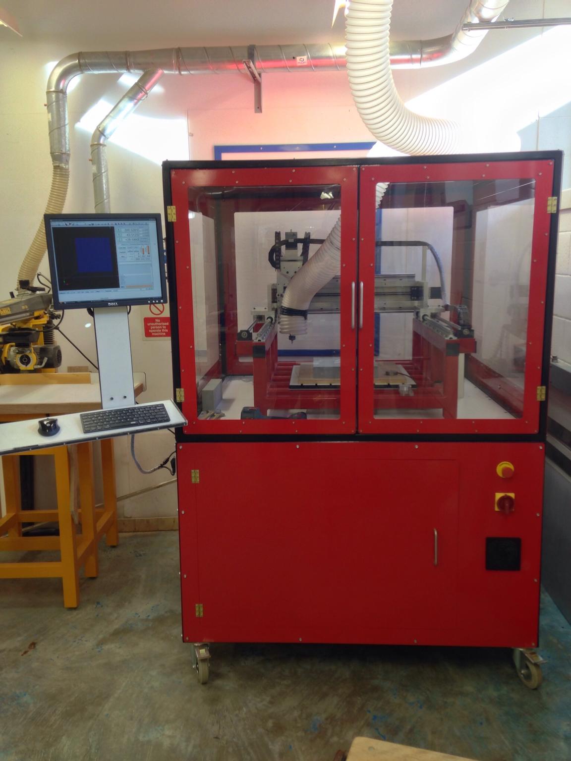

    I took some pictures so you can see the machine anyway but thanks for your help guys !

    Just upgrading the rails would give you an enormous improvement. Looking at the pics the screws seem fine are they 1610 x and y and 1605 for Z ..Clive
  8. Nice looking little machine Joe, like the housing too. What do you make out of interest?

    Yes the enclosure is a good thing to have, the machine and all its electronics are in the enclosure and then I have storage space in the bottom.

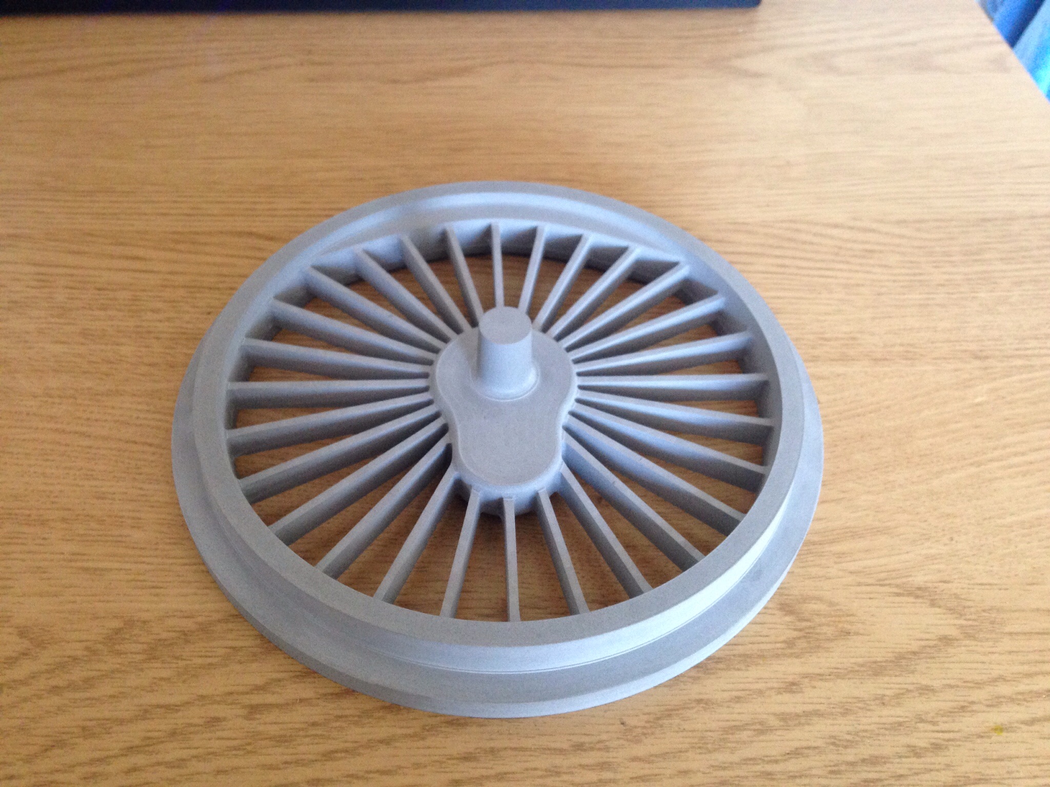

    I cut mainly aluminum, plastics, modelling foam and wood, a real mixture really . It can machine steel but I try to avoid it when I can.
