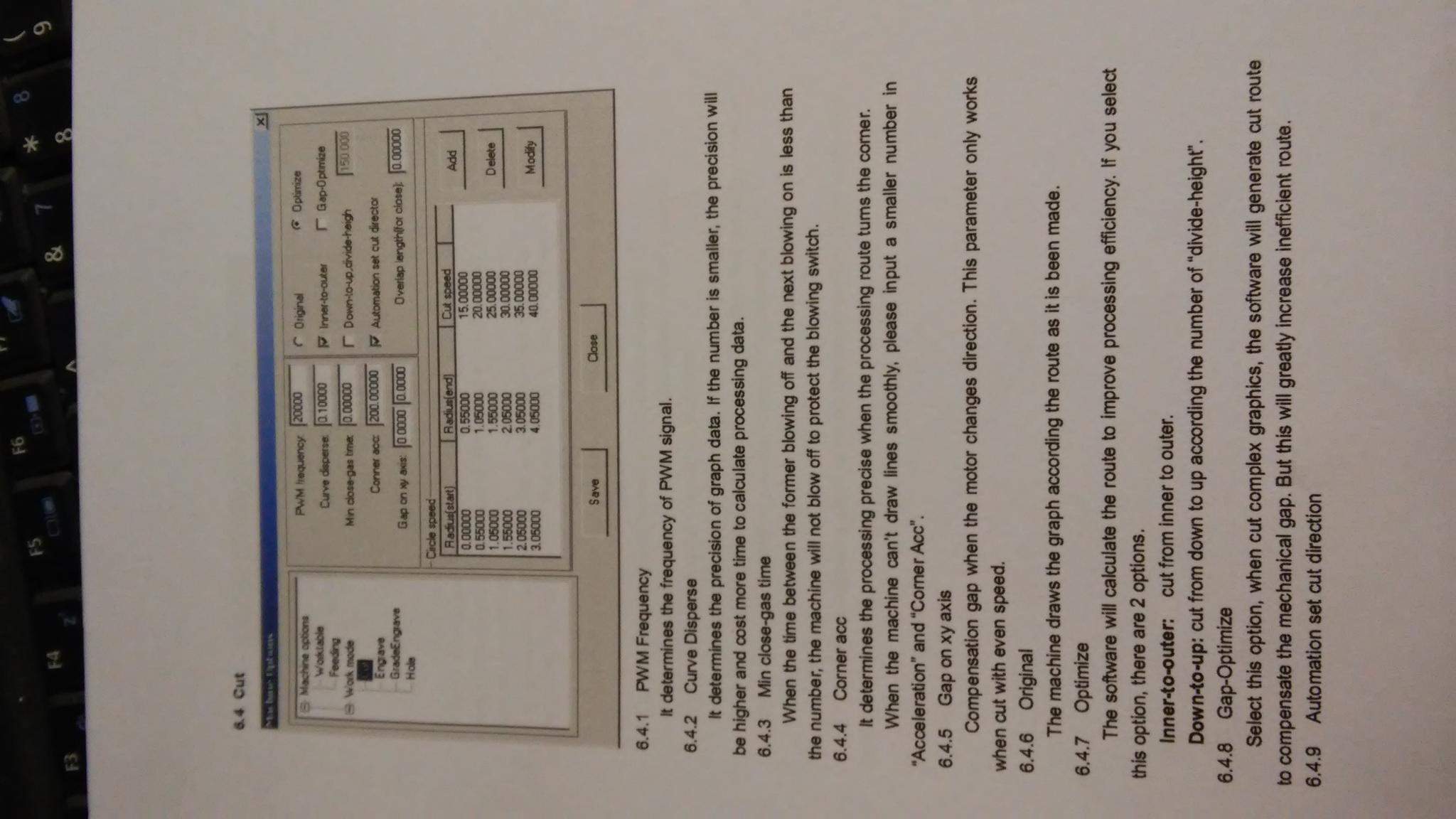

    I'm new to laser machines and not having a luck or much help from who I purchased it off. Ive loaded the laserworks software and attempted to do some test cuts. I drew a simple circle and square about have come out stretched like ovals and rectangles and neither have cut just engraved even though I set the speed and power to cut. Any idea what could be causing this?
    again
    If you can't fix it with a hammer you've got an electrical problem !
    Think theres a setting for circles. ...I'll take a look when i next open mine. I'm strugglin with settings for machine setup and often runs into the bed.
    That doesn't really help, think that he's explained he can send files to cut but they get distorted.
    Needs help to work out how to stop circles distorting. In the preferences there's a setting to change speed I'm sure.
    Does this help?

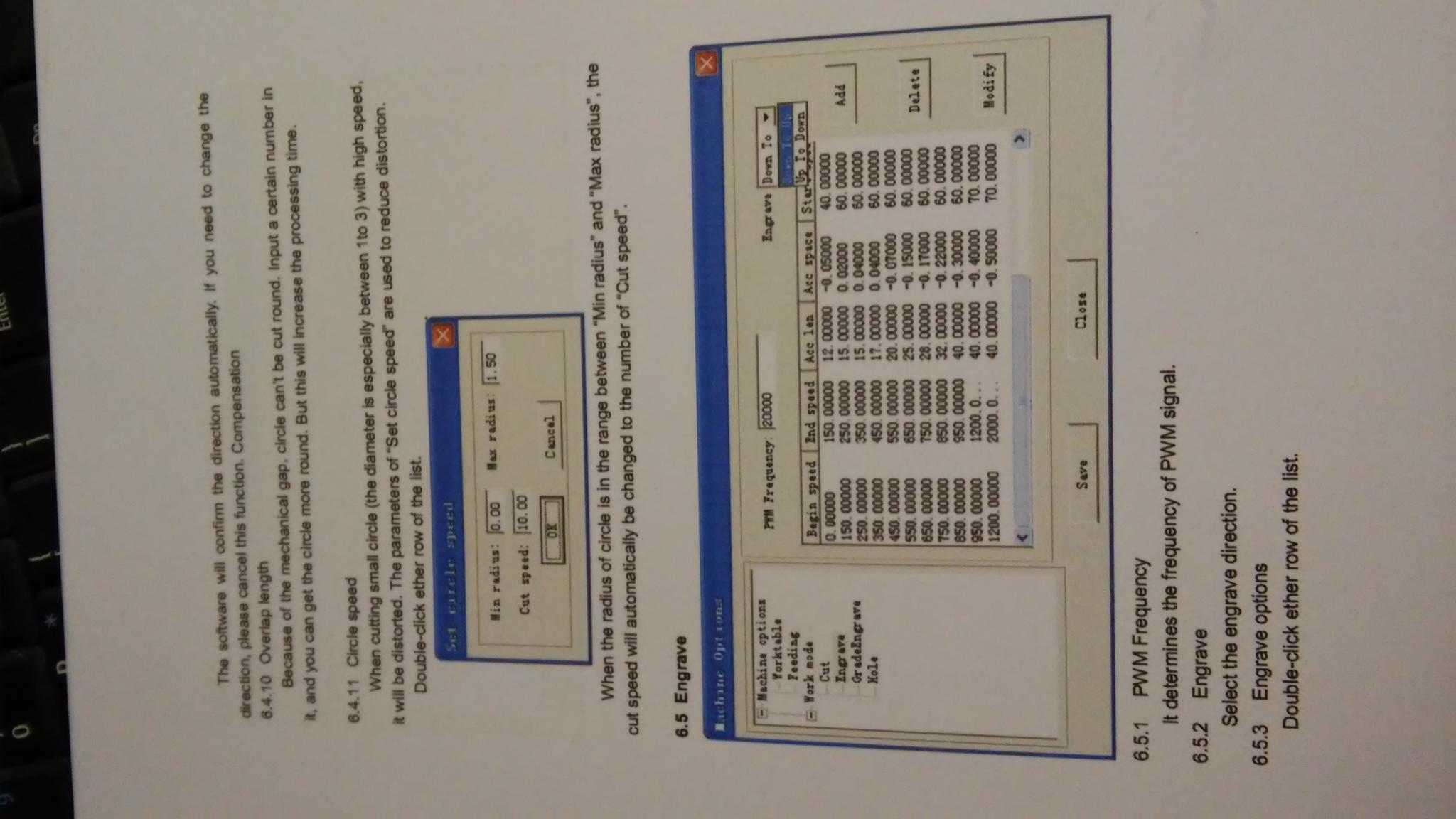

    And this? Bit more info

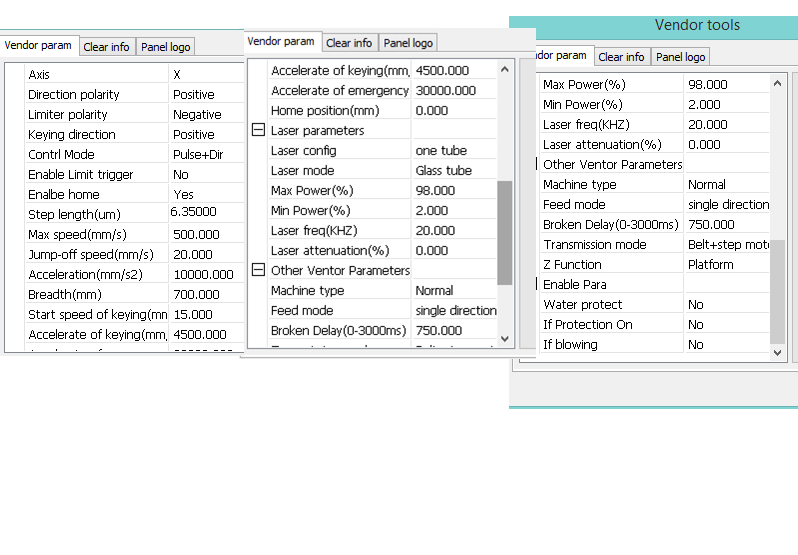

    Hi Thanks for your replies. I've been playing around with it and discovered the x axis is off by 50% so if I double the x axis value I get perfect circles and squares. No explanation anywhere to why this is happening, I've noticed also that the laser head only goes to the middle of the x axis arm, so again 50% even if I use the control panel on the laser to move it. Mt machine is 500x 700 and the x axis will only go to 350. All my parameters seem correct. Any one know what could be causing this. Fed up with this machine, would not advise anyone to buy one :-(
