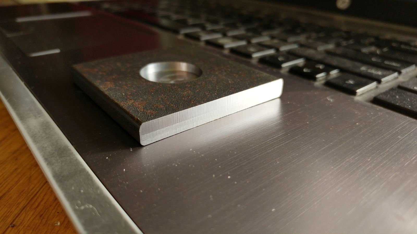

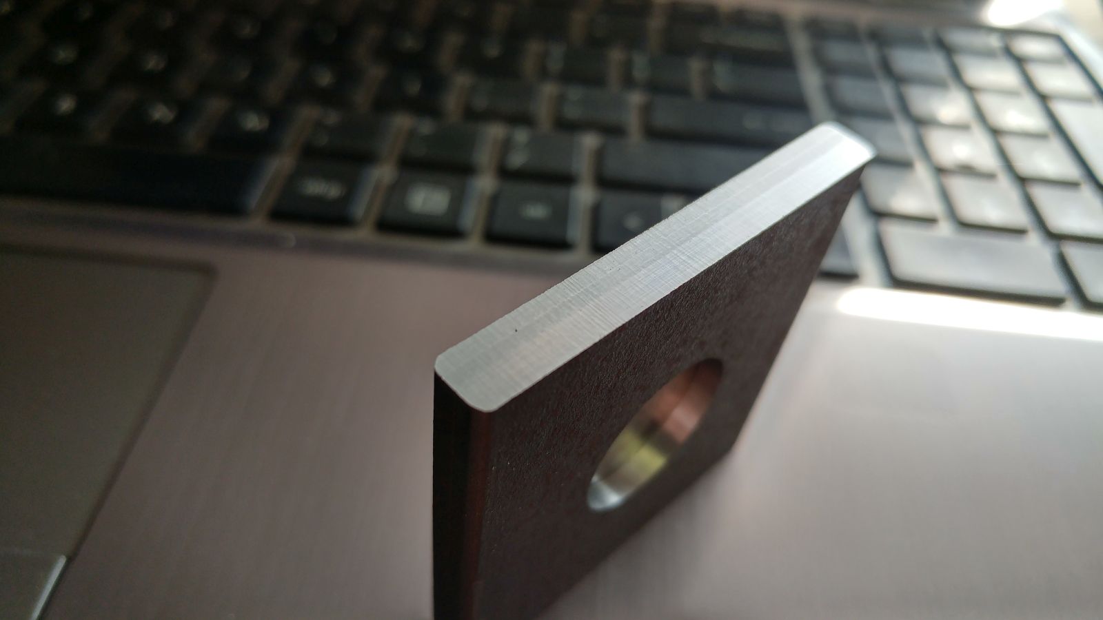

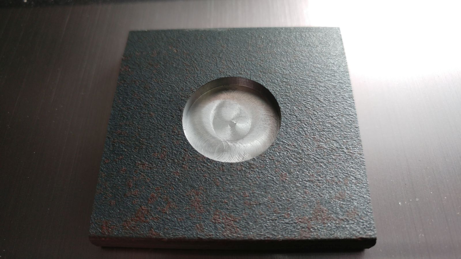

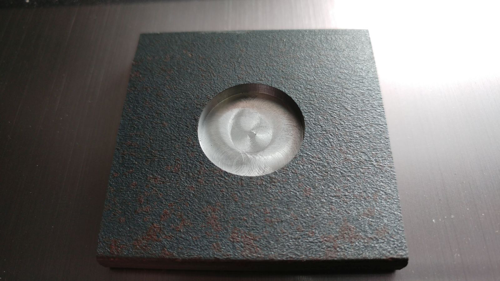

    Managed to sort out my problem. Almost too embarrassed to tell but.. as it turns out it is not wise to calibrate machine axis with a dial indicator. At least a machine that has not super accurate ballscrews. Also the testpart that showed inside measures correctly and outside wrong, was coincidence I believe. I re-calibrated my axis with a 300mm caliper. Problem solved.
    So anyway here is a little cherry on my strawberry cake:
    Material: S335
    8000rpm, 350mm/min, DOC 3mm, 2-flute TiAIN 6mm endmill.
    Some chatter but nothing major... Shitty workholding. Nice blue chips where flying :)
