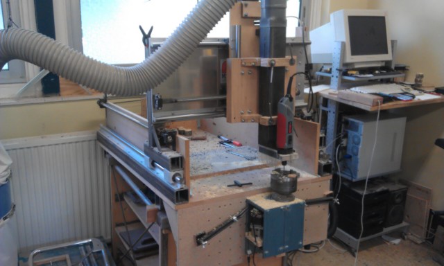

    I'd change the plate you have now for the Z-axis for a 80x80 steel tube and connect the dust collection to that.
    That works really well.
    Do put a brace between the mounting of the spindle and the oposite face, otherwise the mount may flex. Probably not as bad as my 35 mm high kress mount but still....
    Quote Originally Posted by Sven View Post
    I don't quite follow you. Do you have a sample picture how the 80x80 steel tube would work as dust collector?
    Dust is the problem that needs solving in my design though. I was aiming for some simple bracket that holds dust extractor tube...some housing with brushes...I need to put it on the drawing.
    For spindle mount I will order tha thick cast aluminium version. Nice and rigid I think.

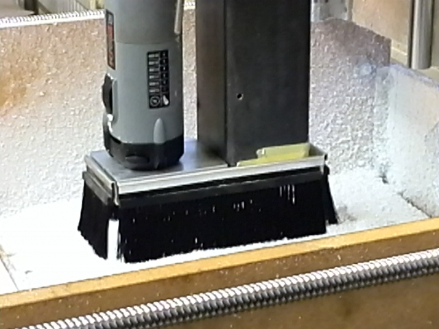

    Complete with dust shoe:
    I have the tube clamped to the z-axis, so it can be set to a height.
    The next one would just be on linear rails.
    The height of the clamp is only about 30 mm, that requires cross bracing with the rear of the tube or it will flex at high feeds. (It did with this one)
    The cast aluminium one is much higer, probably will not need cross brace but you can always add it later, should you need it.
    A section of 100 mm pvc pipe can easily be fitted to the 80x80 if you heat it.

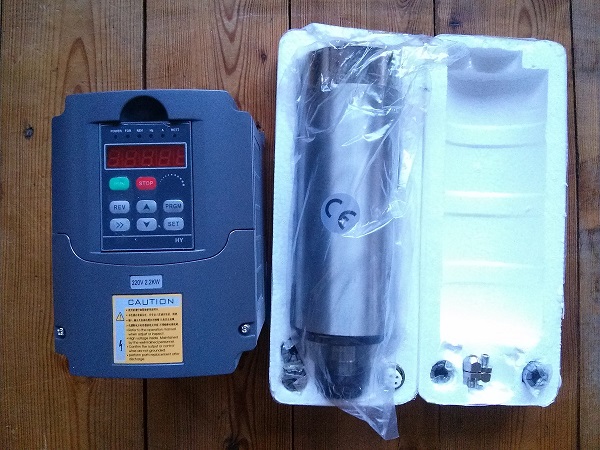

    My spindle arrived and its bigger than I imagined :)
    I hope to find time this weekend to work with CAD so I can order rails and other stuff from Fred next week.
    I will delay other electronics purchase as long as mechanical assembly is finished. Also I have ordered 12mm proximity switches.
