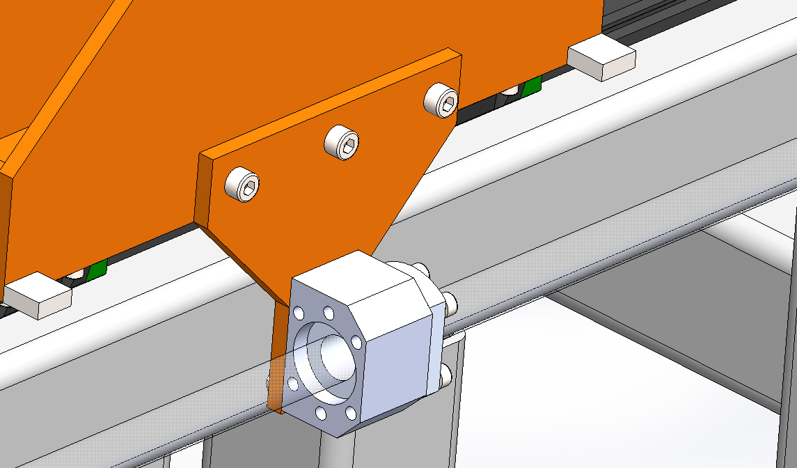

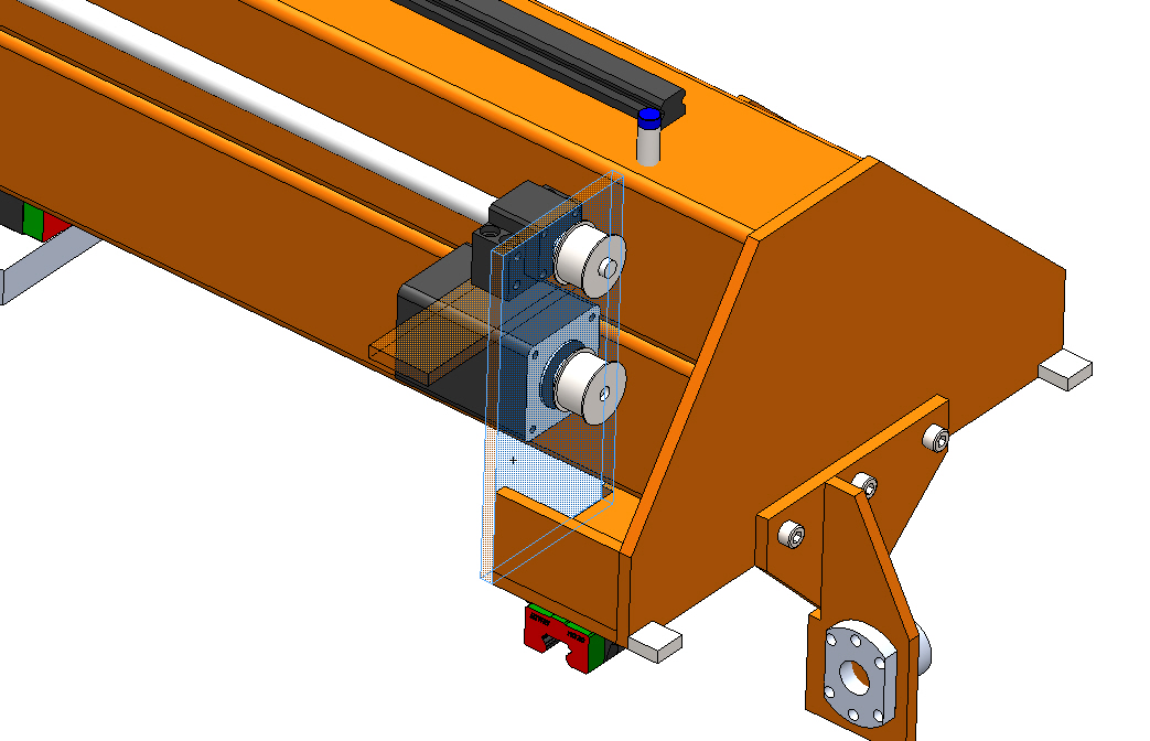

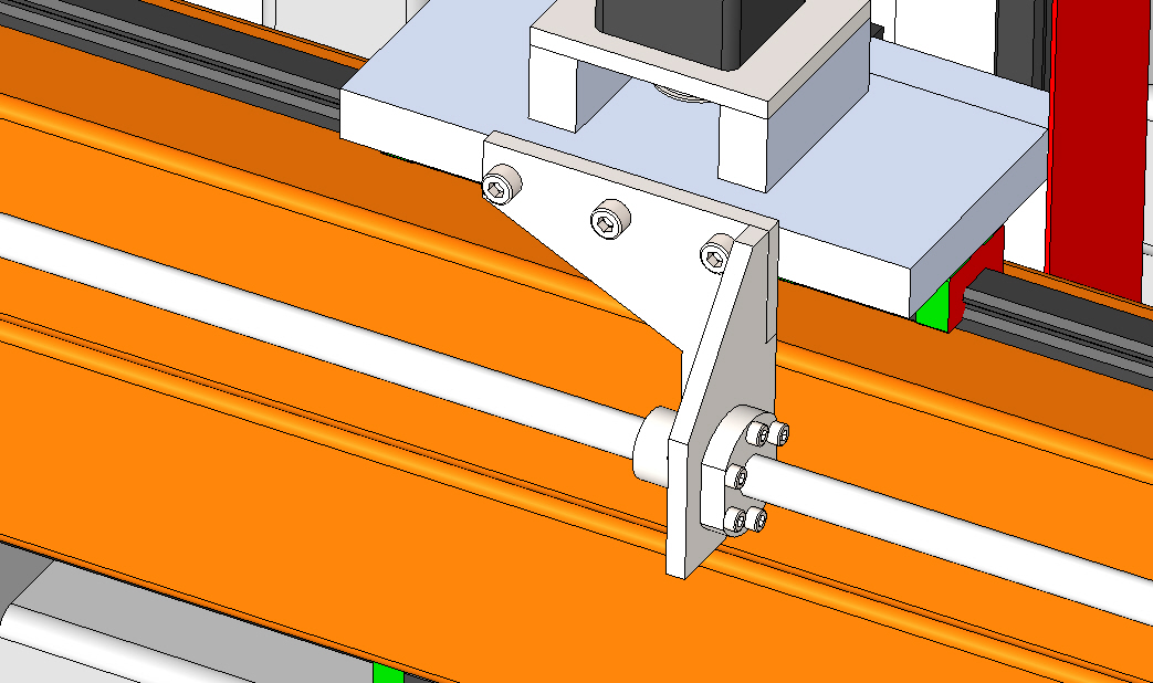

    Here are closer pictures. All laser-cut steel is 8mm and ballnut brackets are welded...

  2. #32
    So guys do you think I'm OK with the design?
    Next week I want to order screws, rails and other stuff. Unless...
  3. #33
    I'd brace your ballnut mounts, they just look a little flimsy compared to the rest if it. Looking good!!
    Neil...
    Build log...here
  4. #34
    Yes, why would you save money from the ball nut housing? They are so cheap and are preferable , cause with coupled with straight plate, there is no need for reinforcing, but as you have done it doesn't look strong.
    project 1 , 2, Dust Shoe ...
  5. #35
    Yep just beef up the Ballnut mounts and your set to go.!
    One thing I see is that you don't have much room for adjustment or alignment with that threaded bracket setup so give a little thought to how you'll do this for both directions. Ballnut housings tend to be easier to adjust than fastening ballnut direct to plate like that.
    Those little white brackets sticking out on the end plates are those for triggering limit switches at each end.? . . . If so have you thought about using a traveling switch and save your self a lot of wiring and messing around with brackets etc. I do all my machines this way and it saves alot of work and easy to setup.
  7. #36
    Thanks guys! Improvements implemented.
    Yes these are brackets for limit switches. And I have not thought about using only one traveling switch!
    Simple and ingenious - for sure I will also implement this!
    I will go ahead and order my stuff from BST Automation.
