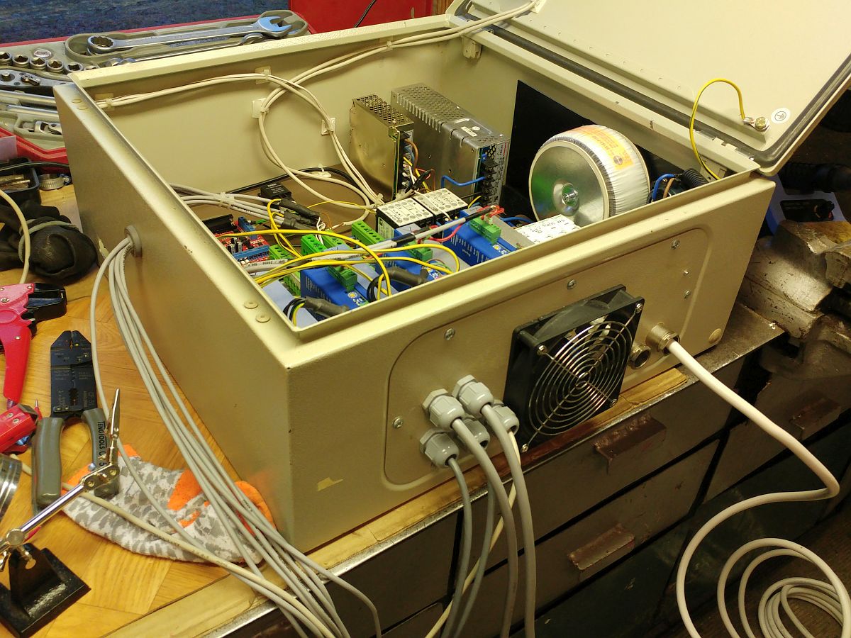

    So mechanical assembly is finished and electrical has been started.
    What cable type would you guys advise for:
    1. VFD
    2. Steppers
    3. Inductive sensors

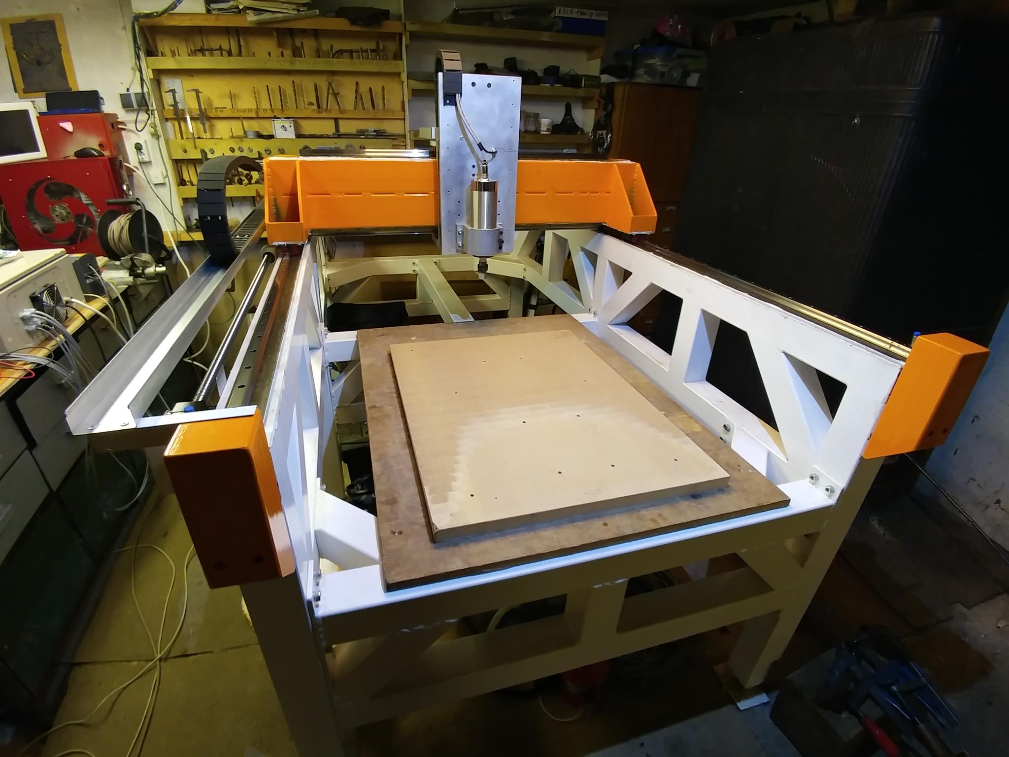

    Quote Originally Posted by toomast View Post
    This story is about Steel Gantry Machine with work-area 1500x750x200 for aluminium and wood.
    First I was going for a fixed gantry machine but bigger work-area changed my mind. As long as I have to purchase expensive components the price difference for longer components is not so dramatic - but it gives nice advantage.
    Main frame welded steel 80x80x4mm.
    Steel gantry consist of 2 pcs 100x100x3mm tubes welded together and some 8mm steel plates.
    Z assembly is mostly 25mm aluminium with 2,2kw watercooled spindle.
    Ballscrews X,Y=1610; Z=1605.
    HIWIN 20mm rails all axes. Epoxy leveled.
    Please feel free to comment my design. In case of positive feedback then next step would be to order rails and ballscrews. Measure them and then finalize design and start the build.

    Why gantry 100x100 is only 3mm thick? I would make at least 5mm - 1.2m long
  5. #74
    Quote Originally Posted by Tom J View Post
    Its ok. Its only 1 meter long. In the middle where 2 beams meet is 2x3mm so quite strong there, like an internal brace
    project 1 , 2, Dust Shoe ...
  6. #75
    Do it.

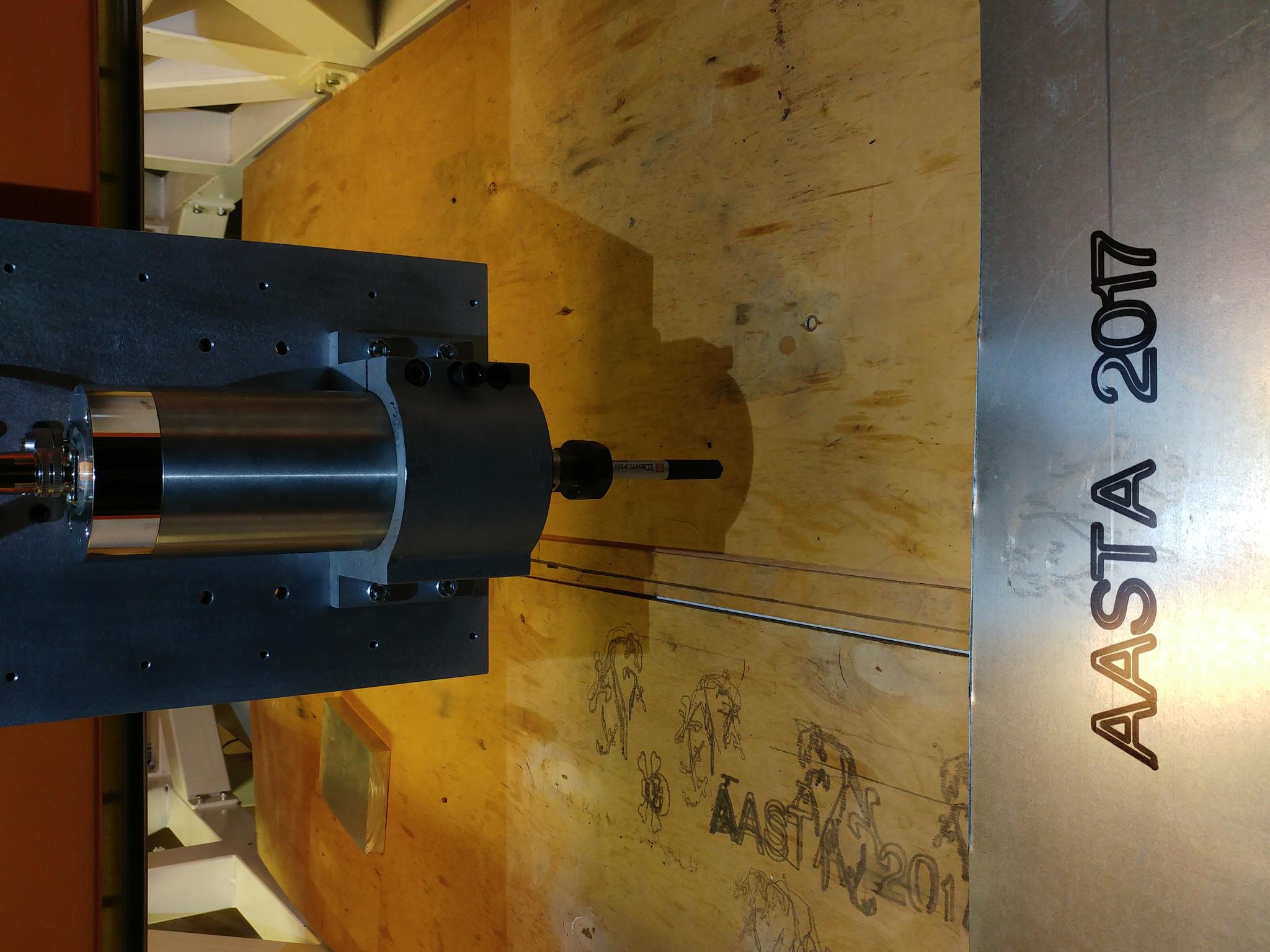

    My router made its first moves on 1st 2017.
    There are some issues that need solving:
    1. The guy who bored my pulleys obviously did not know what he was doing - terrible runout on some of them.
    2. VFD is causing my PC video card some troubles. While spindle is on my screen goes black for 1-2 seconds with an interval of 10 seconds. All cable shields are grounded and no other anomaly occur.
    3. Spindle watercooling
    4. Final bed design with side-covers
    5. Dust extraction
    6. Probe
    7. 4th axis
    I put on some temporary bed and made some chips :D
    It is the coolest project ever! Thanks guys!

    Yes + one on the vid and a good pic of the control box. Well done. Now the leaning really starts

    Great machine! Happy chipping
    PS. and change that pulleys. If you dont know who and how, order them bored from Belting online. Their pulleys are perfect and so is the job done. Only once i did no buy from them and i had problems with pulley straightness.
