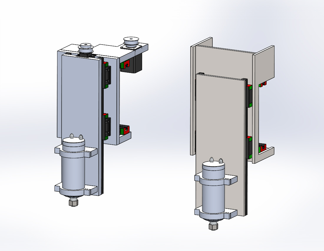

    Things are moving slow...but at least they are moving forward.
    I wanted to do all steel Z-axis but as I had something thrown together in CAD I changed my mind. Main reason is weight. Steel Z will be at least 7-10kg heavier. As my hole gantry is at the edge of using servos I will go with aluminium Z design.
    I'm not quite finished alu design but it will be from 25 mm thick material.
    Here is a picture of my alu design (left) and steel design (right side).

    I did all from steel cause i was doing the machine on the cheap and did not have somebody to machine it for me at that moment. Time wise is better to do all from aluminum. cause steel needs straightening, adjusting, first hand primer, second hand paint,...
    project 1 , 2, Dust Shoe ...

    I can't follow the reasoning for not using steel, except for silyavski reasoning. If the gantry is steel, 7-10 kilo'sfor the z-axis will not make things that much different. Except for stiffness!
    If the machine is for wood and this big, acceleration is less of an issue than top speed and for top speed stiffness is paramount. And all is designed to be stiff, except for this z-axis....
    Besides, you can get 20 Nm steppers of the shelf....

    I don't have first hand experience for none of them. But I dont think 25mm aluminium stiffness will be worse than 10mm steel.
    Popular belief in this forum is that weight is important and 20 Nm is not always better.
    Anyways I have an opportunity to find out...

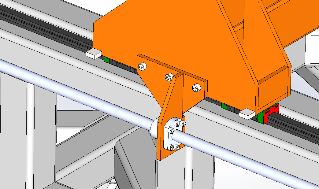

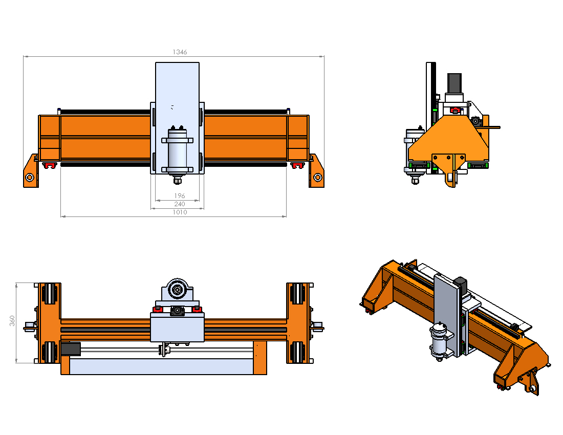

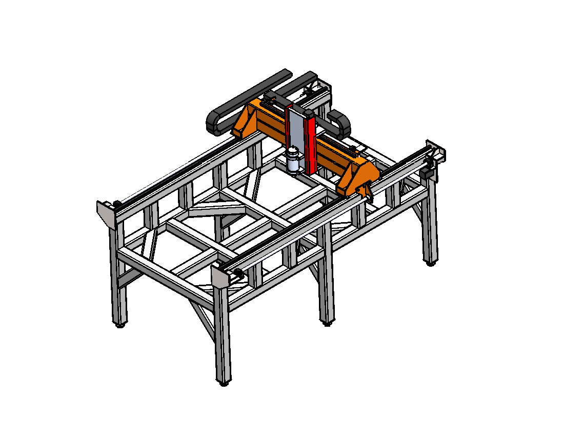

    So anyways here is the gantry. Bit on a heavy side - 84 kg. For sure there will be some more fasteners, dust collector, cable-chain etc adding weight. Plan is to use 2 x 2000mm ballscrews 2010 to drive it. Fixed/fixed ends. 3,1Nm steppers.
    Can I make it work?
    I dont want to go servos on first build :)
    Now my frame is looking like a toy :) Will make it 100x100mm tube instead 80x80 and beef it. Also I will ditch the bed design and try making some-kind of hybrid from marine plywood and aluminium surface for smaller parts...
    If you guys approve the design I will order screws and rails and stuff from Fred...
    Thanks for listening!

    Yes it will work thou with 83Kg + gantry you'll have lower feed rates than I posted lower down. Think the gantry on that machine was 50Kg.
    Now regards 100mm over 80mm then being totally honest I think this kind of building to excess is unnecssary and the little you gain isn't worth the cost and trouble. 80mm is more than enough for a frame this size. You'll gain more thru less resonance using 80mm or even 60mm but buy a thicker walled tube than going with 100mm thin walled (big base drum) tube.!!. 100mm thick wall tube is expensive and complete OTT for machine this size.

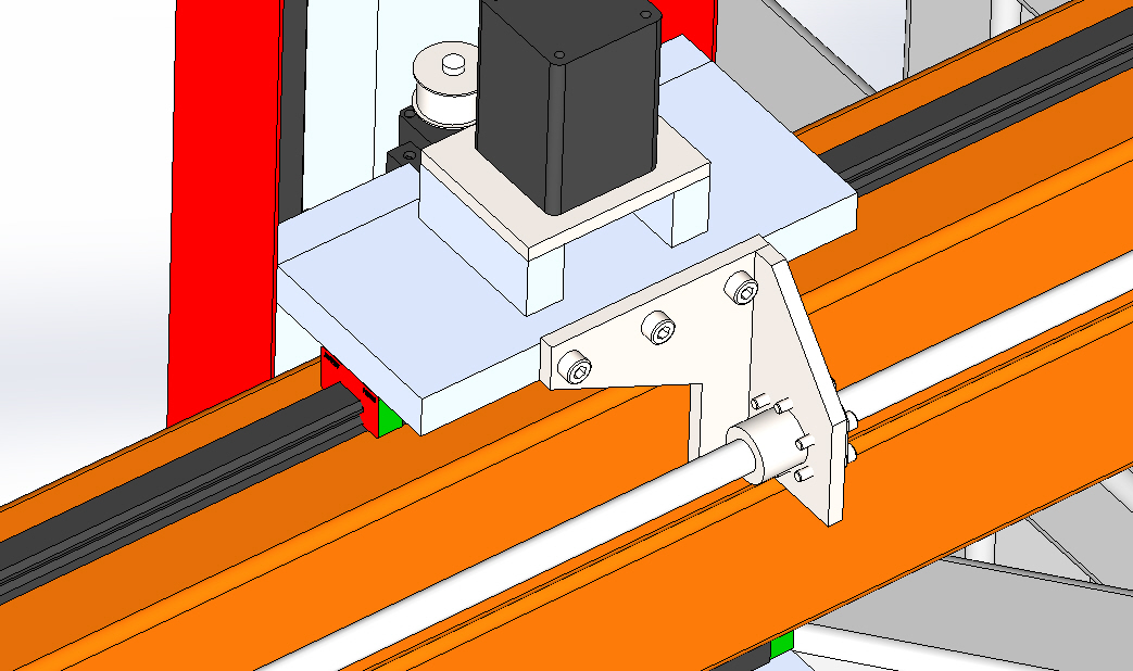

    Other than the OTT build strength of the gantry the only thing I see which I'm not sure about is the flimsy looking ballnut supports on gantry ends and Gantry ballscrew.
    Also not sure to how your mounting the motor and fastening to ballscrew across the gantry because pics don't show it very well. But it looks like your planning on connecting ballscrew to rear shaft of stepper and mounting stepper to a plate using normal stepper mounting holes.
    OR doing reverse and mounting stepper to plate using rear holes and having the front hang out in space connecting to ballscrew.? . . . .Both bad idea.!!
    Can you show better pics of what you have in mind.!
    On the Bed idea.! I see you have large distance from bed frame to spindle and no adjustment which will be fine for wood etc but no so good for harder materials. So if you don't need all the bed then think about a 2 tier setup with the alumnium cutting area raised up to bring material closer to cutter.
    The raised section could be made removable for when full bed needed and using a torsion box setup for stabilty.!
