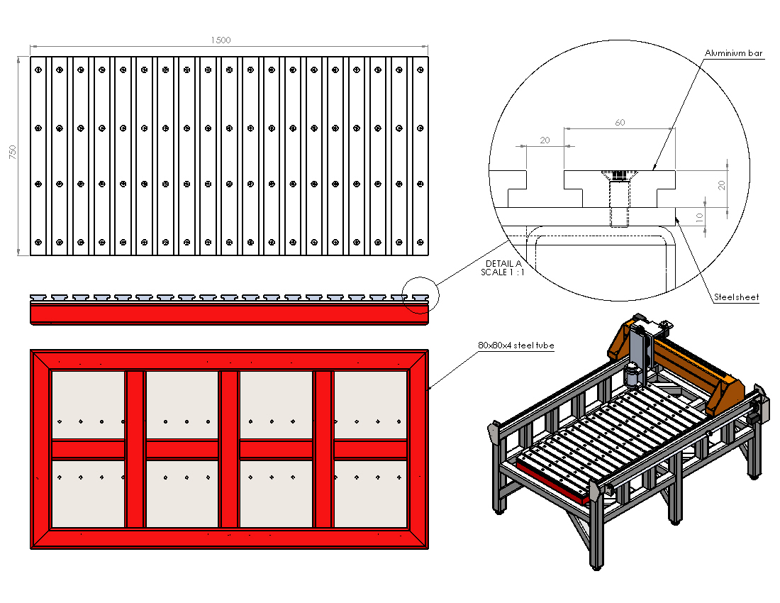

    Hi guys! So what do you think about my bed idea?
    I would have the big steel sheet laser cut and holes tapped. Then welded to the square tube frame. Then replaceable aluminium bars on top. I want to have it separated from main frame - for easier transport. That been said... CAD calculates 204 kg for the bed weight .
    Overkill?

  9. #19
    If you make the 10mm steel base a bit bigger than the strips you can put sides on it and then a drain in one corner and if you use coolant then you can drain it.....if you're not going to use coolant then ignore this
    Neil...
    Thank you sir! I will do it.
