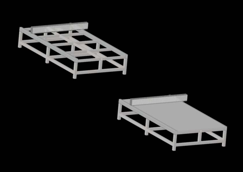

    Ben Welcome to the forum. Why don't you start by using something like Sketchup and submitting a drawing of what you would like to achieve. It needn't be expensive to have the steel frame welded up at a fab shop. Don't be worried about the drawing the good folk on here will keep you on the straight and narrow for you to have a good machine.
    It would help if you stated your budget as well. I take it that you have read through some of the build logs to get an idea of the general way to go. Good luck. ..Clive

  5. Hi guys, ok after a bit more research, ive come up with 3 options,
    buy second hand
    import a new machine (china)
    or go and build some thing....
    below is a very ruff cad drawing of what im thinking of...
    not a detailed drawing but a ruff design.
Name:	cnc bed1.jpeg

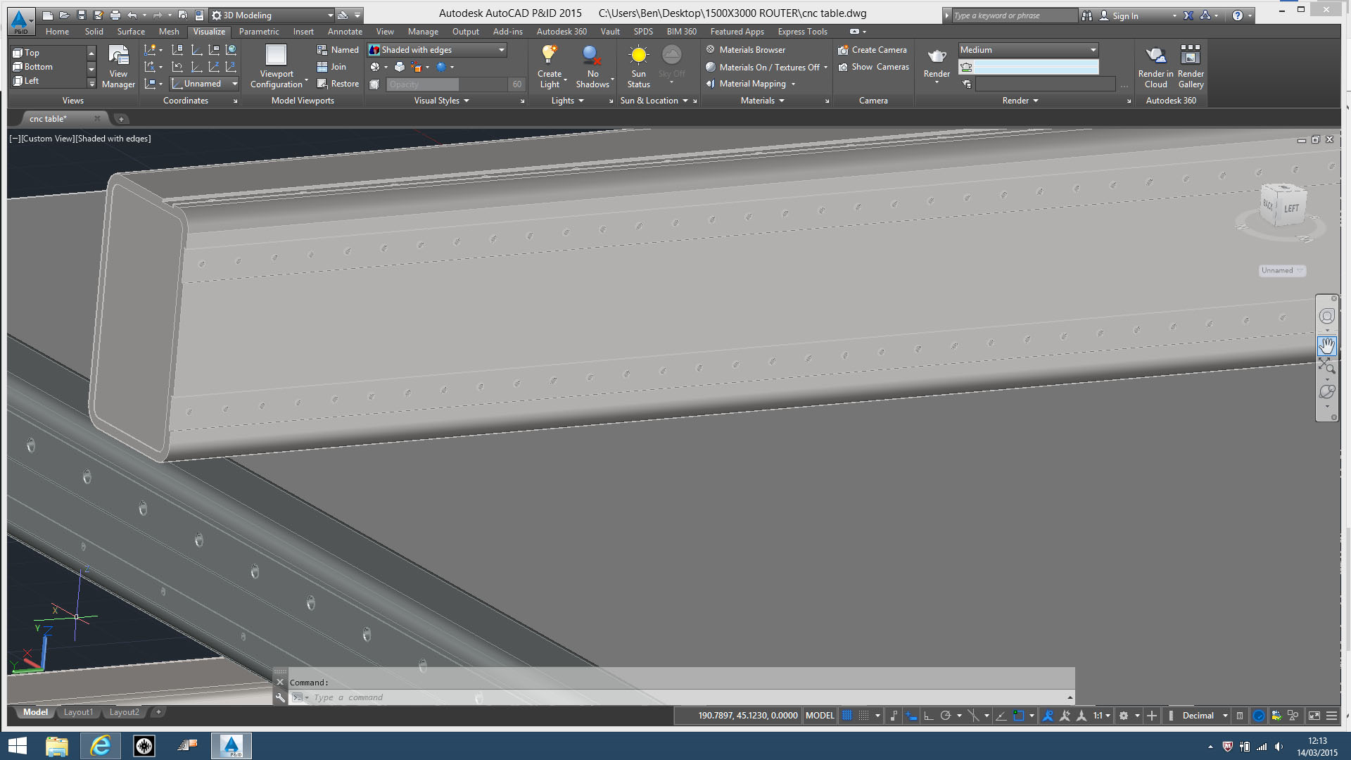

  6. hi-win rails, and rack and pinion drive.
Name:	cnc bed2.jpeg

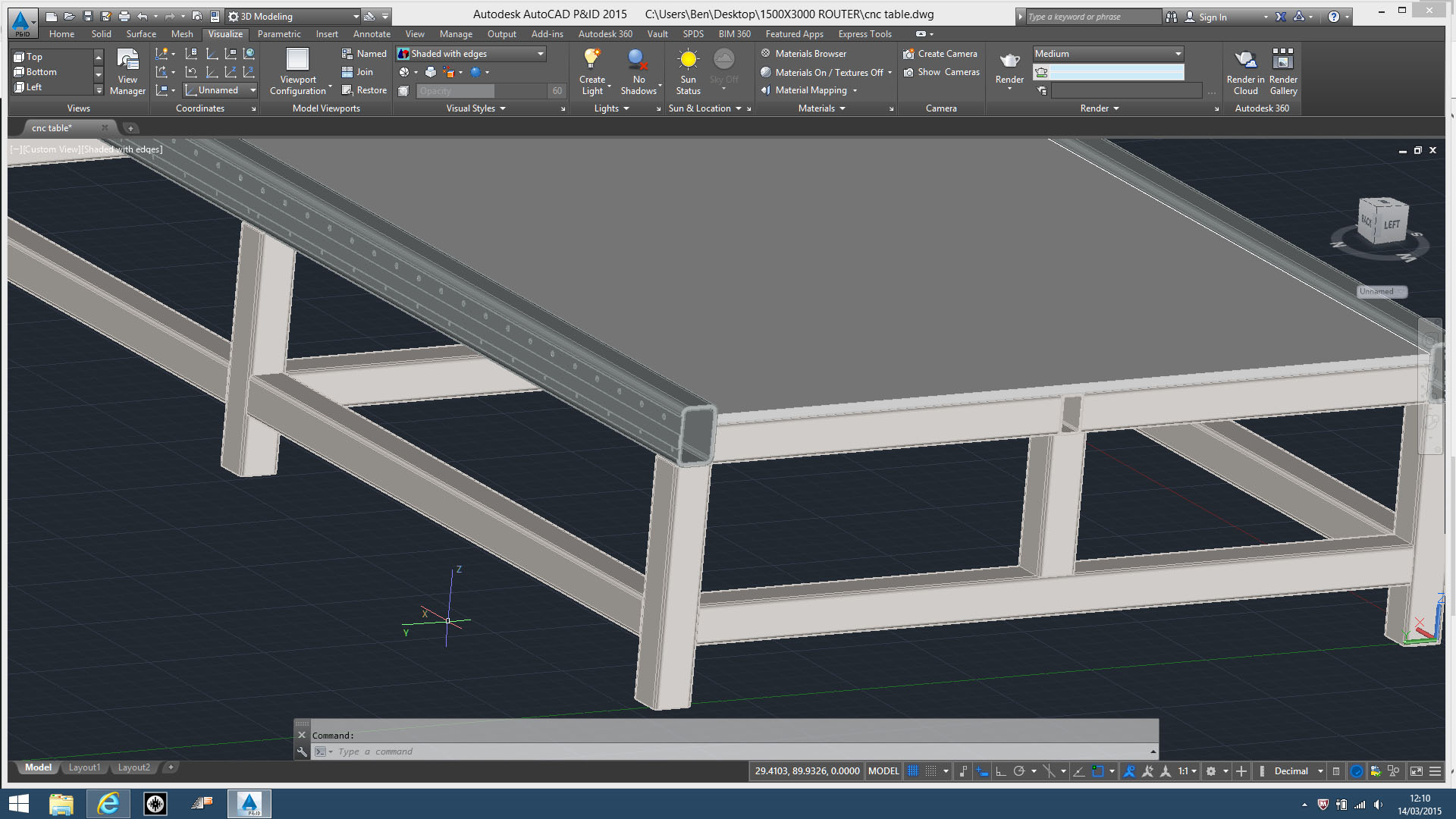

  7. again 2 x hi-win rails with rack and pinion
Name:	cnc bed3.jpeg

  11. #10
    Hi Ben
    It would help if you put some dimensions on your drawing. Some vac pumps are quite big Hp I believe. Clive
