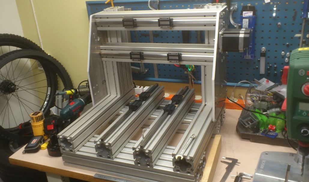

    Now I can see the side view of the gantry the lower gantry beam is actually supported underneath as well as at the rear - should be better than I originally thought from the first photo.
    Once you get the side plates added it will be a nice machine. But before you do I would add kiln dried sand to the gantry beams to add weight and provide damping. As this is a fixed gantry machine there is absolutely nothing to loose and it will help with the finish of the cut. Add one end plate, turn the machine on its side and fill to the top with sand, then add the second plate.
    On the electrical side - and I'm not an electronics expert so I might be worrying over nothing - is it good practise to put the stepper driver right over the top of the transformer coil (trafo in swedish)? Is there a risk of electrical interference?

    The sand filled beams sounds nice. Problem is that I have so many holes to plug. The lower Xbeam has a total of 26 holes in it. 8 on each side to fasten it to the Zbeam and 10 for the linear bearing screws. I once had loudspeaker with sand filled stands and that worked really good.
    I'm a bit worried that the Z moving part becomes weak but that is a later problem.
    The electric cabinet could be as you say a bit noisy. Thank you. When I made it I figured the drivers had grounded houses and the "ring trafo" should not radiate that much magnetic fields. But I have the break out board unprotected and I don't know how sensible it is. I am able to fit a plate between the trafo and the drivers if I need. I planning on having shielded cables for the motors but the "on to the break out board cable" from the PC is unknown (cheap cable).

    Ive got the side plates. They are water cut in 10mm thick aluminum. Ive tighten the upper part of the gantry and it feels really stiffer than I thought. I tried hitting it with a peace of wood and I could feel really small vibrations when hitting from the side so I might need the back plate as well. Otherwise it feels like hitting a rock

    The Y-plate is on its place and all screws in the frame work is tightened firmly (a lot of screws). It took me almost two hours just to saw the plate out of 20mm aluminum and machine the edges. And one hour more to make the holes for the screws. It seems to slide nicely on the bearings and it feels solid already. No ball-screw installed yet.

    Looking good Bofred but I see a potential trouble spot that could be made much stronger for not a lot work.? . . .
    The gantry rails mounted directly to the profile with no reference edges for alignment and support could slip under use just hanging from the rail bolts. I would mount rails to a piece of plate with machined reference edges that is same width and height as gantry then mount that to profile. It will massively stiffen the gantry and allow much easier setup.
    I would also put a slot in front of plate for ballscrew bracket to come thru which will offer protection to the ballscrew/nut.
