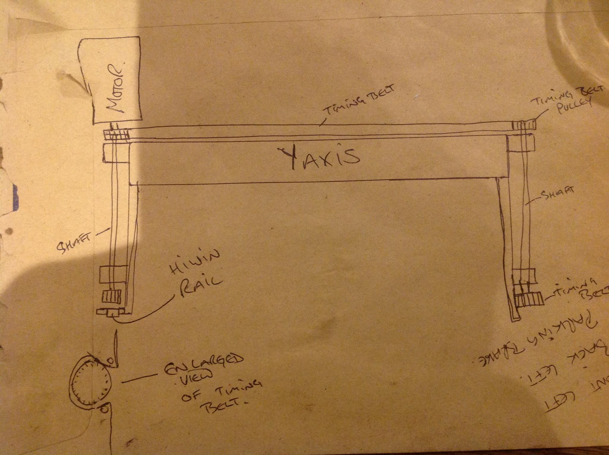

    Physicly Building plasma machine frame is doddle as there is no real strength required and precision/resolution is on low side for cnc.!
    Electronics on other handy needs very careful attention with absolutley NO cutting corners on electronic component selection or on attention to detail when wiring other wise you'll speed all your time chasing Phantom noise and pulling your hair out.!!

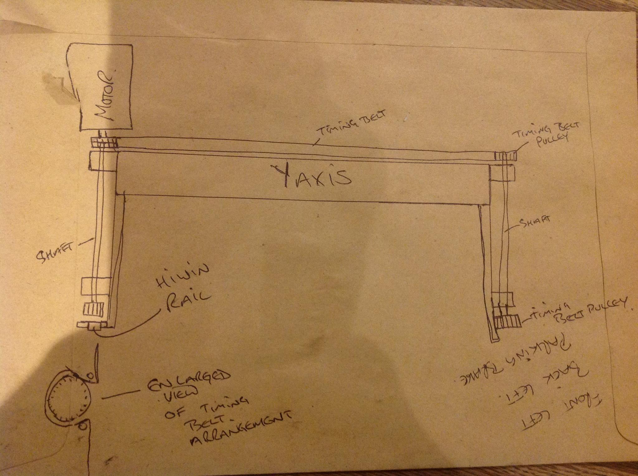

    I've got some ideas on my table, have bought some stepper motors, 23 for y and z and 34 for x, I'm looking at timing belt on the x and only running one motor,pic below
    2 pieces of timing belt tensioned on either side of the table, goes round a couple of bearings to keep the belt tight around pulley and then upto the top belt, maybe small timing pulley on motor to gear down the ratio, then passing the timing belt over to the other side, down the shaft and similar belt assemble onto other side, should be easy to time up and keeps it tidy
