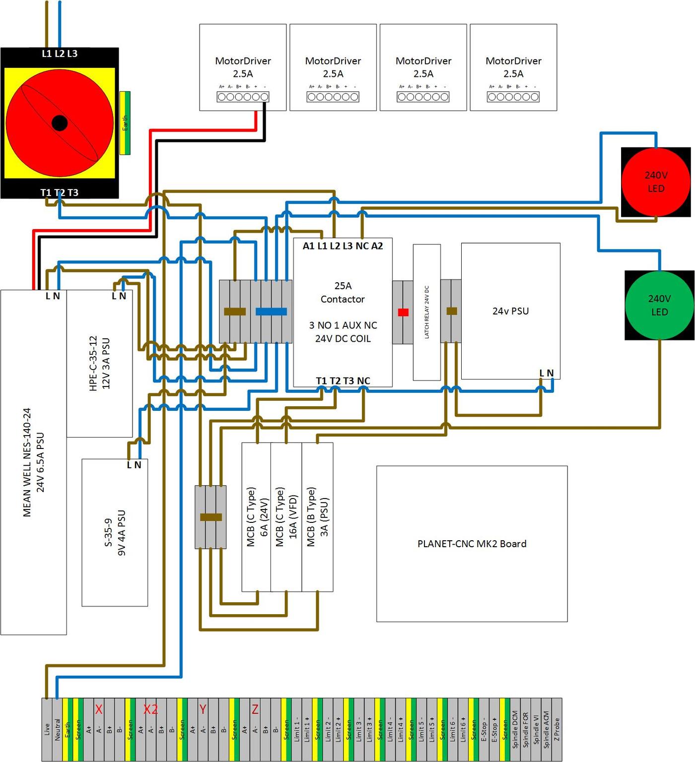

    OK, can someone just cast their eyes over the main wiring for my cabinet ( attached image ), a little bit of reverse engineering from other diagrams on here and adapted to fit my needs i think?

    The drawing is a bit ambiguous for me I would prefer more of a schematic. Do you really need 4 PSU 2 x 24 V 1 x 9v and 1 x 12V.
    I don't know how big your machine is but its a shame to use only 24V psu and those drivers because your machine might have so much more potential if they were changed.
    I have bumped this up so that Dean might see it and chime in. Clive

    Ding Dong Ding Dong.!! . . . . 24Vdc is correct for these drives Clive they only Take 30Vdc Max so don't want to release the Magic smoke.!!
    Quote Originally Posted by Dwayne Dibbley View Post
    Ok well see a couple of things.
    Don't see the latching Relay wiring.?
    Don't see the point of the Green 240V Led just use Red Led that's on all the time Power is On. Use the Green Led for indicating System is Reset and Ready. I'd Also use 24V leds.
    Don't Like the fact your using 1x Mcb for 3 x Psu all different sizes. You will be better having the smaller ones on separate Glass Din rail fuses.

    ill upgrade to real drivers one day :), regarding the other PSU's the 9v powers the USB controller, and the 12v spins some fans on the drivers and the din 24v powers the estop thingy to kill power to the other psu's
