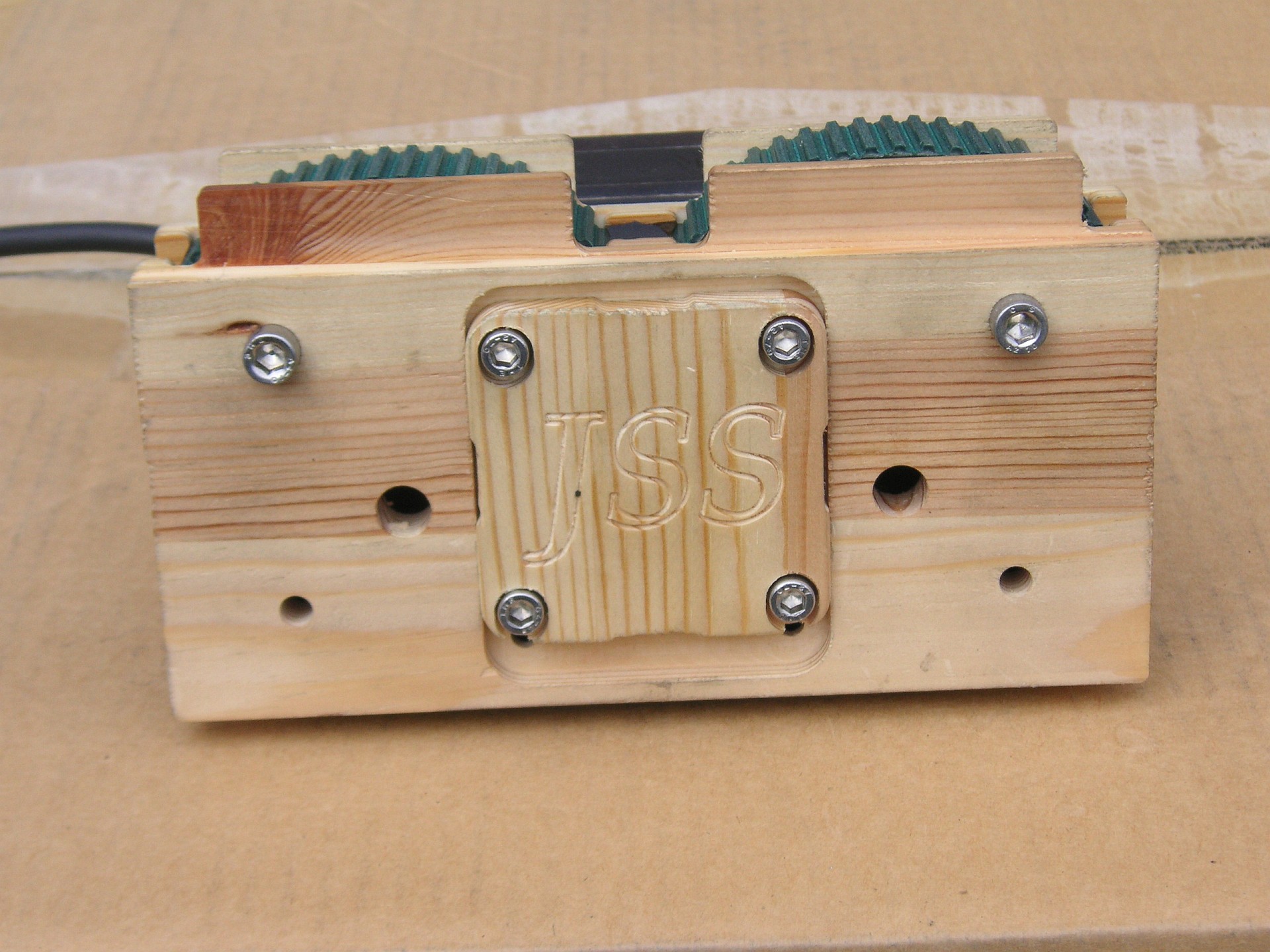

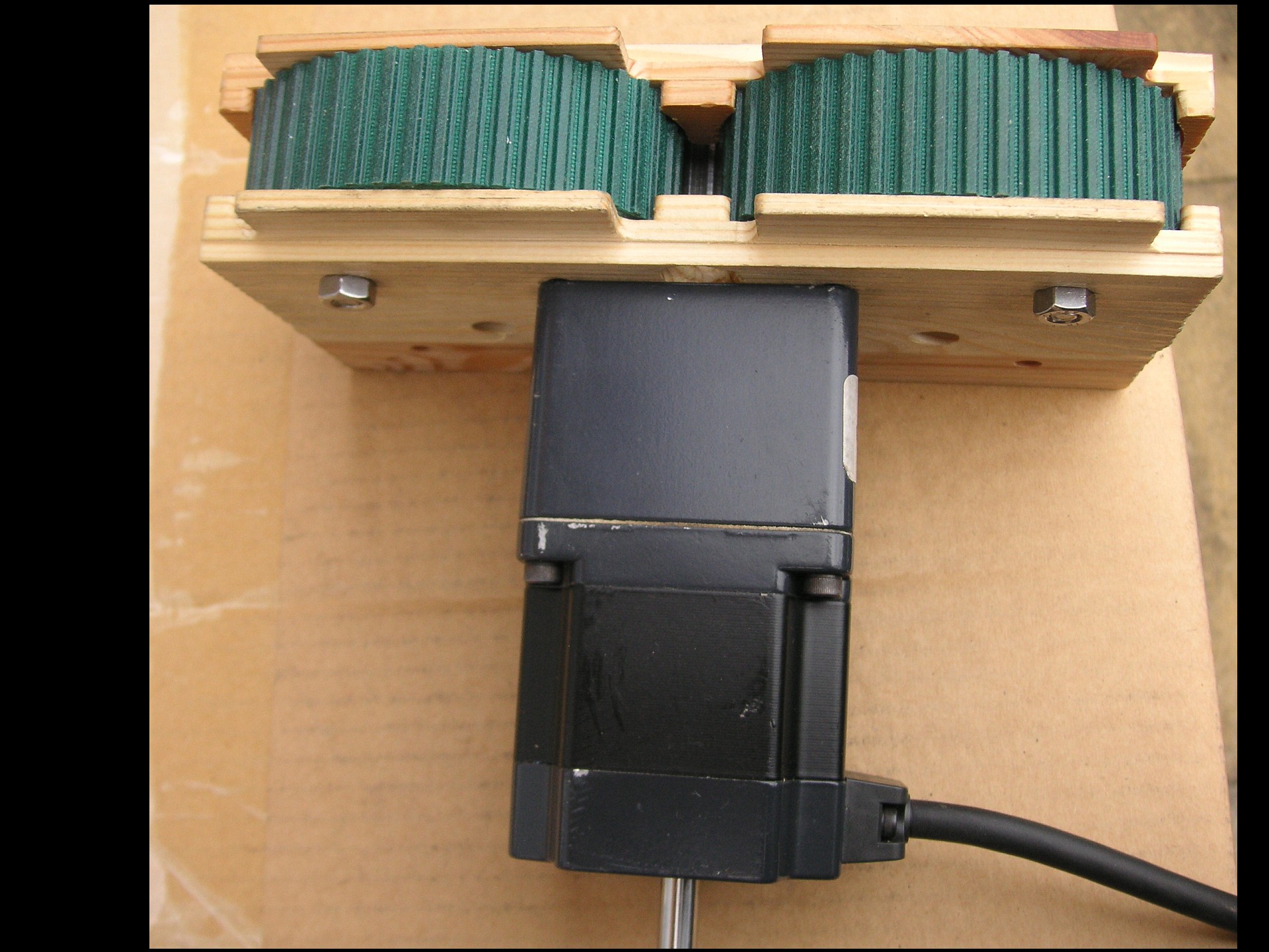

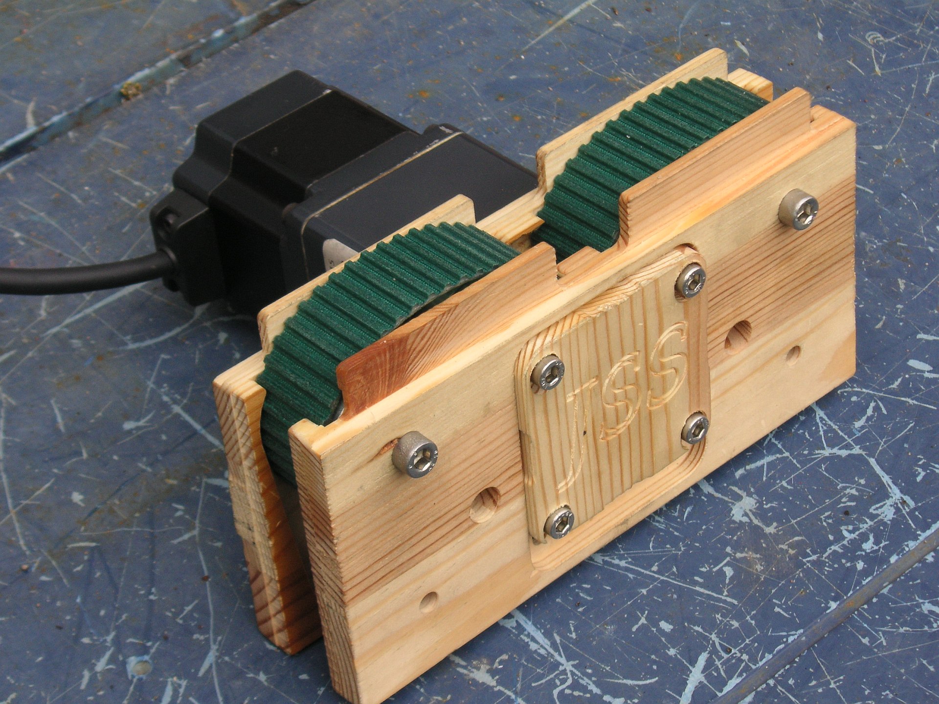

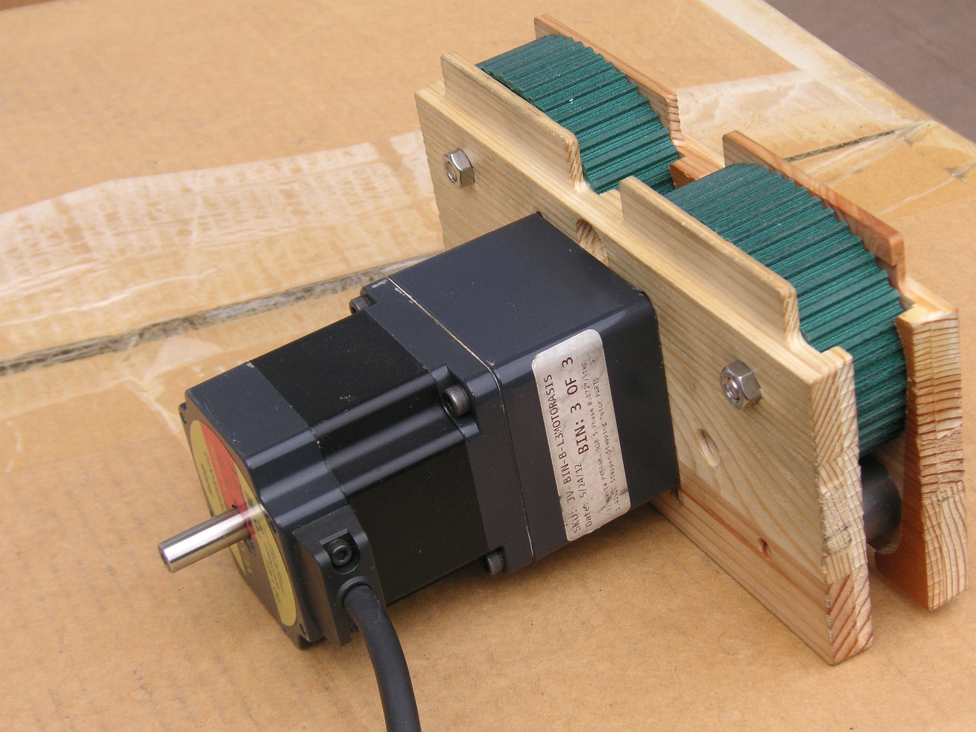

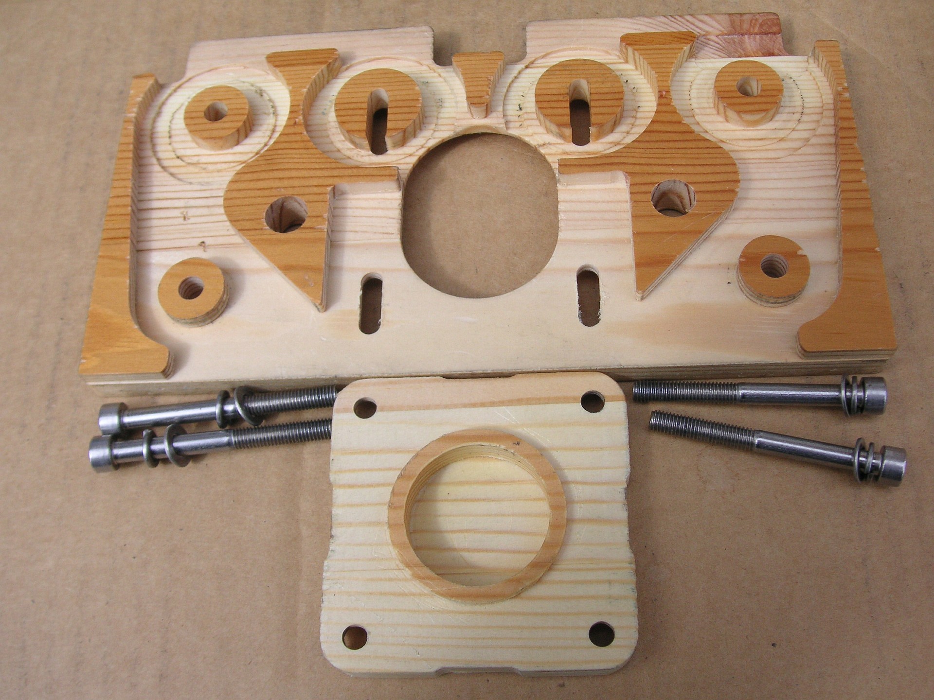

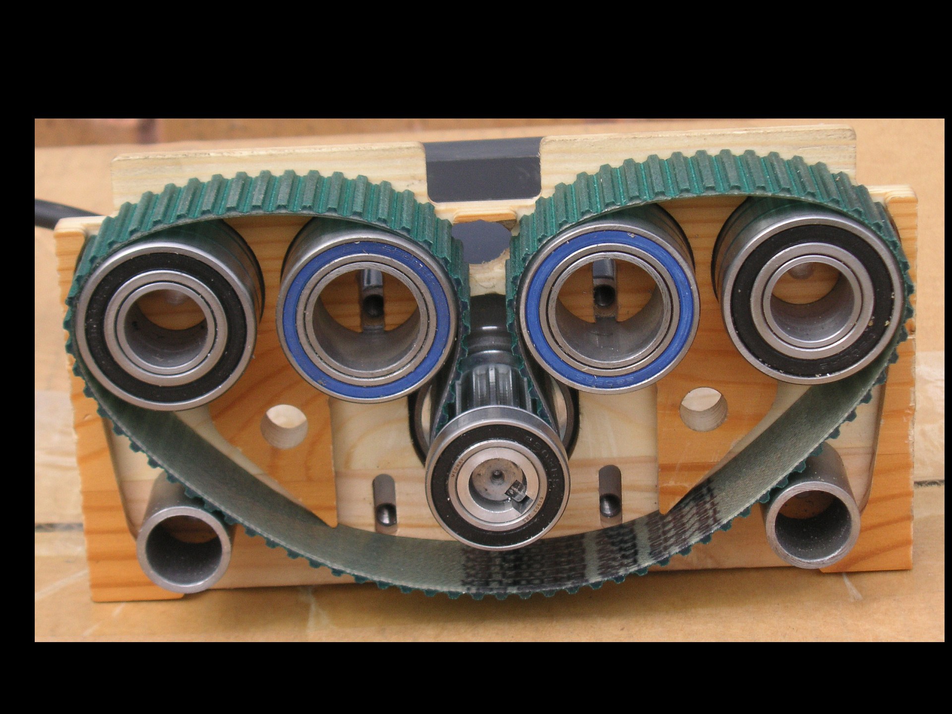

    Have been planning a moving table router and wanted to try a Servobelt design. I had some Vexta 5 phase motors with 10-1 low backlash gearboxes which I wanted to use. Wanted a sort of modular self contained drive that I could bolt onto the frame, I shall be using a dual drive and will sync the drives with a shaft between the motors.
    The std. 37mm OD bearings are assembled on steel tubes for alignment, they act as spacers for the side frames and are clamped together by the mounting bolts
    The engagement with the belt on the table, is set by the outer bolts in the chassis having slotted holes in the frame. The belt tension is set by moving the motor in the slotted holes in the chassis plates, also carries an outrigger bearing for the 18 tooth pinion.
    I have carved a setup out of wood before I waste any aluminum
