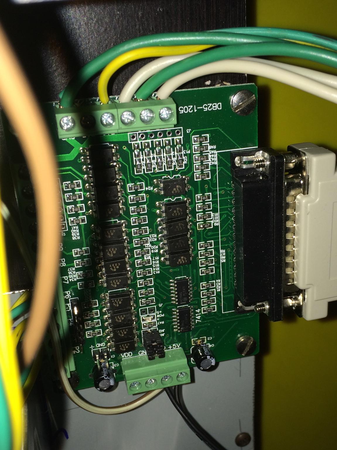

    For some reason the thank you message did not go through so here it is - Thank You for that information. You have explained it well. The next problem I am having is setting up Mach3 Ports and Pins "Motor Outputs". The simplest way to ask this question is: Is there a way to determine which pin is motor and which pin is direction for each motor? What is printed on the breakout board is as follows:
    Pin Label
    2 Dir + X
    3 Dir - X
    4 Dir + Y
    5 Dir - Y
    6 Dir + Z
    7 Dir - Z
    I have assumed the "+" is the "Step Pin#" and the "-" is the "Dir Pin#".
    (again Thank You All for listening to the ramblings of this old man)
  9. #29
    Ok well you should have Dir and Step + & - for each axis. Or at least Dir & Step plus one more connection for either ground or 5V (often marked Vcc) depending on the connection type you choose on the drive. common Anode(NPN) or Common Cathode(PNP).
    What BOB and Drive are you using.? I'll take a look for you.
  10. #30

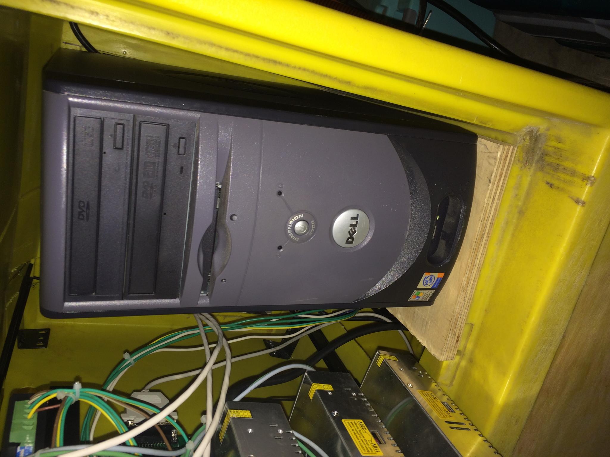

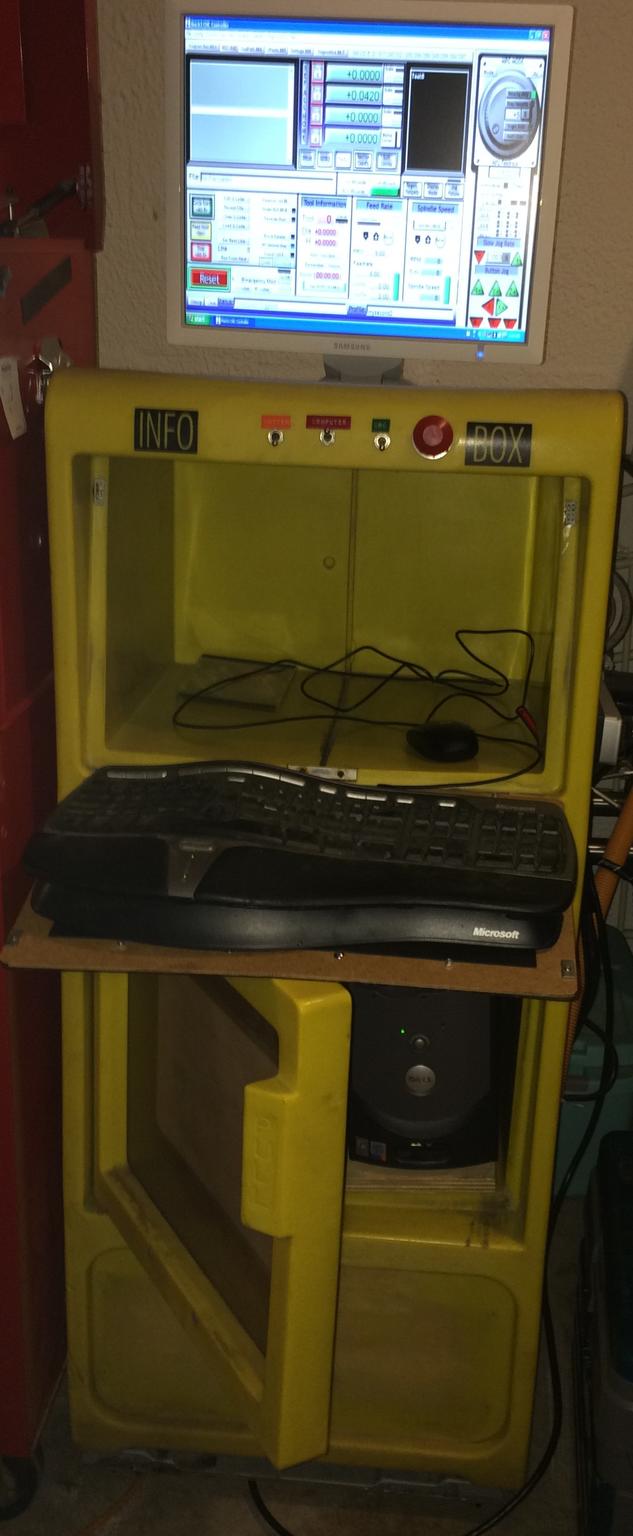

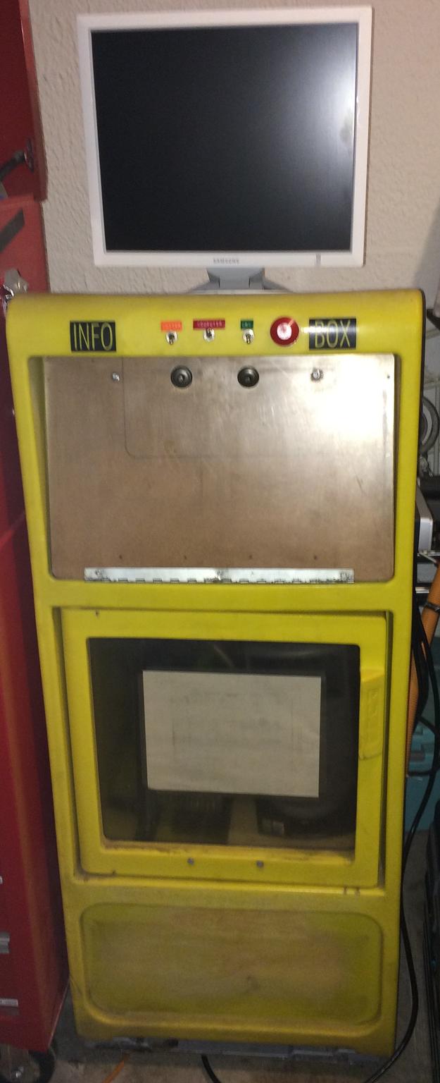

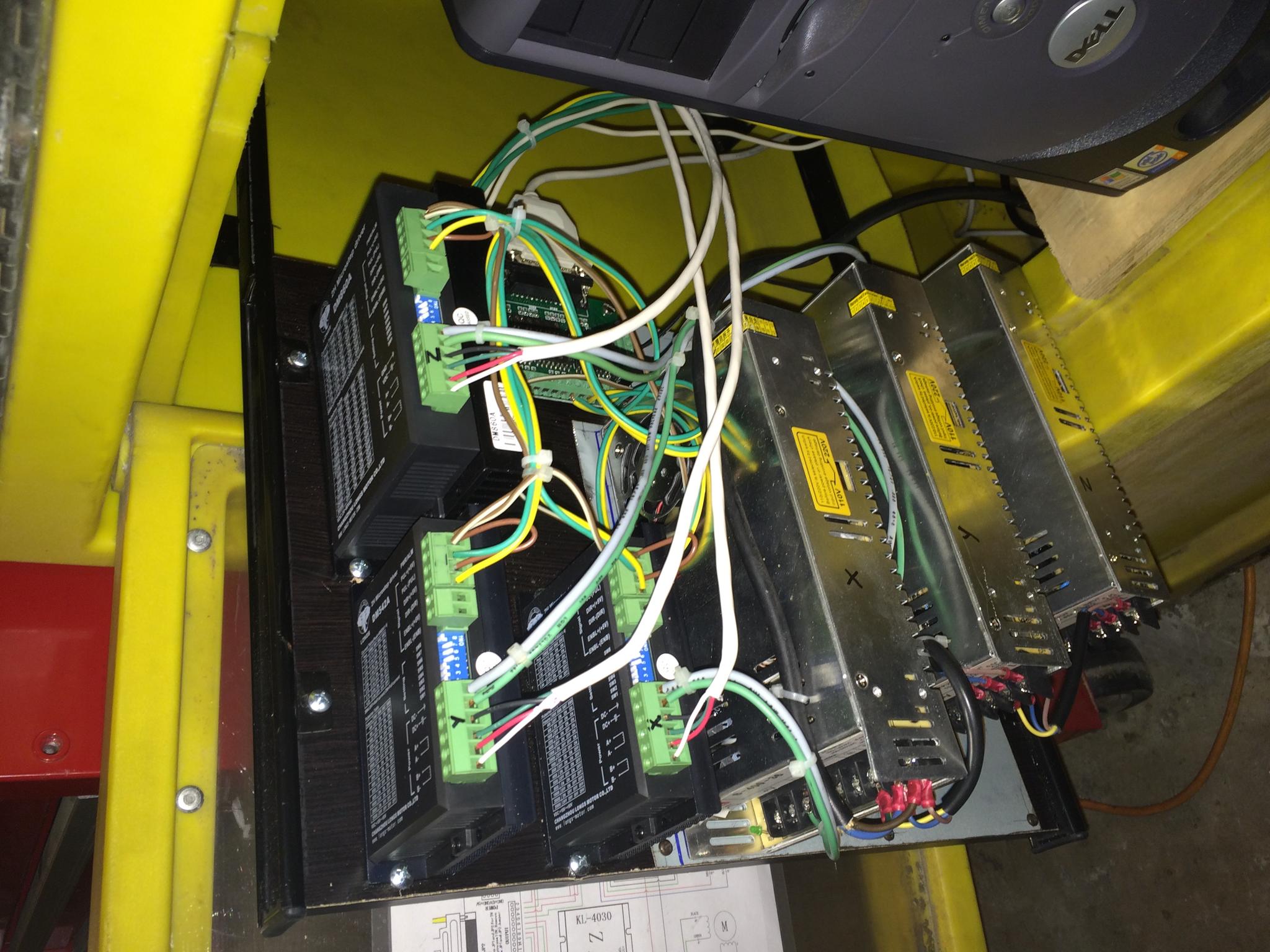

    OK if this worked you see what i call the brains of my CNC machine: pic1 is in it's sleep mode - pic2 working state - pic3 is the Dell computer - pic4 is the slide out that holds the power supplies, CNC stepper controllers , and the breakout board - pic5 is the breakout board.
