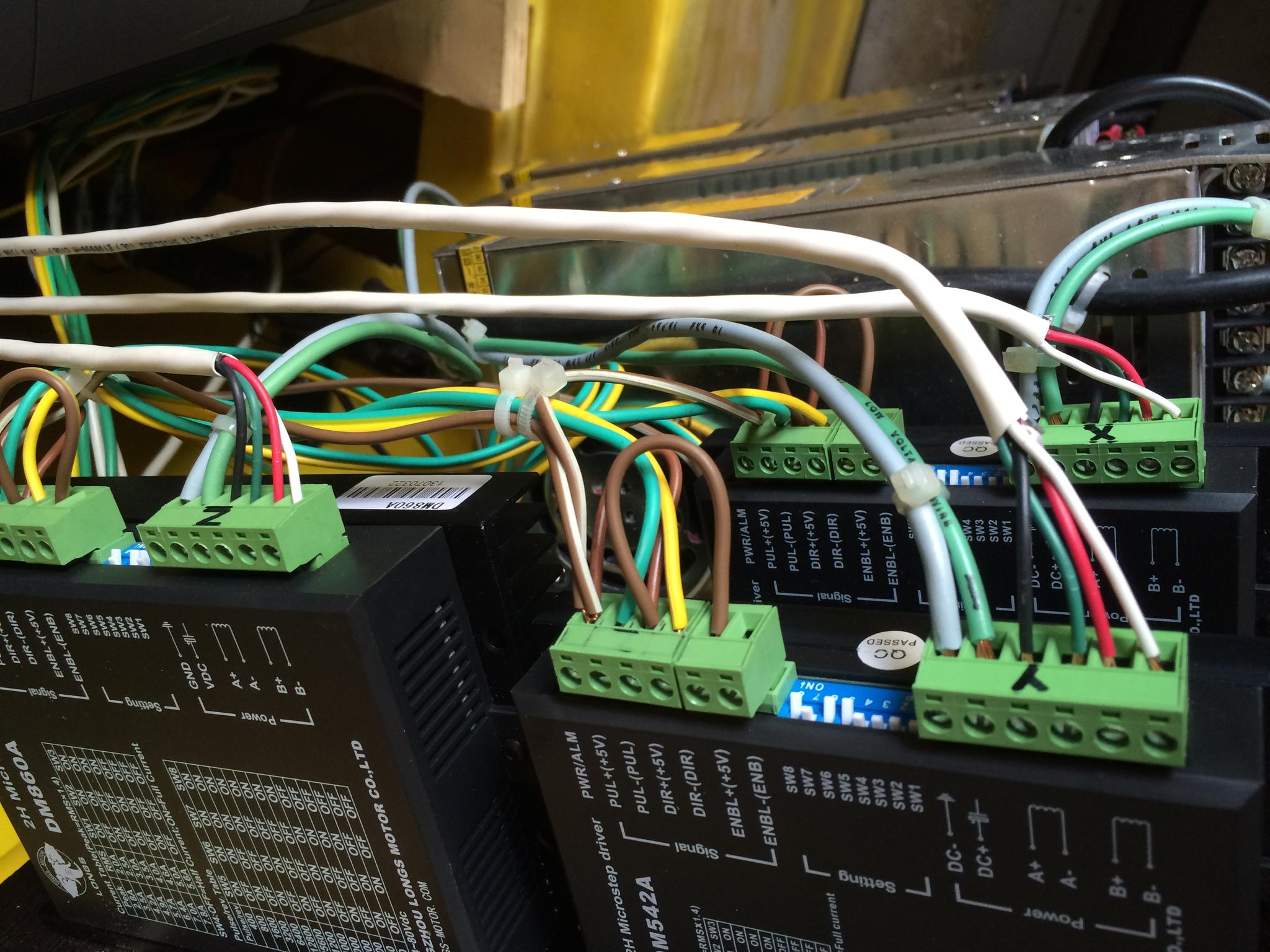

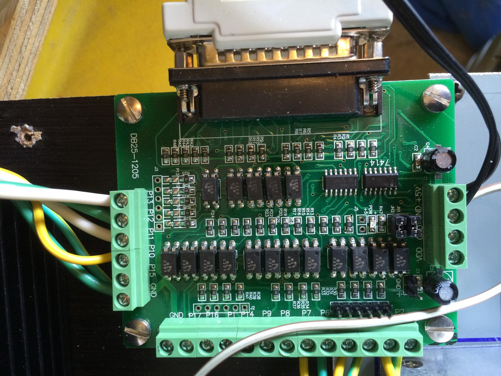

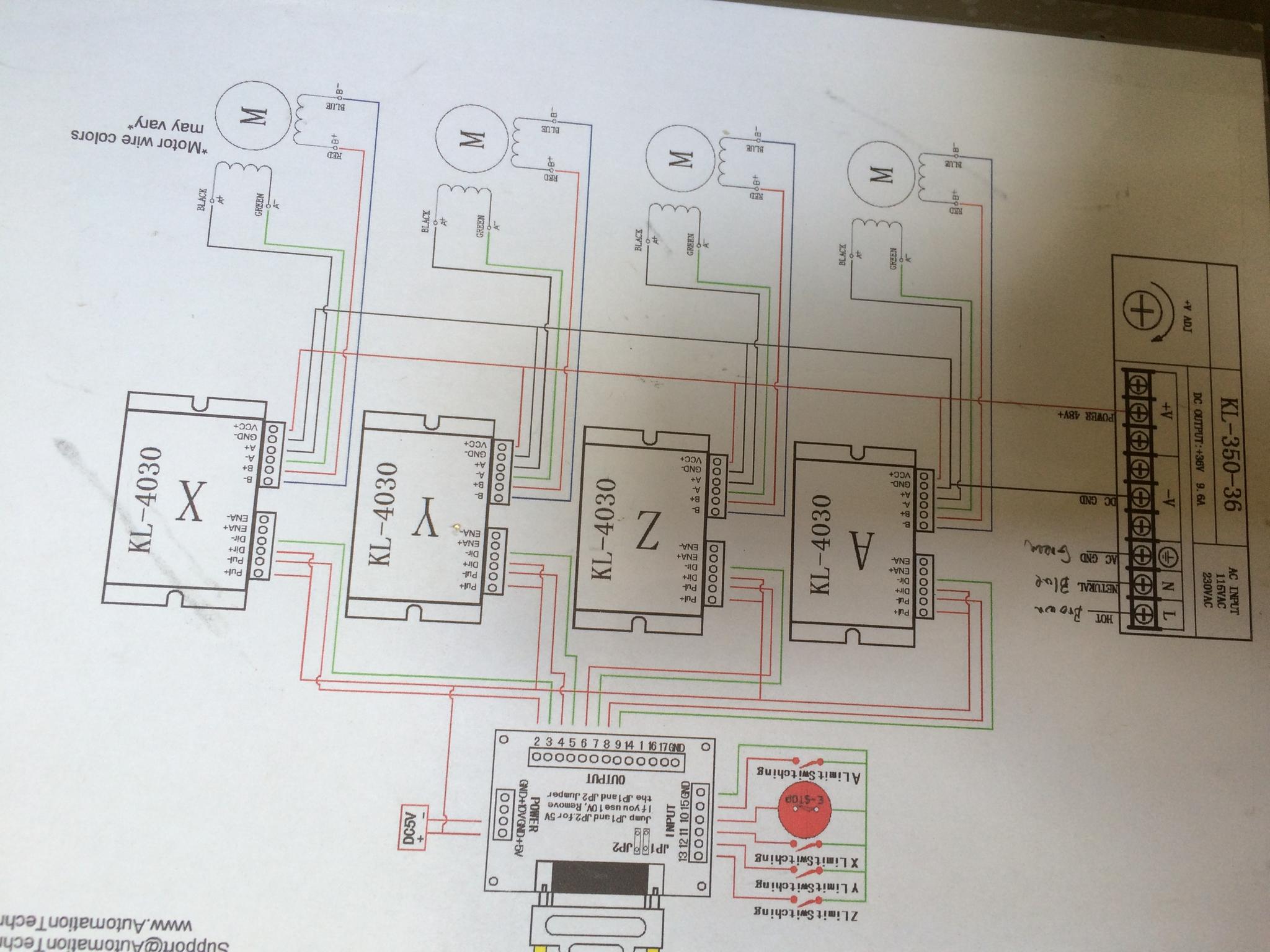

  3. #33
    If you look close at pics 4&5 you will see a brown wire with a white stripe on one side (looks almost like a white wire) going from the 5vdc+ on the breakout board to the PUL+ and a jumper from PUL+ to Dir+ on each controllers. I have put a volt meter on all three and they all have 5vdc power. I also checked all three power supplies and they all have the proper power output. I rechecked all connections and wires to be sure they are all in the proper places.

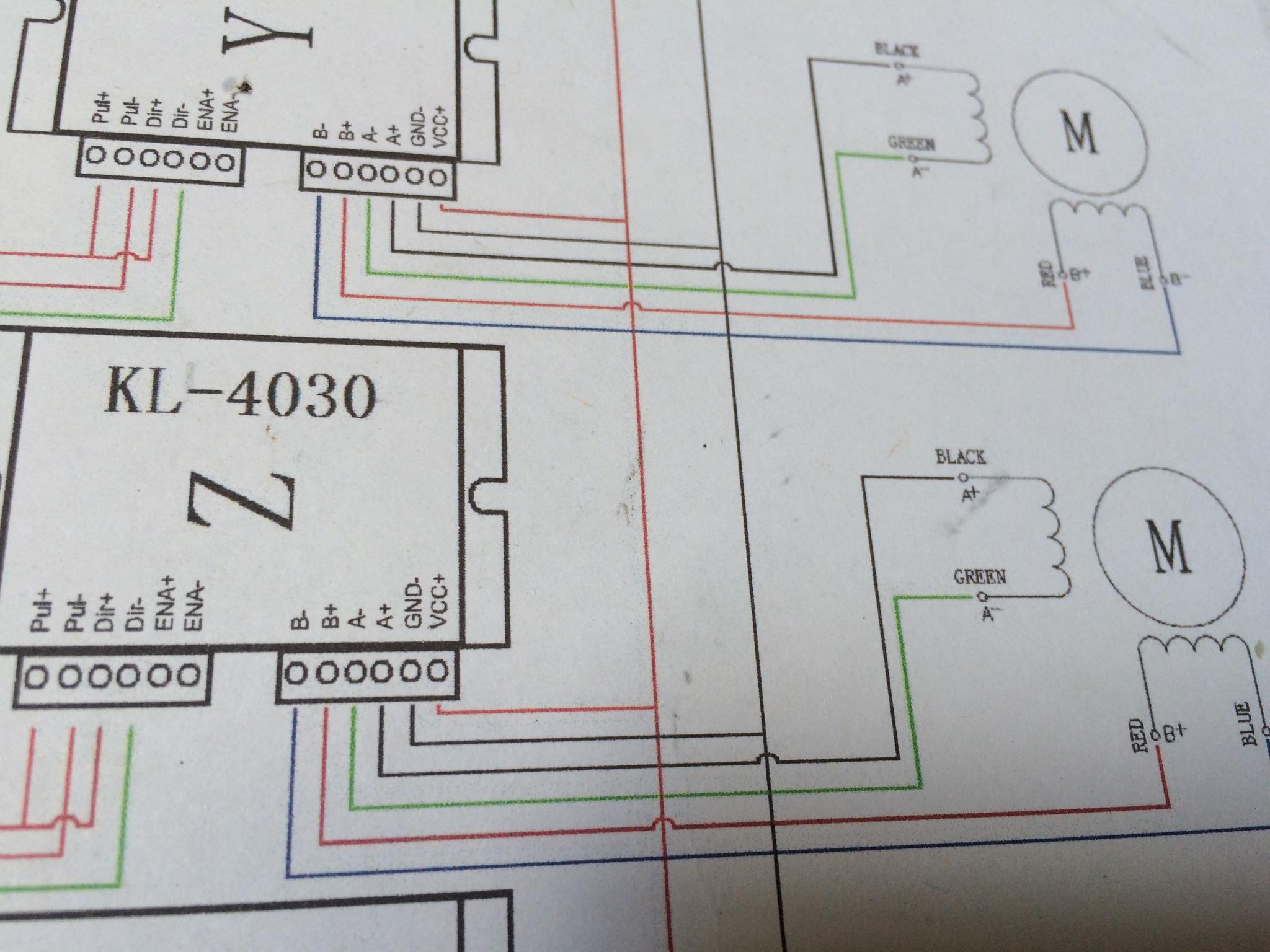

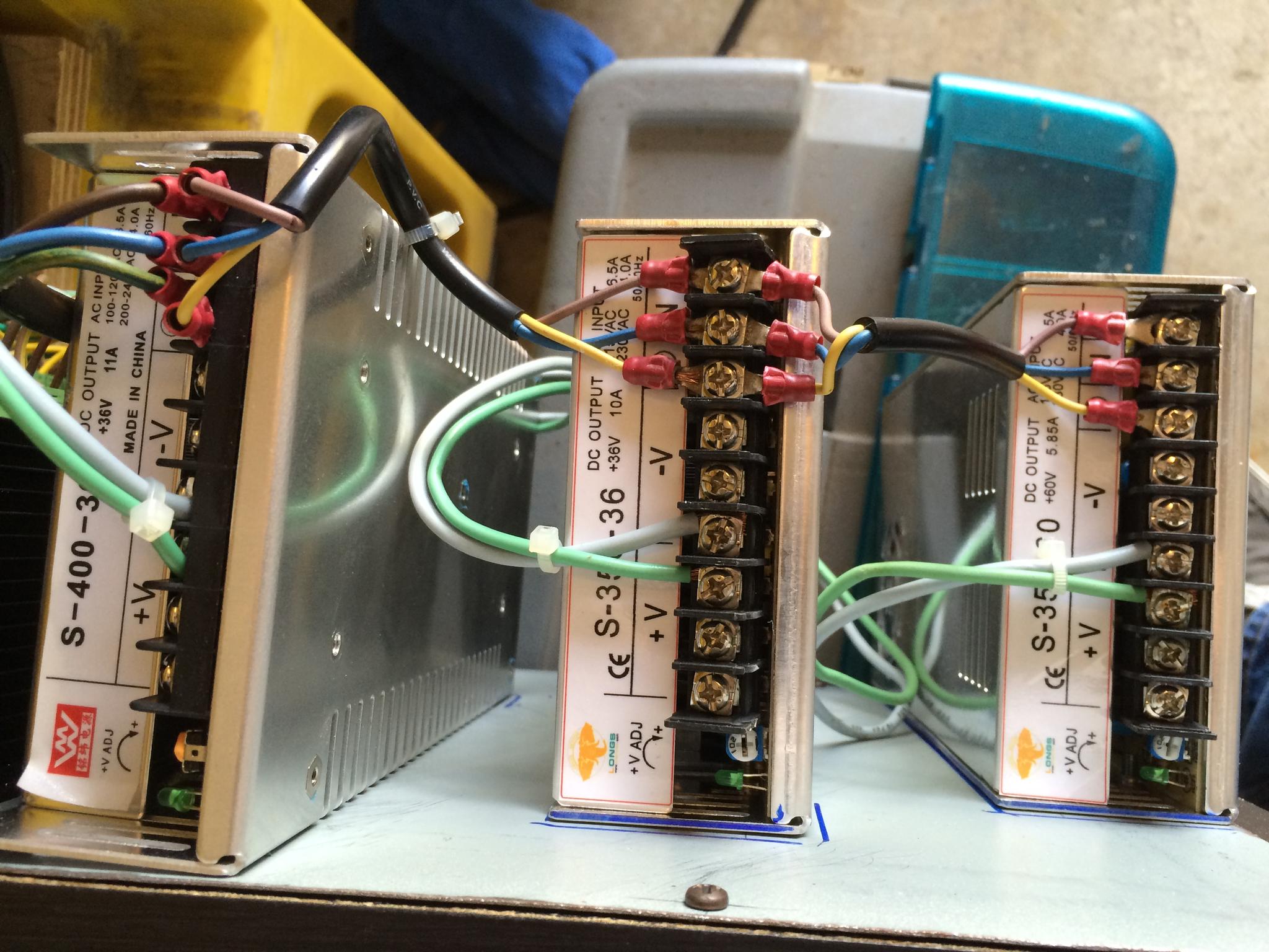

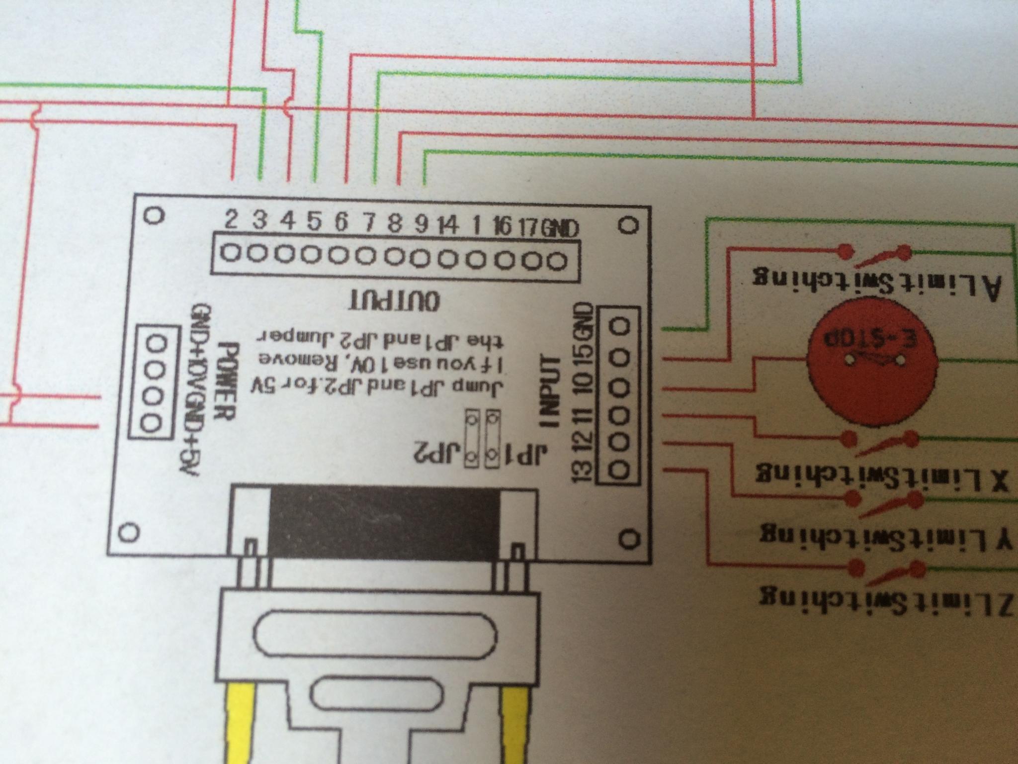

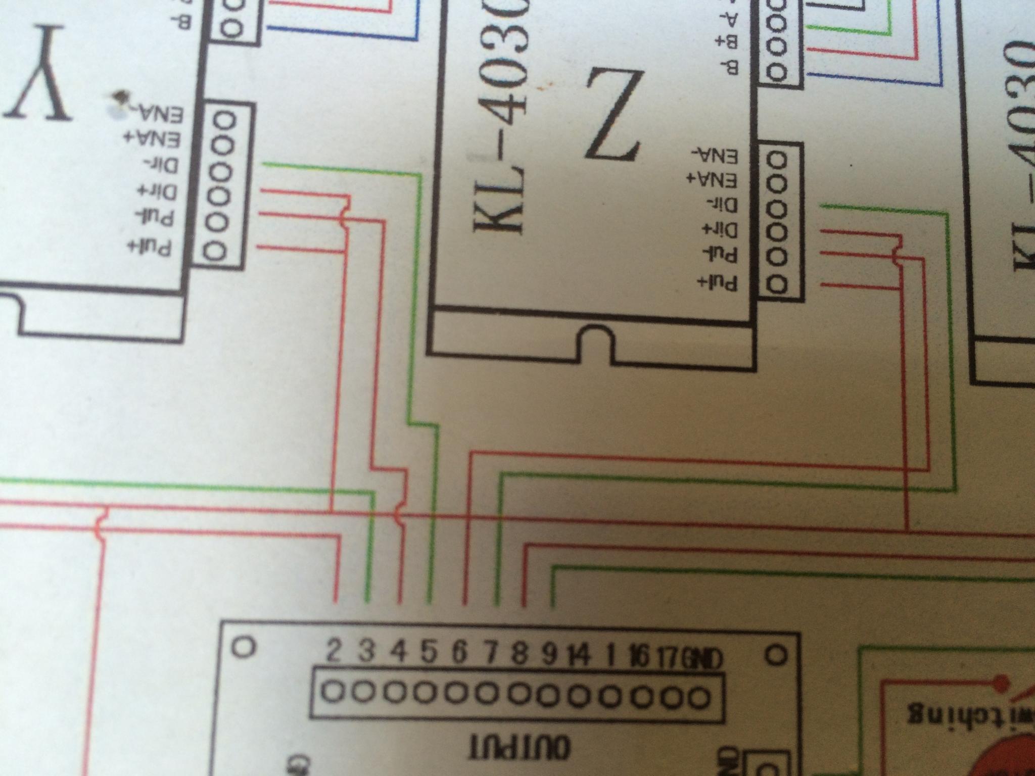

  8. #38
    PART !:
    all of the limit switches work and the E-stop works. I have no motor control - i will attempt to explain how everything is connected and show pictures - maybe i'm missing something. the schematics i used to wire everything is pic-1, 2, 3 and 4 (exception is there is a power supply for each motor driver)

    Looking at the bob where the 5V power is connected does it need 5V connecting to the VDD terminal ? ..Clive
  10. #40
    Remove the wire going to the Enable on the drives you don't need that. This won't be your problem as it's not going to ground but still remove it.
    Other than that it looks correctly wired. So if your still not getting any motor movement then you must have the control software set wrong.
    The VDD Clive mentions is if you use 10V I think and you have to change a jumper on the board if using 10V.
    One more thing is take off the tie wrap cable ties. It's not a good idea to strap signal wires together with power wires as you'll get cross contamination on the signals from EMF electrical noise.
    Also if the wire your using for the motors isn't shielded and the shield correctly grounded then you could end up with problems from electrical noise causeing false e-stops or worse missed steps etc.
    Show some screen shots of how you set the Motor outputs in control software.
