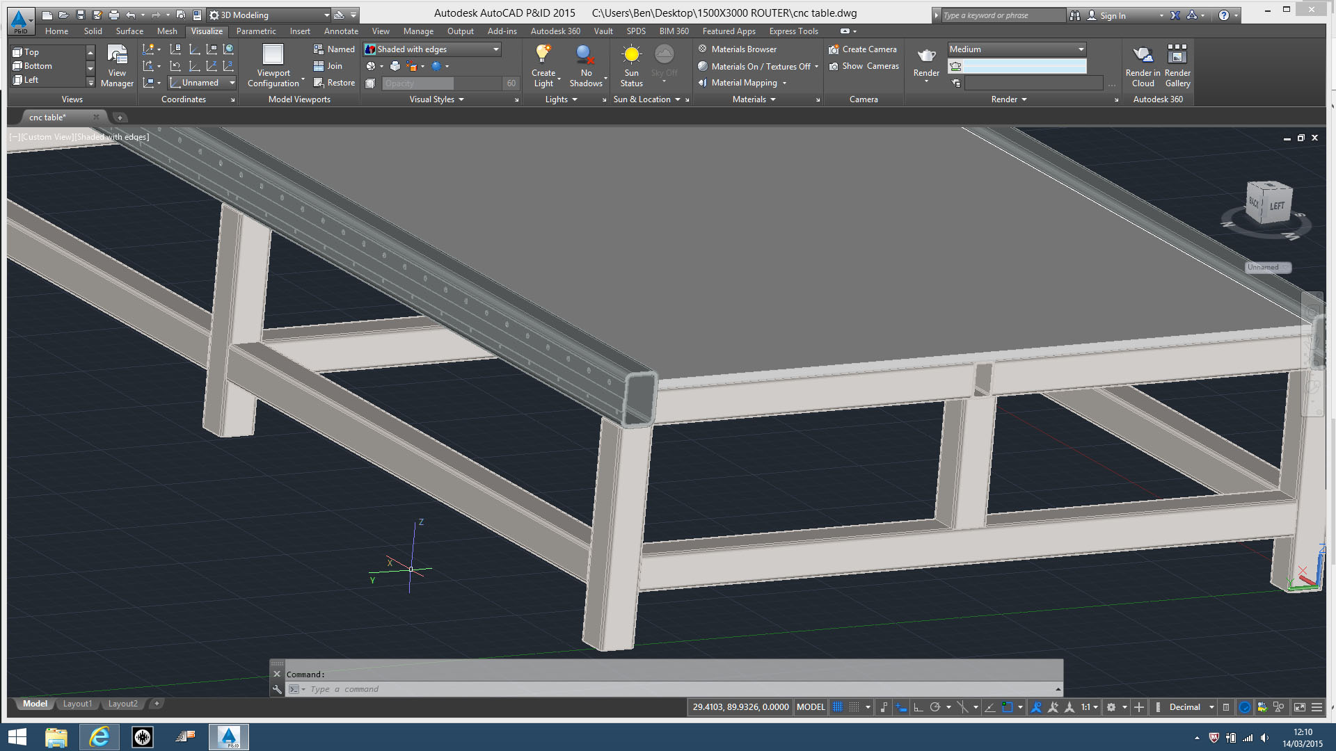

  4. Thanks Clive, cad is the easy bit for me lol, I have a reasonable budget, im not looking for bare bones cheap, as this will be used for production. from a design point, the table is not a big issue to design, ive read a lot of very helpful threads and different views, which were all very informative. One thing that puzzles me is the way to go in options for movement of parts, ive read a fair few threads in regards to ball screw single and double motor options, belts, gears etc but not many seem to use rack and pinion, on a few machines (non diy) a lot opt for rack and pinion. is this due to complexity's to build, or just ott. Which would best suit my needs for a wood cutting cnc, Mainly Baltic birch ply. simple sheets cutting and rebating to a depth of 5mm.... Im looking for a quick machine, full 3d carving etc I would like to have a go, but my main use is for the machine to help speed up, what I currently do, which is build and design speaker cabinets, the occasional logos route'd into boxes etc..
  5. Hi guys, ok after a bit more research, ive come up with 3 options,
    buy second hand
    import a new machine (china)
    or go and build some thing....
    below is a very ruff cad drawing of what im thinking of...
    not a detailed drawing but a ruff design.
Name:	cnc bed1.jpeg

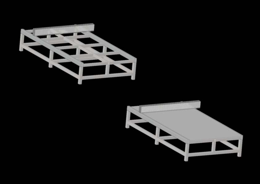

  6. hi-win rails, and rack and pinion drive.
Name:	cnc bed2.jpeg

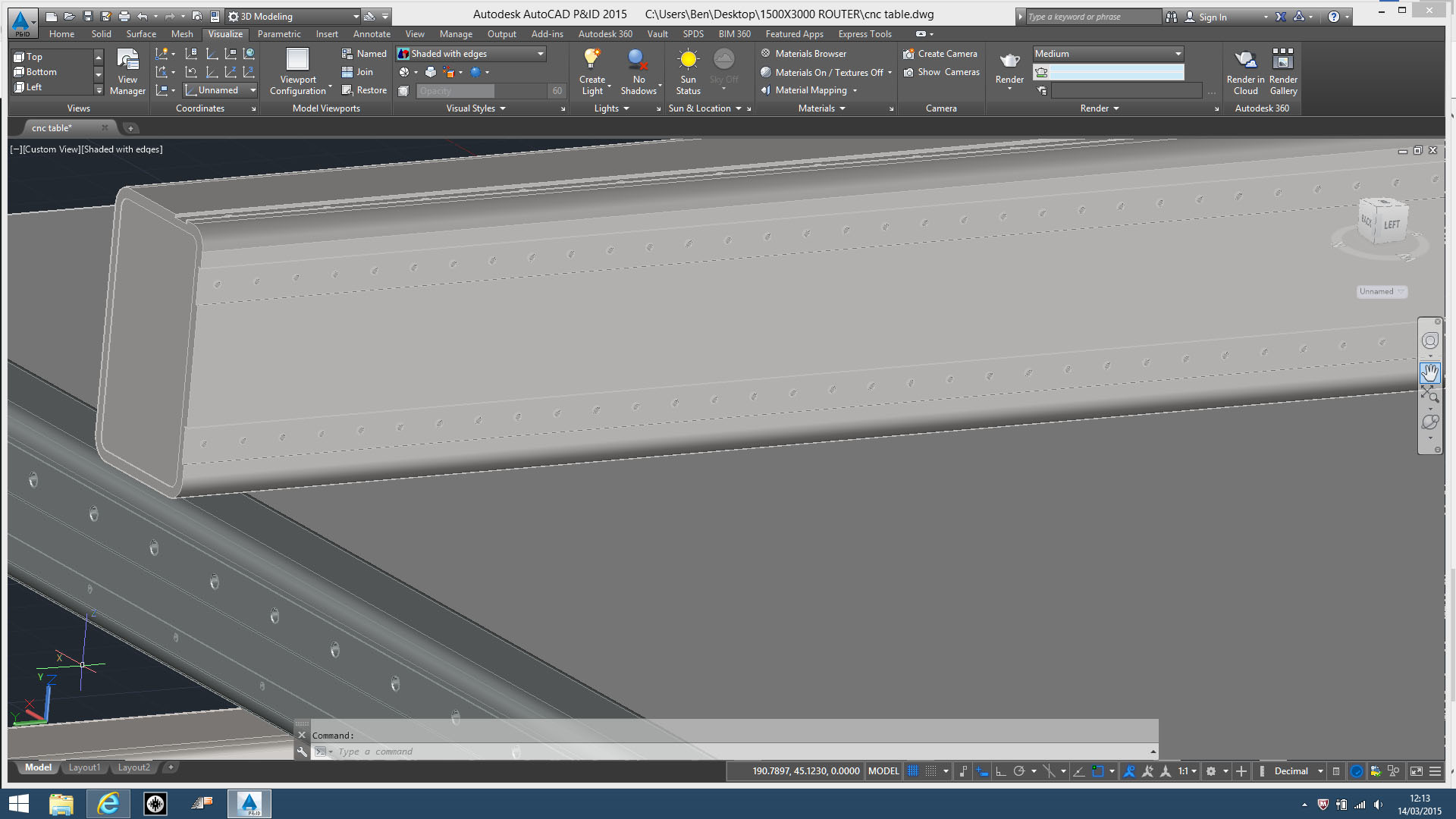

  7. again 2 x hi-win rails with rack and pinion
Name:	cnc bed3.jpeg

    Hi Ben, welcome to the forum. If you have access to a decent 3 phase supply, I think that you could do a lot worse than look for a reasonably priced used commercial machine. Many of this type of machine will have a vacuum bed and a tool change facility and are very robust. Good luck with whatever you decide. G.
  9. I only have single power, I can wire into the fuse board, giving 32 amps or 64amps, the cable to my workshop from my house is rated at 64 amps.... this rules out a fair few commercial machines. The space for a bigger commercial machine is also an issue. max height is 2.2 meters and not much bigger than the drawing above 3 meters by 1.5..

    Hi Ben
    It would help if you put some dimensions on your drawing. Some vac pumps are quite big Hp I believe. Clive
