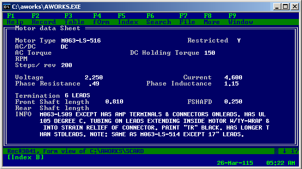

    Superior Electric Slo- Syn Motors Synchronous/Stepping , Type M063-LS-516 , 2.25 volts Dc , 4.6 Amps , Steps/rev 200 Rpm @ 60 Hz ( 6 Pin connection )

    Data sheet for those specific motors
