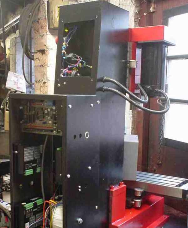

    Yes it does seem to be problematic I have not looked at the clearance yet, I was wondering if I could get away with smaller dia screws as it is only a small machine and I am only going to be using brass ally. have you any pictures of your mill with the mods, I have put some of mine in
    [ame="http://www.mycncuk.com/forums/showthread.php?t=674"]My X1 Build - MYCNCUK[/ame]
    [ame="http://www.youtube.com/watch?v=PNgjPquce8c&feature=channel_page"]YouTube - CNC first run[/ame]
    [ame="http://www.youtube.com/watch?v=vvNn0qE0KJc&feature=channel_page"]YouTube - CNC tests 2[/ame]
    I have the same problem trying to get close to the machine because I am unable to bend very much so I did mine this way it makes it a lot more compact. the handle folds as well.
    Peter
    Nice videos, on the y-axis did you get enough movement as at the maximum rearwards movement puts the front edge of the y-axis past the machine front edge(if you see waht I mean). On mine I have extended the y-axis with an ally plate which covers the ways when the y-axis is in the rearmost position therebye giving the maximum movement.
    I reckon that if I raise the z-axis column I will be able to get a plate on the rear of the y-axis to cover the ways at the column end but it will not leave much metal at the fixing area, so still in the design stage!
    Peter

    We did this to one of the very early X3 conversions
    It was actually a refit from one of the early Simply CNC machines that the guy wasn't happy with.
    Because our kit was made for the later long column machine this one had a spacer fitted to make it the same as the later machines.
    All the moving slides had new oil groves and cross holes drilled and the flip top wick oilers fitted, this takes care of day to day slideway lubrication. Ballscrews are just a weekly splash and dash.
    May give you food for thought ?
