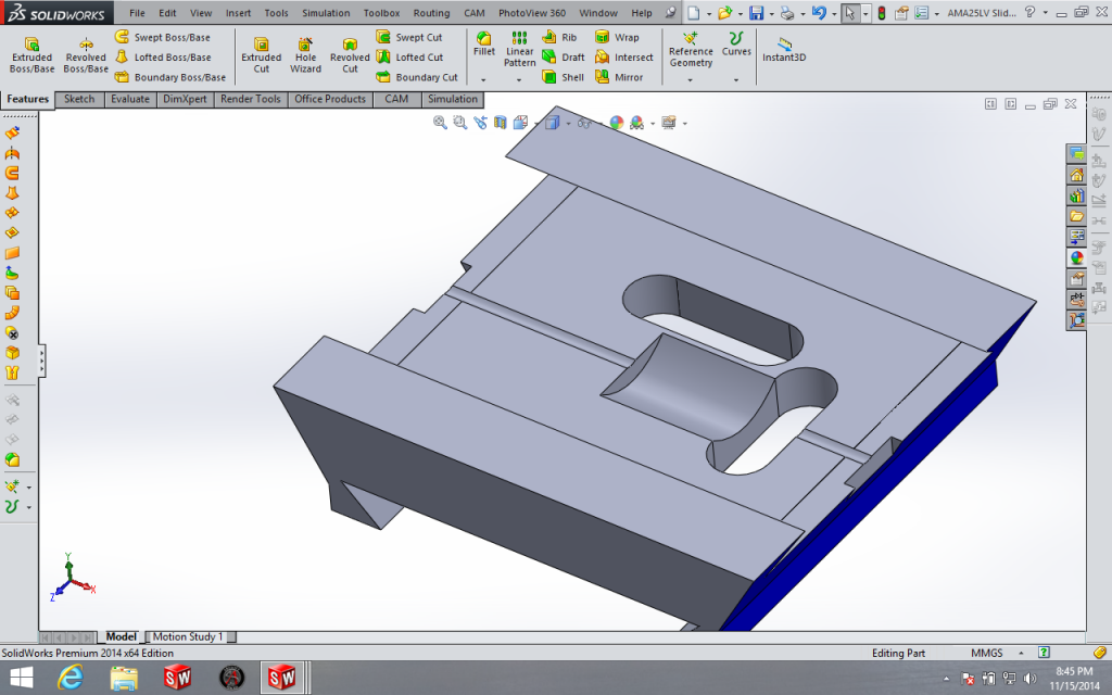

  4. #24
    Is there anybody who sell hardware to convert that mill - LongVersion?
    Looking for ballscrews, mounting plates for: ballscrew, nuts and motors.
    Ideally if handle can remain so can be used as conventional mill.

  6. #26
    Quote Originally Posted by komatias View Post
    I am working on that right now. Two versions in the pipeline, servo and expensive ballscrews, steppers and cheap ballscrews. Both with handles.
    ATV the moment I am designing based on my EMV-25VBB but also have the parts that will allow use on the ama series.
    The trick is not to have to machine the casting and that is what you can expect from my kit
    I understand that kit won't be kind of straight fit, as Y slide have to be machined to fit ballscrew nut.
    My idea of buying such a kit is to do minimum work and fairly quick change over, so kit have to be design and machined to exact mill - AMA25LV.
    I have control box with nema 34 motors and all home/limit switches.
    I decided to use cheap steppers with digital drive rather than servos as this machine is not accurate anyway so no point to spend extra money as I won't gain anything decent.
    Please give mee the quote for mechanical parts:
    brackets/plates
    both ballscrews c5 or c3 and c7
    Tom

  9. #29
    Quote Originally Posted by Tom J View Post
    Nama 34 would be for Z, Nema 24 for X and Y have to calculate
    I was refer to space for ballscrew nut - there is not enough room for even RM16
    Could you upload picture or give the link of your kit please?
    Tom
    Not going to upload just yet to the public, but rest assured the I you will not need to machine the castings.
