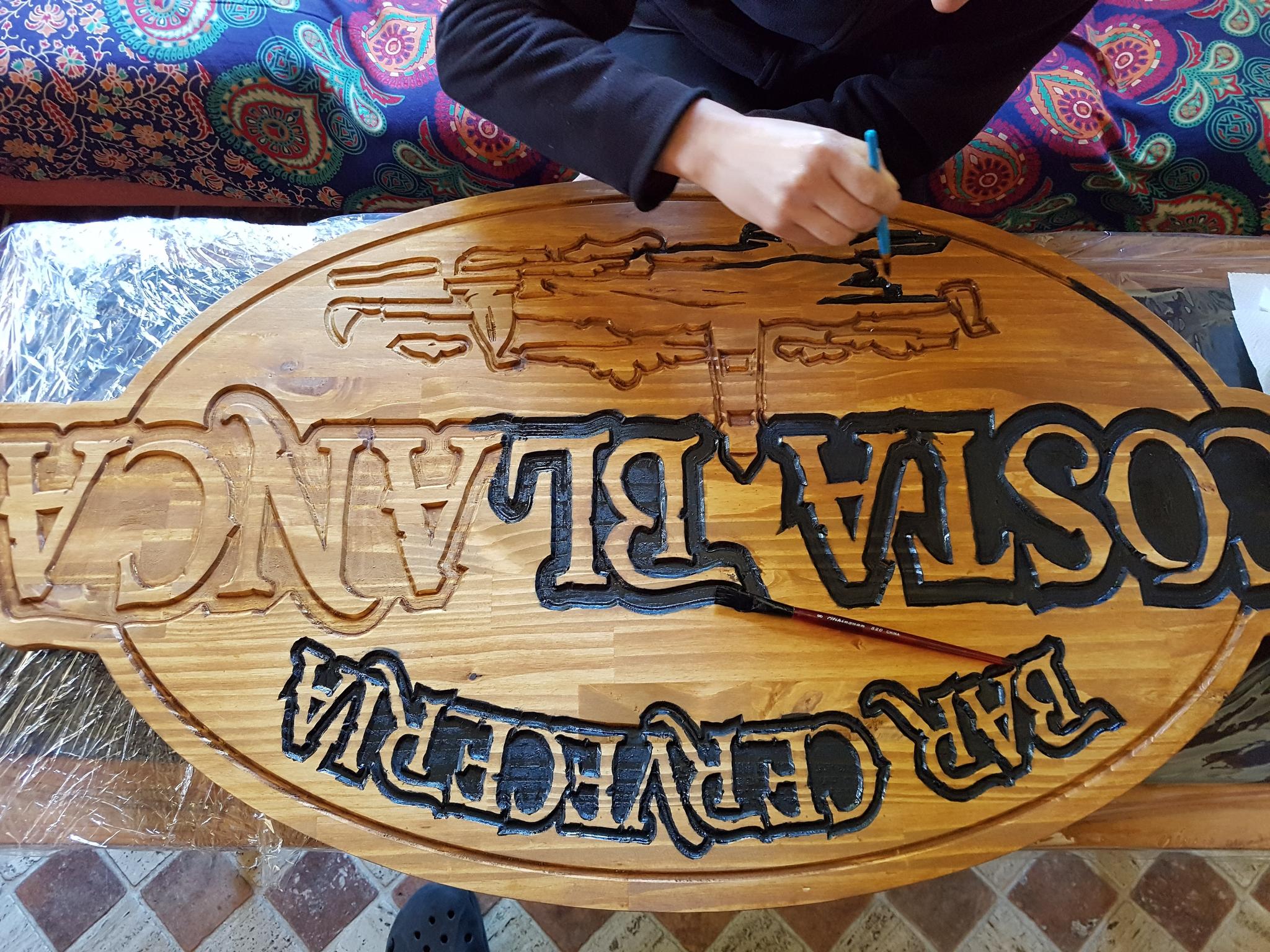

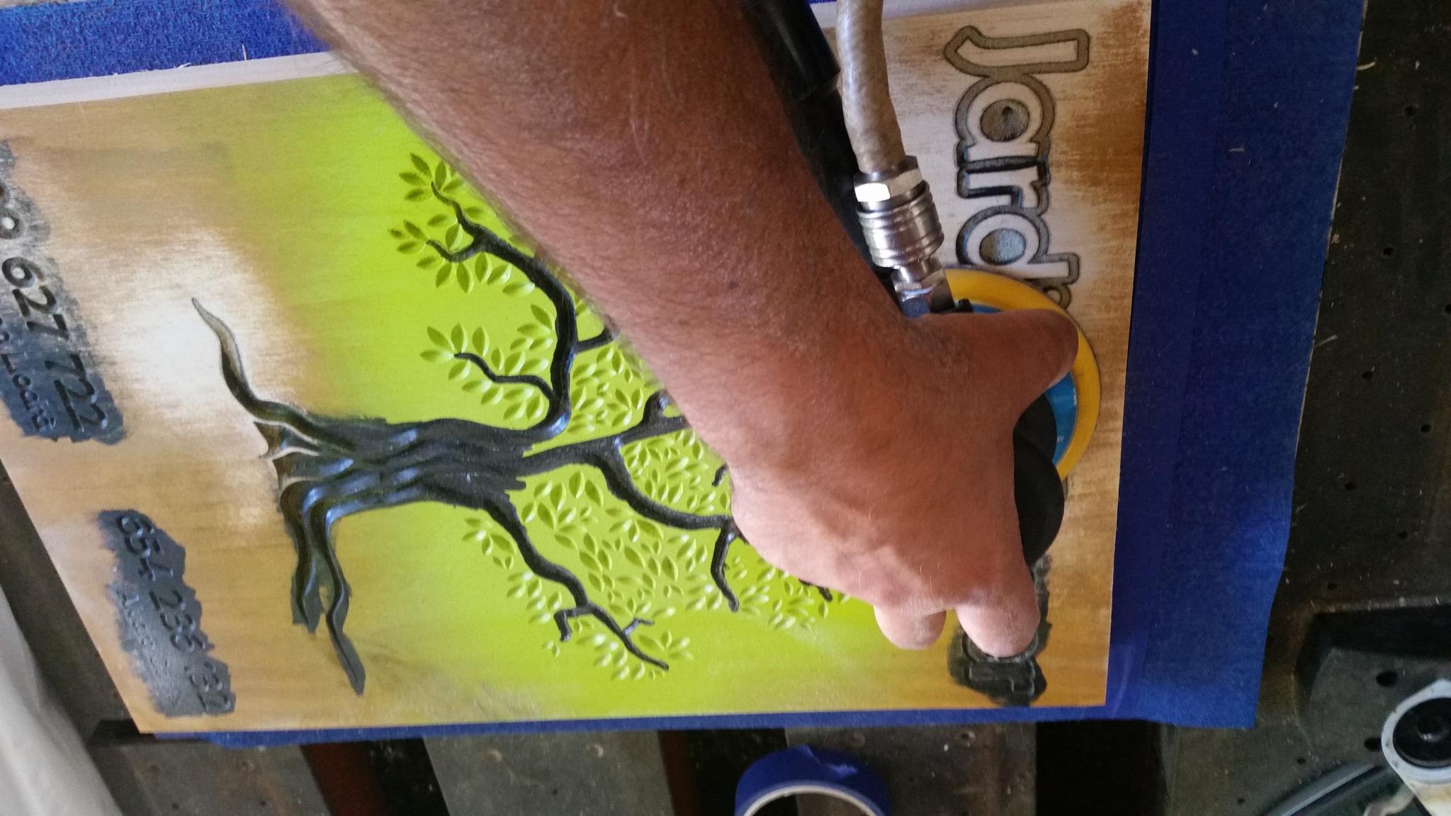

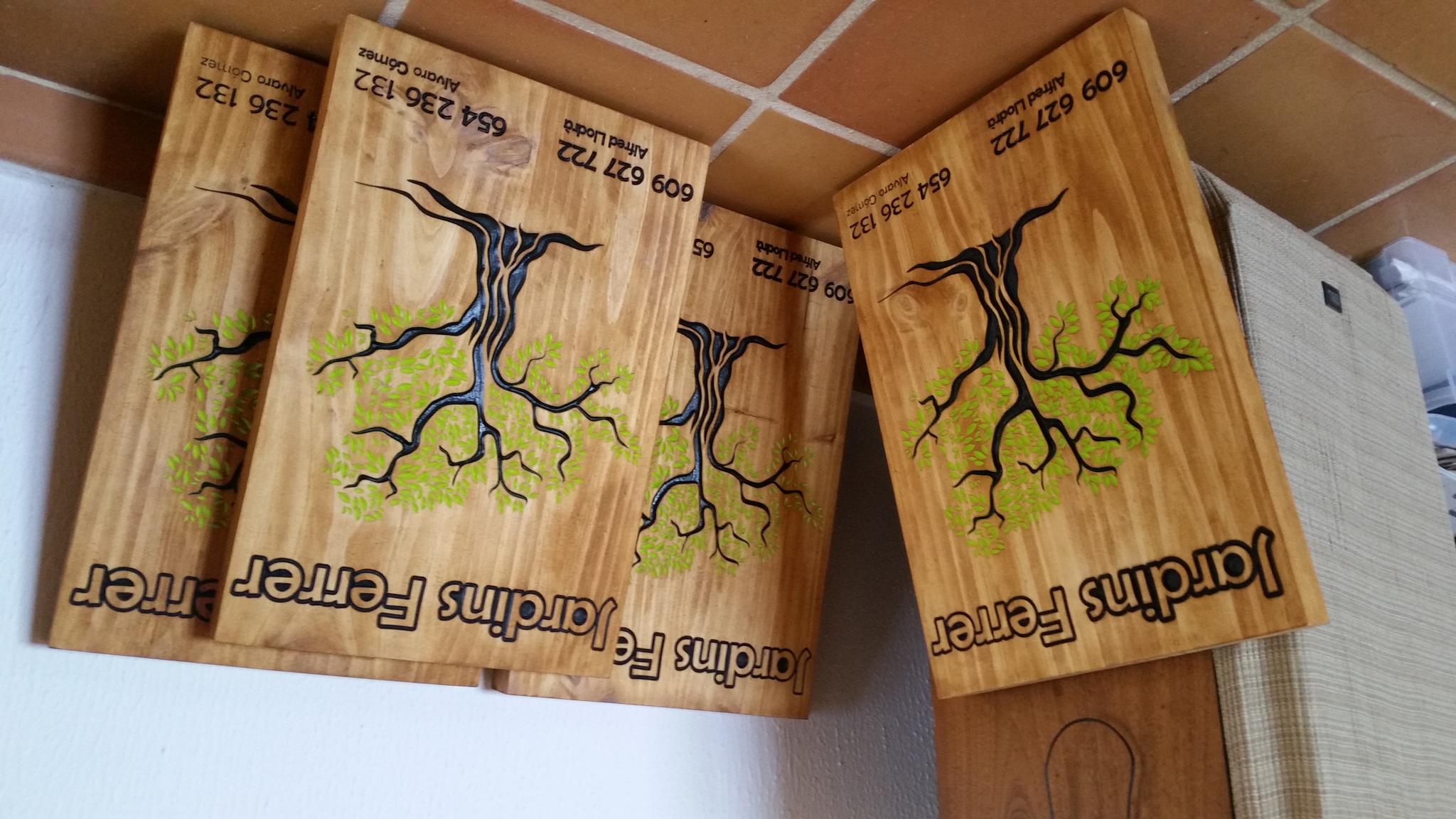

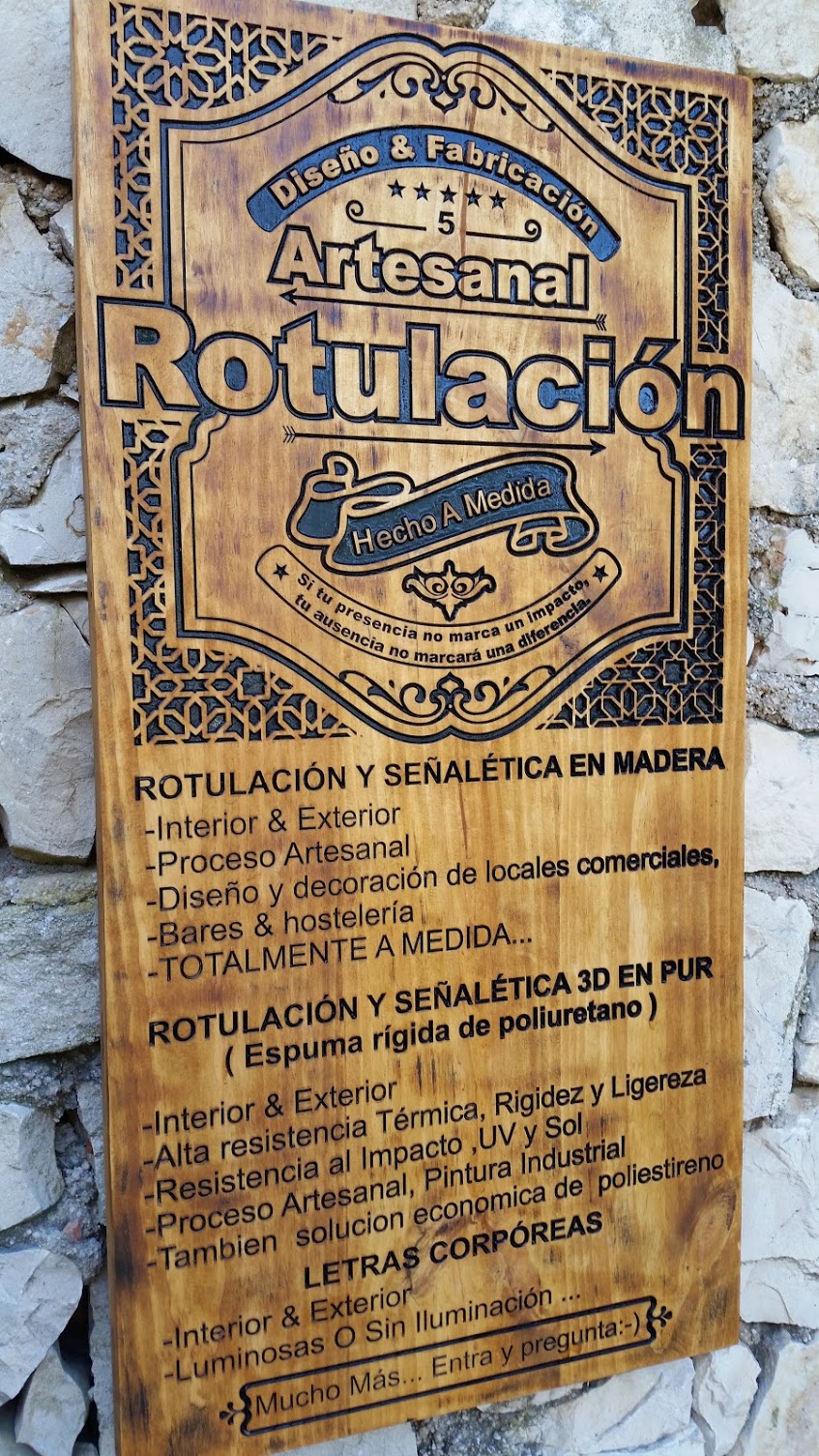

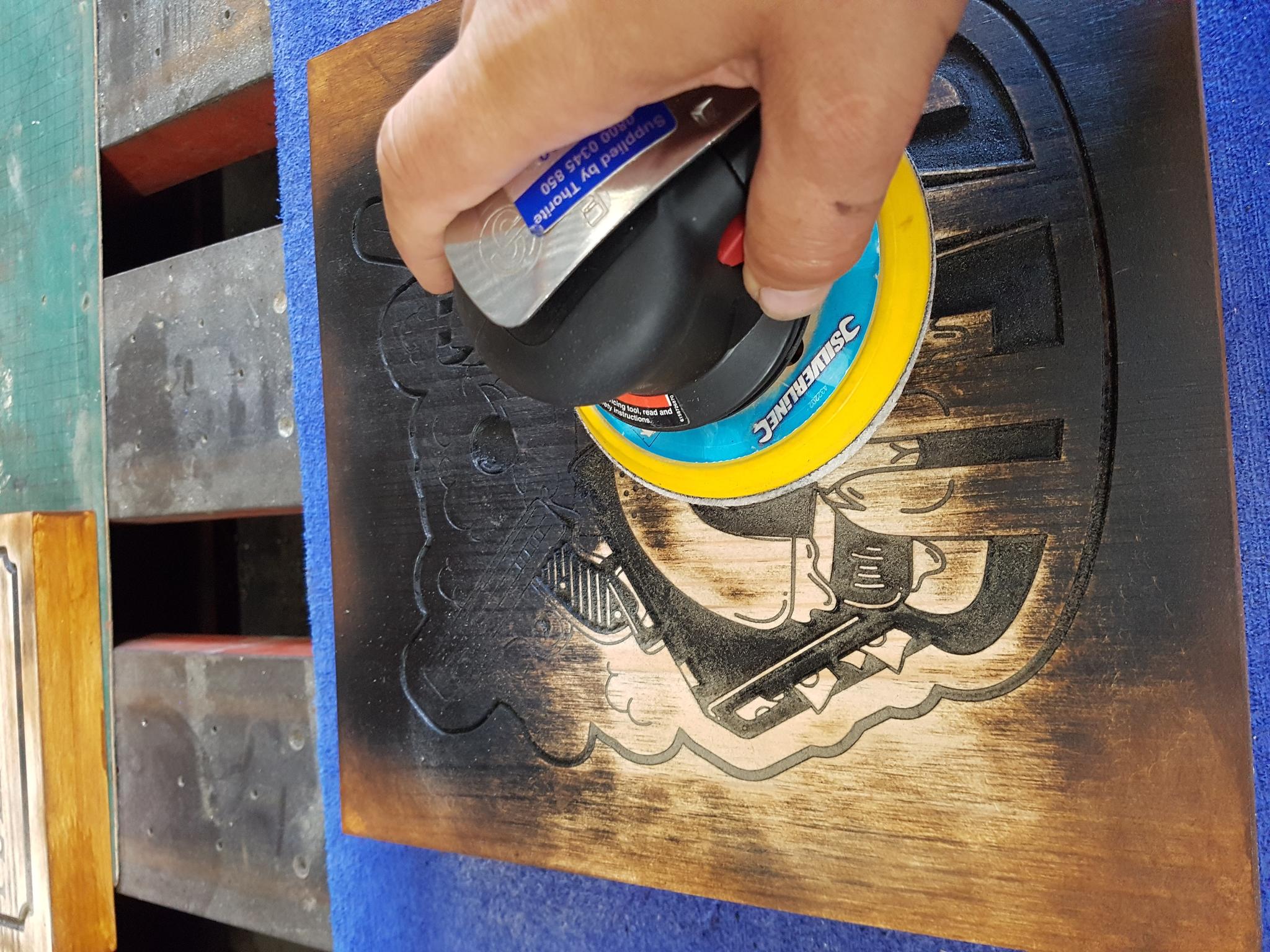

    My first hand painted signs. Not a big deal, but wanted to share.
    a friend recommended me, so more or less i tried to keep the shop design from their web http://laveintinueve.com/shop/

    Looking good Boyan!!
    Neil...
    Build log...here
    looks great, what size tools and speeds/feeds
    Looks great very unique sign. Much better than the generic printed diabond box signs everyone uses today.

    Thanks guys!
    Quote Originally Posted by Blackrat View Post

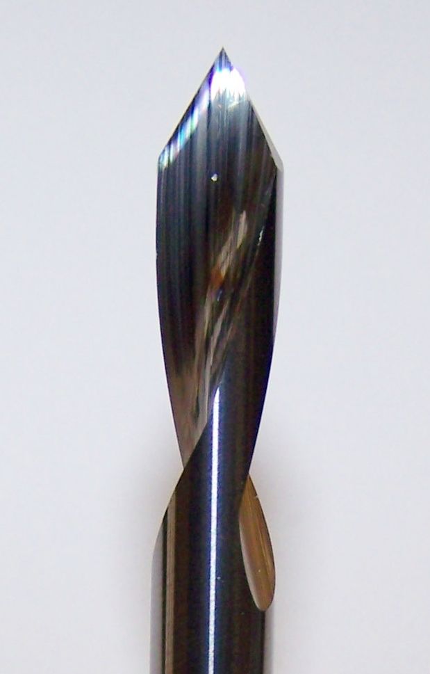

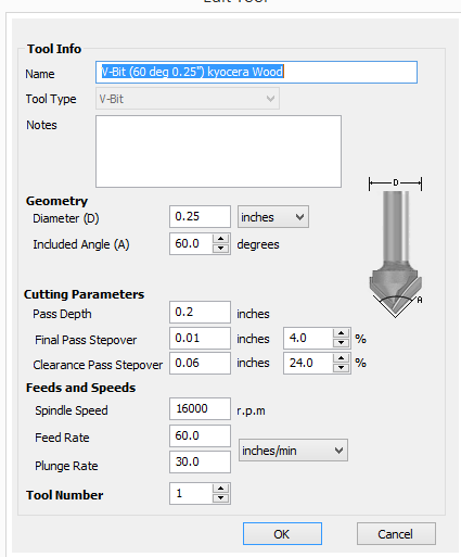

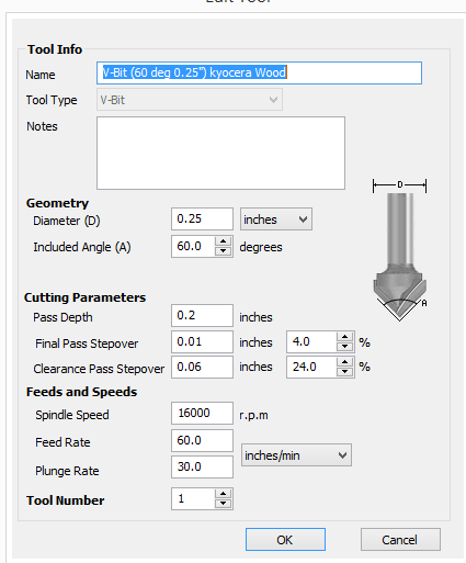

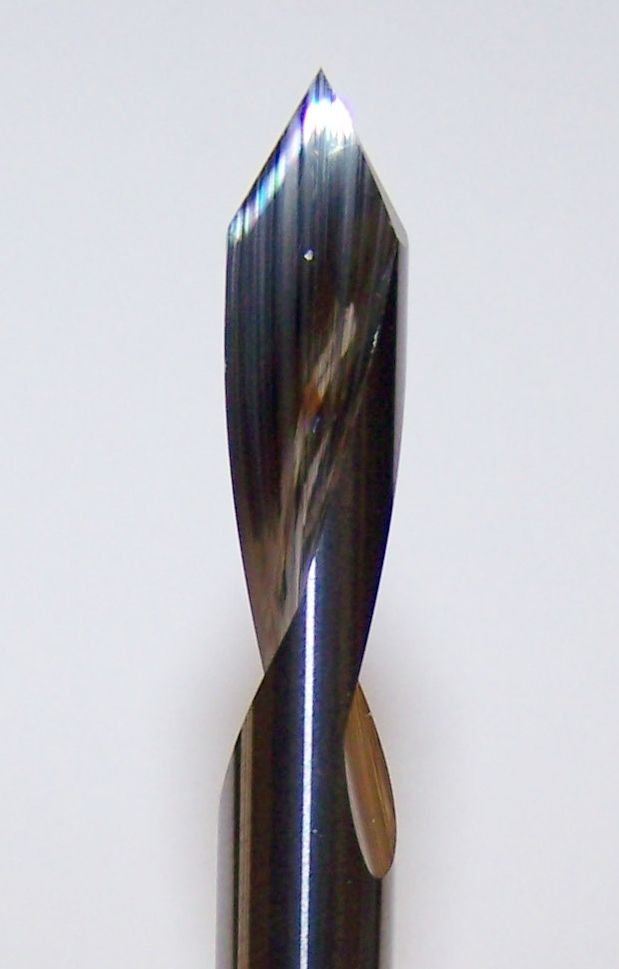

    1/4 V cutter 60 degree, 3mm flat depth. Thats the typical i use for engraving soft, hard wood and phenolic plastic. A balance between fine detail, angle, speed, depth and quality look for thin and thick wood. I could say i have engraved thousand of things from credit card size to 1m signs, from arabesque to mandalas and signs, that works for all.
    I just speed it 17000 for hard wood and 18000 for very hard wood /ipe and ebony/ and slow at half the feed for phenolic. This is not flat V cutter, its a spiral one.
    The profile was done by my favorite 1/4 3 flute straight Kyocera bit at 16000 rpm and 90IPM. i am running short of this one unfortunately, so have to search from where to buy more, cause Drillman1 sells overstock so not always has what i like.
    The pictures dont do justice to the perfectly polished bits that last much more than say Freud or similar.

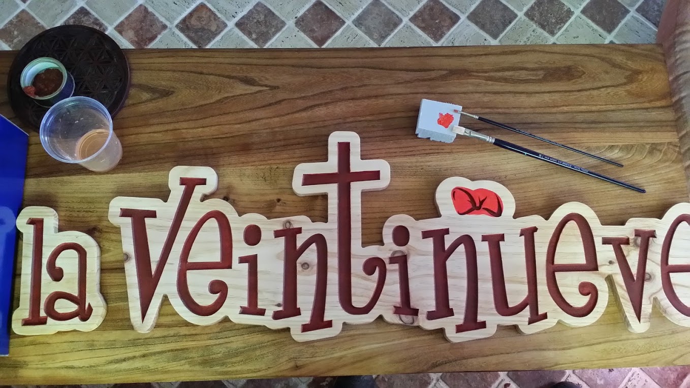

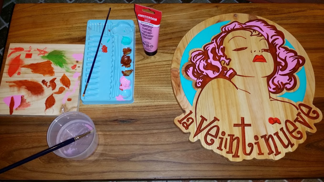

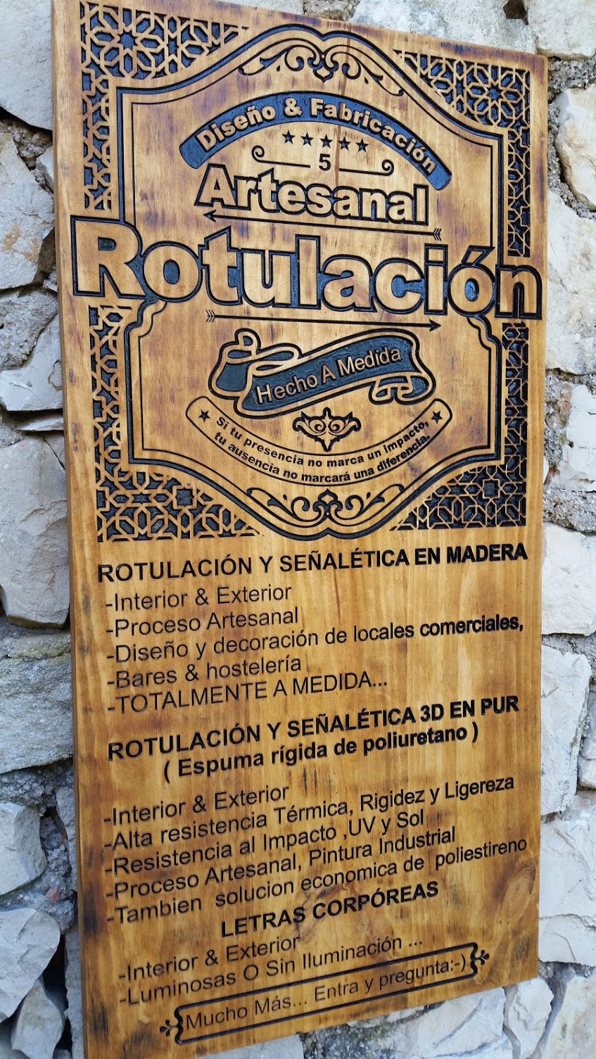

    What type of paint would you recommend for painting pine?
    Also where did you get that vbit cutter from? Really nice clean engraving
    Sent from my SM-N910F using Tapatalk
    I did it with acrylic at the time, but now i don't do it that way. I use acrylic only when client wants as cheap as possible and only for inside. Normally i do it with 2 component industrial polyurethane when for outside.
    I don't use that V bit anymore. Instead i use CMT 90 degree insert V bit. For 60 degree i use the pyramid 6mm bits from China, Aliexpress.
    project 1 , 2, Dust Shoe ...
