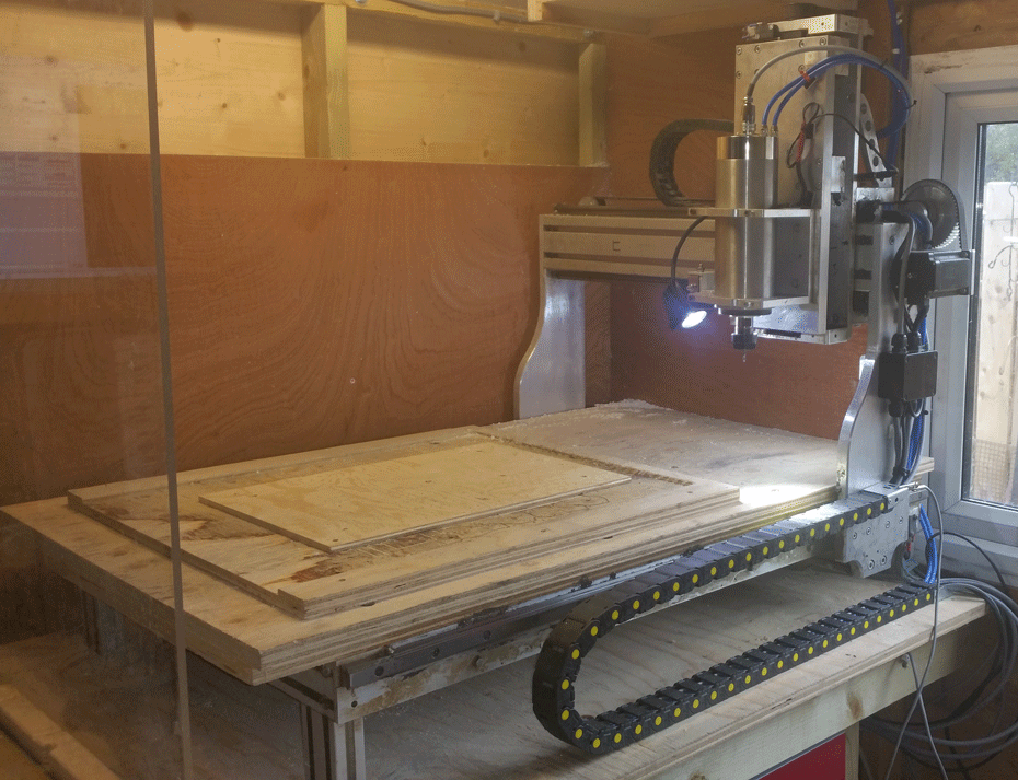

    so decided im going to go with extruded aluminium frame. This is a mates machine he built but he works all the time and lives a good bit away. He is willing to help me make parts and stuff so just need to read a bit more on motors and stuff the goint to built a machine 1meter by half meter wide.

    Don't believe a word the lieing Welsh scally tells you I built that for Ian many moons ago out of my scrap bits.!! . . . . And tell him it's been too bloody long since since we spoke. .. Lol
    PM me your email address and i'll show you a much updated version that will make Ian drool.!!.. . . Lol

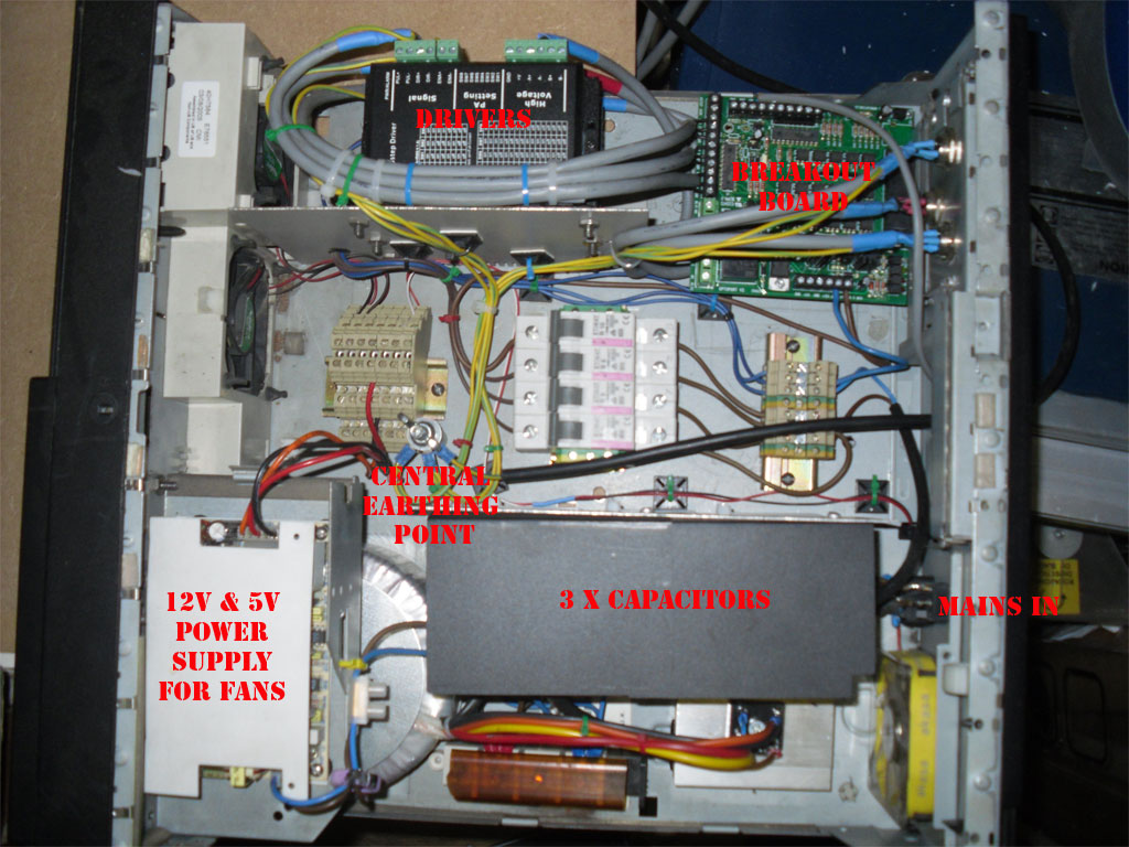

    Ask him and I think you'll find he is from Welsh stock. He came to England to visit family and Pick the machine up from me. I built all of it lock stock n barrel in Sunny Yorkshire, England.!!. . . . Ian built the control box and did the wiring.

    Yes Ian Bell trust me Buddy I built that machine all of it. . . . . Check this out.!!! (HemsworthLad is me.!!)
    http://www.cnczone.com/forums/cnc-wo...ee-beasty.html
    I even have the offcut from the Gantry extrusion still kicking around.!
    The X & Y are belt driven with long axis belts being under the bed with 2 belts running down each side with pulleys on bars at each end. There's a single motor connecting to one of the rods thru a reduction system with I think 6:1 ratio.
    I orginally built it with a 3:1 reduction but it was too fast so decided to increase resolution, as you'll see if you look at the aluminium pulley on the Y axis and compare with pics on cnczone which is steel.! . . The little Bugger still goes like the clappers.
    This was the last belt drive machine I built. Now all machines use ballscrews from china as there's very little price difference.
    With just one belt so going slow.!!
