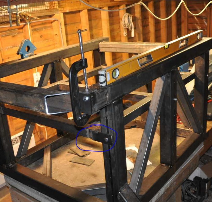

    The only weak spot that i see at first glance are the corner table connectors. I would additionally brace then in the other direction / L. And this is additive :-)

    Thanks for pointing out this weakness- do you mean something like this?

    Yes, exactly that's what i meant.
