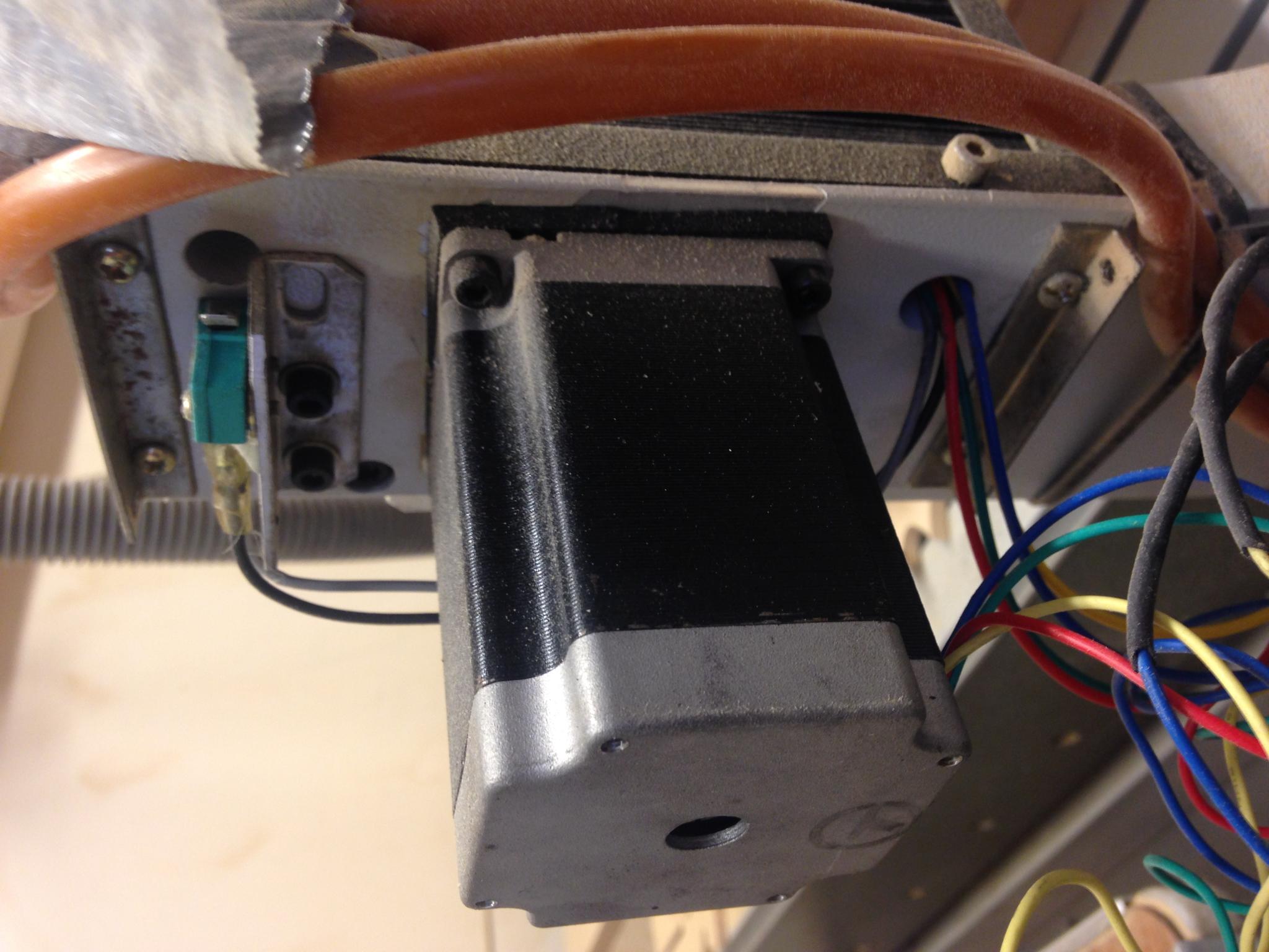

    Ok.... It's Chinese, works well, identical on all 3 axis.......
    Question is who's is it and what's a good make to do a complete swap with if it goes tits up ?
    Anyone any ideas?

    You need to find the following things:
    The A and V at which the motor is driven on that machine.
    So find the PSU and see what V and W for all motors. Then find the stepper drive and see at what A it drives the motor.
    Thats all.
    project 1 , 2, Dust Shoe ...
  3. The Following User Says Thank You to Boyan Silyavski For This Useful Post:
  4. Its a nema 23, looks to be about 70-80mm long so will be between 1.8 and 2Nm.
    Its 4 wire, so check the driver to see what the current is set to and then you will be quite close.
