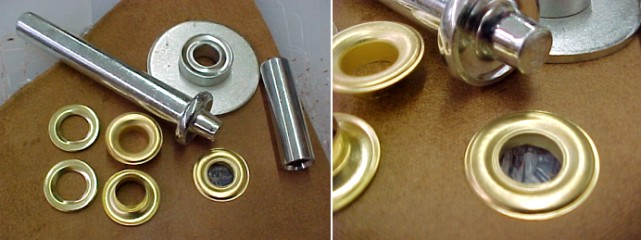

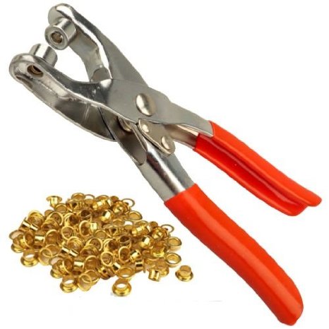

    Any leather eyelet pliers will do the job and if they don't reach, then refabricate something similar with longer reach from them . If it was me i would simply instant glue each side a washer. If the glue is good it would stick forever.
    Plus, nobody could convince me that the PCB eyelet which they sell for 10cents is not in fact leather eyelet.

    Thanks guys....great input. I can't solder brass nuts, because it a single sided board ....and the solder side is on the wrong side for the nut to go on :-(
    silyavski ...I'd forgot that I've actually got one of those tools lying around somehwre (probably in my loft), I'll dig it out & give it a go!
