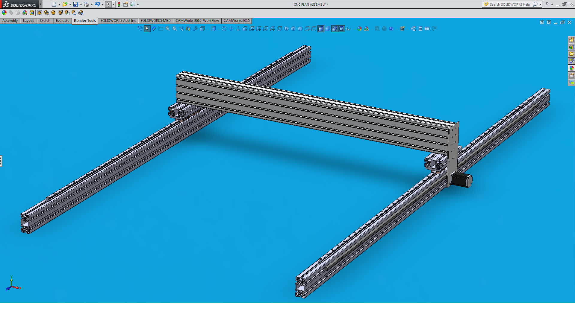

    I'm in progress to create a 8x4 router 3 axys . before few days i buy a NEMA 34 12 Nm from ebay + Motor Drivers :CW8060 (from auction )
    My next step is to buy a Breakout Board , but im a bit confused what exactly to pick up.
    Please can some one ADVICE me what type of Breakout Board (brand -model ) to buy for my firs mashine ( link to company or online shop to buy it-ebay,amazon ,china website )

    Hi
    You seem to be making the classical mistake of buying electrical components. have you built the frame and gantry ? what type of linear bearings and drive are you using.
    My advise is DON'T purchase any electrical gear, follow the procedure and start with designing the machine in sketchup or similar and offer it up to the forum so that the experienced members can point you in the right direction.
    Mike
    sometimes i think people are in such a rush that they never bother to read the forums. As Mike said its been discussed hundreds of times- read the builds, see what people are buying, make a drawing, show us the drawing, calculate weight and then...
    Thinking of buing 35euro board for a 8x4 machine is a big NO
    better start saving money cause you will need something like PMDX 126 board for LPT connection plus maybe Smooth stepper or CSMIO-M for Ethernet. At least i mean.

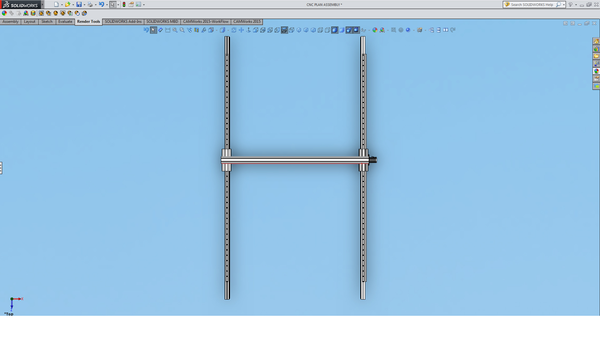

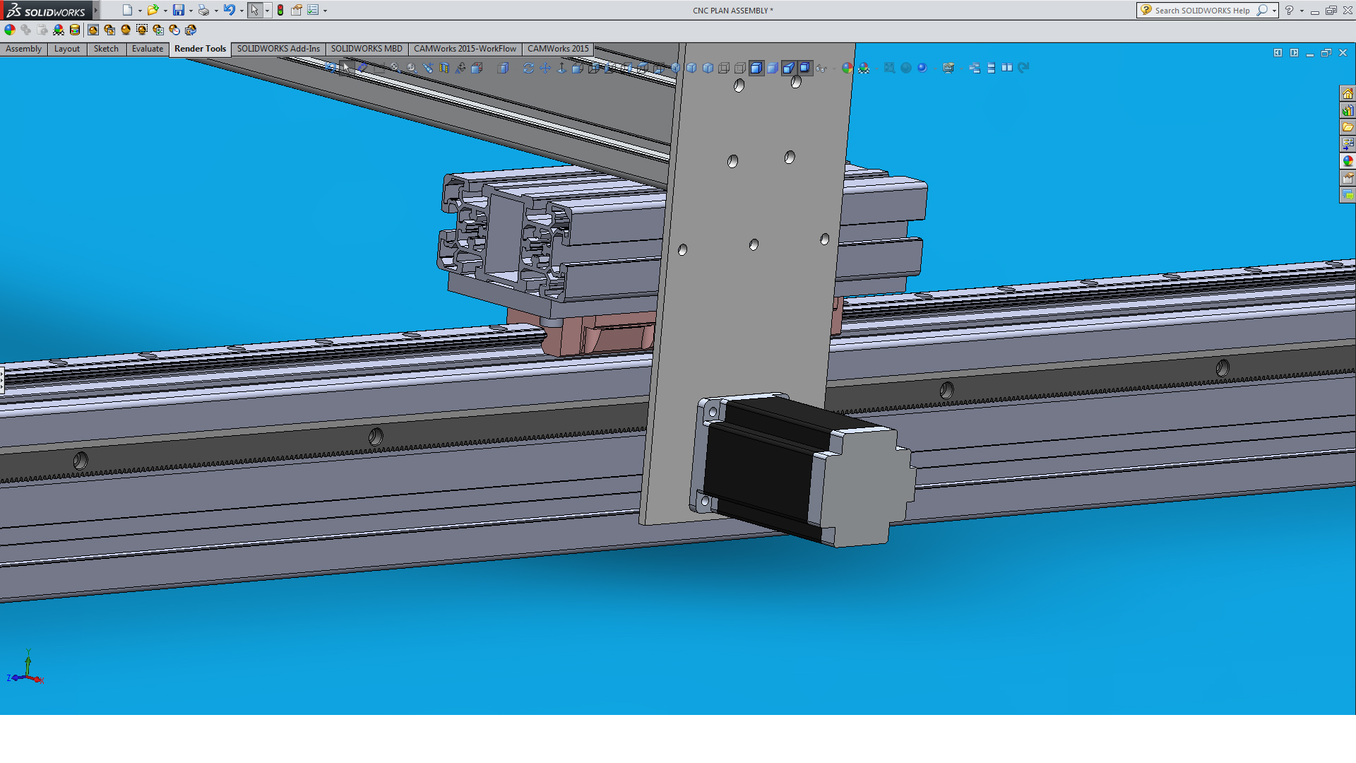

    Hello , guys .
    Thanks for fast replay and appreciate your concern.
    This is my plan for my 8 x 4 machine. i buy this nema 34 for one reason , the offer was super ok i mean the price , and i will not suffer if some of this item is not ok ....i try to make a test model and maybe after that i will upgrade...
    I ask for help only to buy Breakout Board and test this item which i buy from ebay ..
    I read super intensive a lot a forum and i know roughly what is a final idea to make a quality cnc machine.
    This is my first big one Cnc and i do not want to buy a first crap Breakout Board , i got already a few small cnc router 500mm-500mm with not so quality part .. but still work not so bad ..
