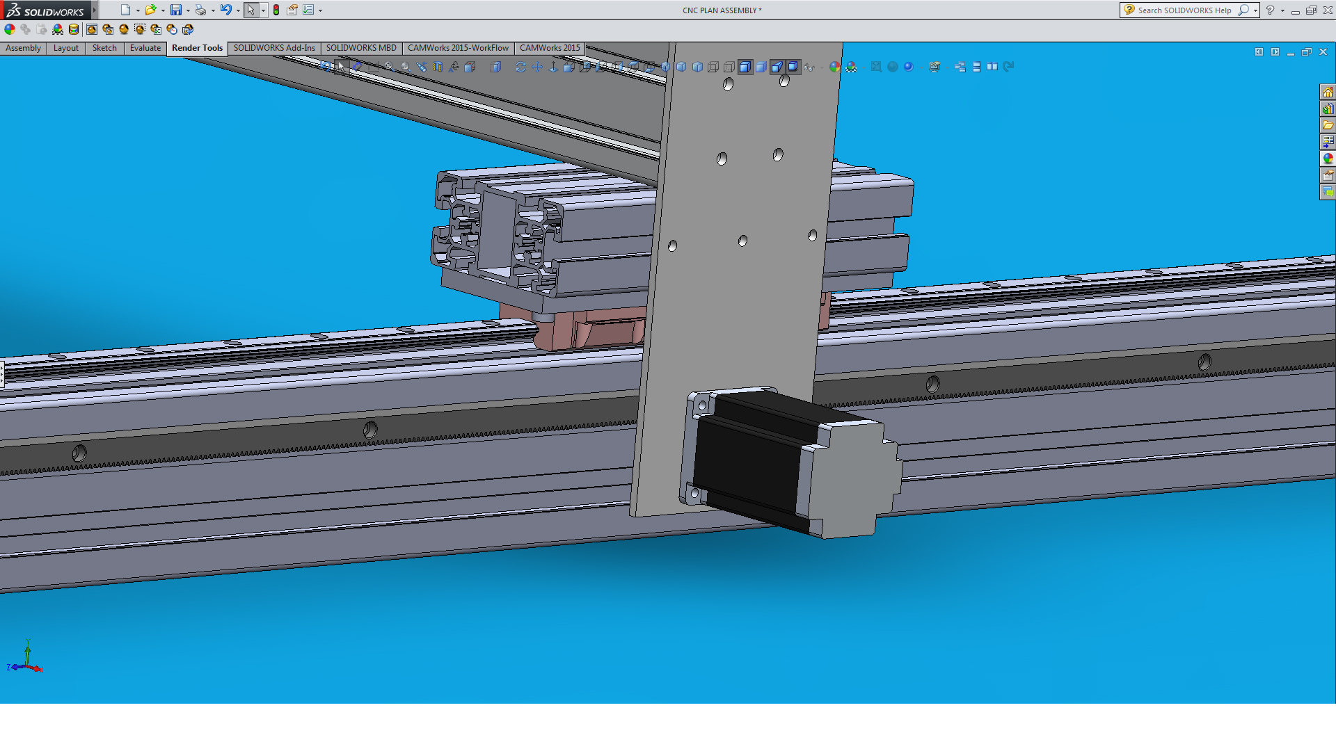

    Hello , guys .
    Thanks for fast replay and appreciate your concern.
    This is my plan for my 8 x 4 machine. i buy this nema 34 for one reason , the offer was super ok i mean the price , and i will not suffer if some of this item is not ok ....i try to make a test model and maybe after that i will upgrade...
    I ask for help only to buy Breakout Board and test this item which i buy from ebay ..
    I read super intensive a lot a forum and i know roughly what is a final idea to make a quality cnc machine.
    This is my first big one Cnc and i do not want to buy a first crap Breakout Board , i got already a few small cnc router 500mm-500mm with not so quality part .. but still work not so bad ..
    Originally I'm a cnc machinist - Fanuc - Homag -Multicam
