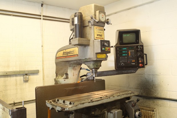

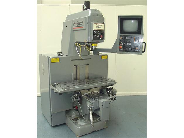

    Cleaner version of the same thing. Looks a decent sturdy machine.
    http://www.ebay.co.uk/itm/Bridgeport...01814587&rt=nc
    Not same thing at all. Same Manufacturer very differant animal. The first is much strong model IMO.
    Chances are both these models use Steppers not servo's. If they do use servos they most likely will be Brushed DC servos and use 0-10v with maybe custom drives so do some research before buying if paying big money.
    If controller is working then check out it's spec, memory etc and how it accepts G-code etc. If your planning on doing 3D work then often the controller is the weak link so paying for a machine with a working control is wasted money as you'll most likely rip it out.!!
    They have the same name and model from what I can tell. What is different between them? Trying to learn from what you are spotting as to what is important and what is not.

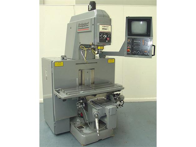

    The difference between th 2 bridgeports is the series. MK1 & Mk2 They look like this.
ID:	15349Click image for larger version.
