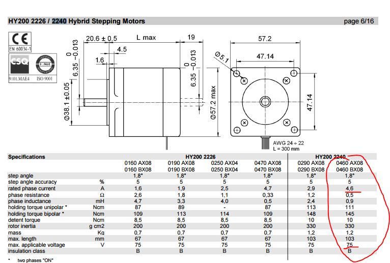

    All 3 motors have these numbers in common: 190\500ST-MTR
    X axis has more info....
    Y200-2240-0410 AY04. no idea if thats any clearer.
    At this point I havent got a picture of the spindle wiring - pos tomorrow.
    However it's probably a good idea to either get you over from Spain (!) or find a local engineer. Assuming an engineer will charge minimum £500 + controller £250 + software £150 I just wonder if its all going to get a bit near the cost of a motherboard from Boxford?!
    No such big deal as you think. from all it seems the original board is so expensive, as its separate stand alone motion control.
    Ok, at least for now we have the motors identified and know at what V/A could be driven,
    HYBRID STEPPING MOTORS HY / HS / HN Series
