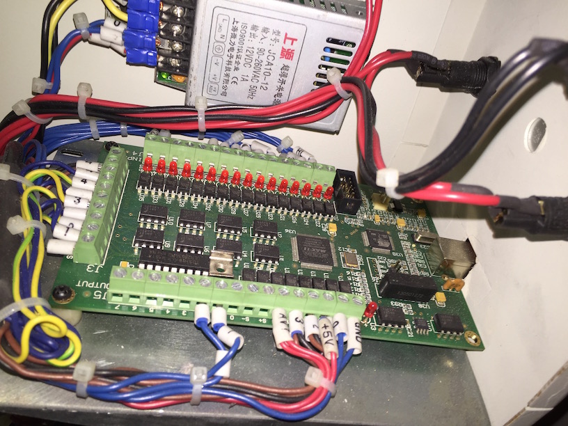

    Lol. Soooo... I was considering bridging out the estop on the control board. I ran a multimeter to check for continuity at the guard switch and at the estop... all seemed fine. Before I bridged the circuit I wanted to eliminate a few other things.
    On Wednesday I plugged in w/laptop and it wouldn't come out of estop, so I went to considerable effort to lug my f'in huge workstation style PC out to the shed to settle the possibility it could be the laptop. I also switched out the USB cable and on the recommendation of the smallcncsuport guy (John Stevenson... maybe its John S who kicks around these parts?) I added a 400ms debounce to the input signals in Mach. I also replaced the guard cover.
    It came out of estop straight away, and I was already to eat my own words regarding the laptop but sadly my happiness was short lived when the same thing happened on the PC... half way through-ish a small op the machine went into estop and wouldn't come out. It just about broke me and then I almost went nuclear. So I just packed up and went inside. Didn't get a chance to try the bridging thing.
    I was already to try this evening when I plugged in and once again all was fine... I thought I'd give it one more chance to make it all the way through a small part and it did. So I have my first part (ish...). Only then I went on to realise a much different problem... I wanted to do a little drilling on said small part and relaised that two of the MT2 ER16 collet chucks I have don't fit my machine! Wrong thread. Just can't win.
    I went back to have a look on eBay to check and the listing now says "These chucks are threaded for drawbar but unfortunately we cannot confirm the threading size or pitch because each batch might be different." I was well aware my machine has an M10 thread so I am dubious it said that when I bought them (it was back in the spring), but I guess I'll never know now.
    I'm still concerned the estop is a problem and worried about doing a bigger part. Only time will tell I guess.
    For anyone interested here is a shot of the internals of my machine showing the controller card:
    It appears to be this one: http://www.automationtechnologiesinc...breakout-board. Known as an AKZ250 or Xulifeng. Looks like an FPGA at the heart and some kind on Atmel SAM (i.e. ARM) based device for usb coms.

    If you have a Galil card then I'd swap it in a heart beat as Galil is industrial strength Controller and will knock the spots of that AKZ250. Yes I agree you shouldn't have too but sometimes it's just easier to bite the bullet and get cutting reliably. Esp if you have such a quality Card already.!
    The next best thing is sort the noise causing the issue. Debounce is a bodge to get you going. Removing the noise is the cure and easy enough done.
    For a start check all the Grounds are correct with a Star setup and separate signal wires from Power wires. Often this will cure the problem if it doesn't then you'll maybe after look at other ways. Like Caps across the inputs. Thou to be honest I've never found them to work very well if noise is bad.
    To test if it's noise thru the switch then just remove the E-stop and put a jumper across the inputs. If it does it again you'll know it's not the E-stop as it can't be noise on the e-stop line.
    Personally I prefer 24V to run trhu my E-stop and controlling a Relay which shuts the machine down. The 5v input signal is then just run thru Relay contacts to inform Mach3 E-stop occured and with a very short wire run you'll never get noise on that input.

    I'm not sure if it's just how you've explained it, but (ignoring the initial problem which we can probably attribute to the guard switch) there seems to be a pattern:
    The machine is running, but then gets itself jammed in e-stop, so you turn everything off, leave it for a bit, then when you come back, it's working again. If so, that sounds suspiciously like it could be an EMI (interference) problem.
    The prime suspect for EMI (as always) is the spindle drive board and spindle, so it's probably worth checking if you can reliably get through the motions of a job with the spindle off/driver board disconnected, but not with it running. That I can't see a shielded cable between the spindle driver and the breakout/motion controller does make me particularly suspicious.
    If disconnecting the spindle board doesn't fix things up, you'd move on to checking if it was the stepper motors and so forth. It's probably better just to link http://www.cnccookbook.com/CCCNCNoise.html at this point; although, some of it's recommendations are more practical for people making machines from scratch.
    BTW, I think your link suggests that your motion control board is powered from your PC, so if it does get in a huff, it's only going to get power cycled when the USB port loses power. There's a tendency for PCs and laptops to sleep, rather than switch off and they often leave their USB ports powered for your convenience during sleep so you can charge your 'phone. (This might explain why it seems to fix itself overnight, because you unplug everything when you give up.)

    I noticed you said "shed", what kind of setup would that be? If the "standard" shed is the scenario I'm wondering if there is a possibility of an intermittent damp/moisture/humidity thing going on?
    How close are those power lines (red&black, running cross the top of the picture) to the blue wires at the back of the picture, wondering if there is a noise issue in that area of the box, that PSU is right there to, humming away, sorry can't offer anything more :(.

    Cut those bloody tie raps off as well I hate to see unshielded wires bound together, esp if 5V signal wires.

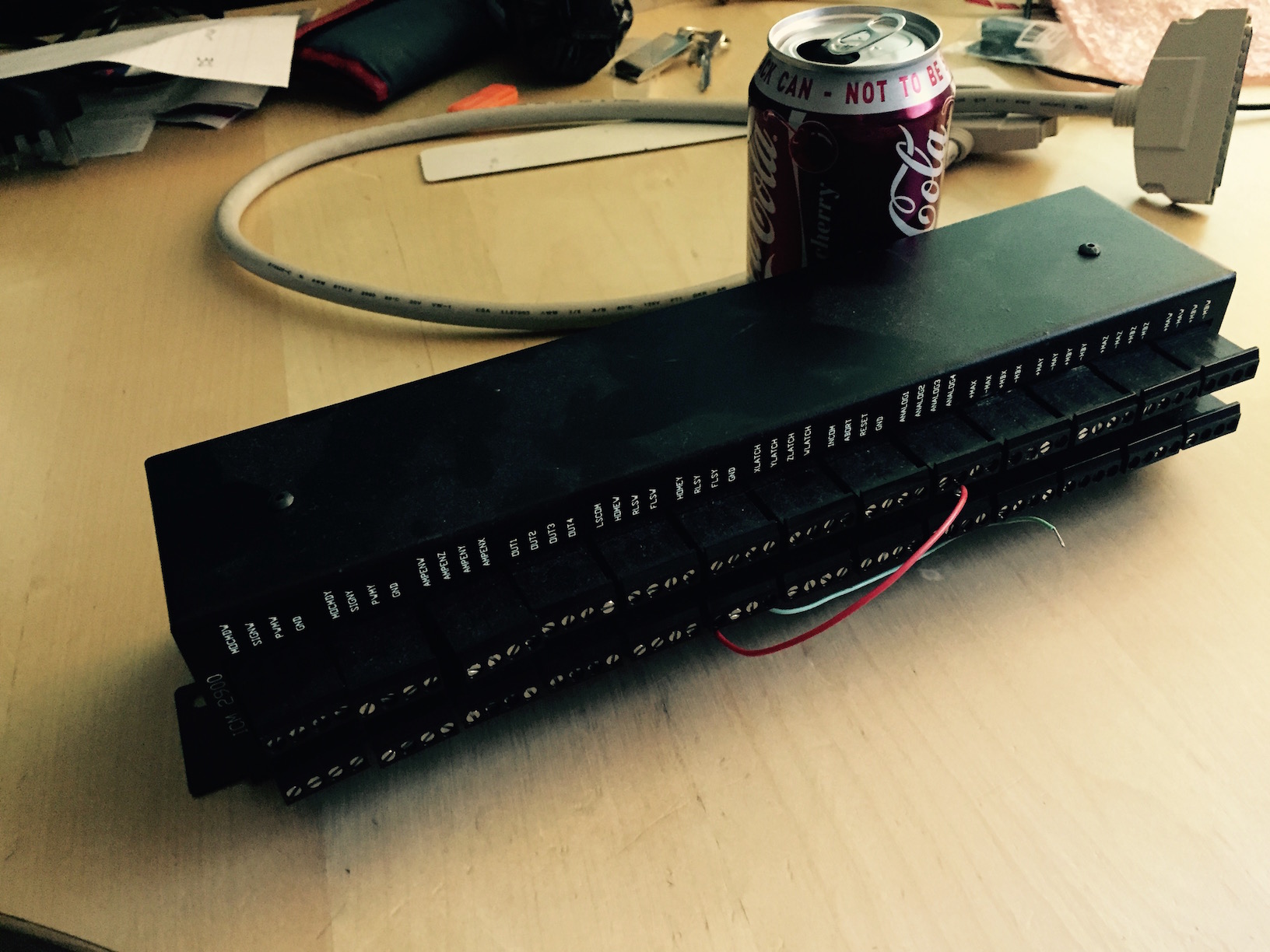

    JAZZ, Two things stop me with the Galil... first I really like the fact that, bar the laptop / pc, the mill is self contained and the Galil has a massive breakout box (see attached pic) that I'd have to clumsily fit on the side or something... and then I really would need a PC + monitor. And it would all have to camp out in the shed because a laptop I can handle moving every time but all that lot... no way. Rewiring wouldn't be easy. Over time I could definitely do it. Its just not something I can tackle right now... Got so many little projects I want to finish off. A few of which require parts to be made with the machine! Go back to work on the other side of the country soon...
    Jess, Noise from the spindle getting on the the estop line does seem to be one of the major suspects. Esp. when its cutting I can imagine the extra power going through the spindle creates a lot of noise. The estop and the spindle power are of course on separate cables but they run together from the head into guts of the machine. I could be wrong but I don't think either cable is shielded. But surely that would be a major design flaw... and they must have made thousands of these machines?!
